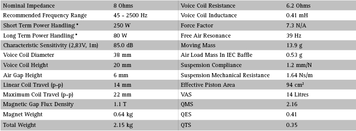

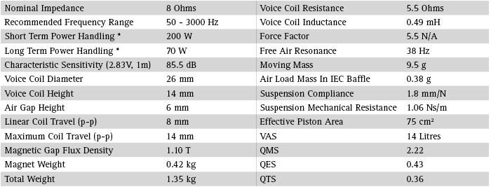

You know I have wondered about woofer size myself. For instance the Supercharged Song tower uses 5.5" woofers and the veracity ST tower uses 6" woofers. The frequency response is the same and the Fs is the same for both woofers. So why would one pay $1000 more for woofers that are a 1/2" larger if they perform the same and have the same bass? They have the same tweeters.
Swerd
Swerd
Those two mid-woofers (W15 in the SCST and W16 in the Veracity ST) may have the same lower limit to bass, but they don't perform exactly the same. The devil is in the details:
Seas W15CY 5.5" Magnesium woofer
Seas W16NX 6" Magnesium woofer
Some differences:
  • The W16 has a larger and more robust motor than the W15:
    It's voice coil diameter is 38 mm, vs 26 mm in the W15.
    The W16 magnet is bigger, 0.64 kg vs 0.42 kg in the W15.
  • The W16 voice coil, hence the cone, moves farther while maintaining a linear response:
    The W16's Linear voice coil travel is 14 mm (peak-to-peak),and the maximum travel is 22 mm.
    In the W15, those values are 8 mm and 14 mm.
  • The W16 handles higher power levels:
    Short term power handling: W16 250 Watts, W15 200 Watts.
    Long term power handling: W16 80 Watts, W15 70 Watts.
  • The W16 moves more air:
    Effective piston area is 94 cm² for the W16 and 75 cm² for the W15.
Other parameters that define the lower bass extension, Fs, VAS, and Qts are remarkably similar in those two drivers. But overall, the W16 handles more power and can be driven louder than the W15.
I'm glad you asked that question because it allows me to go into detail about why generalizing about woofer diameters can be misleading.

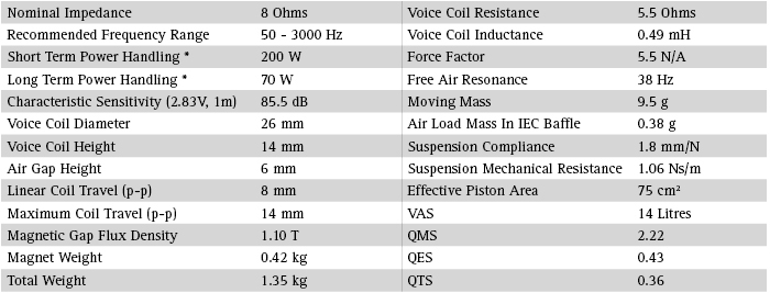

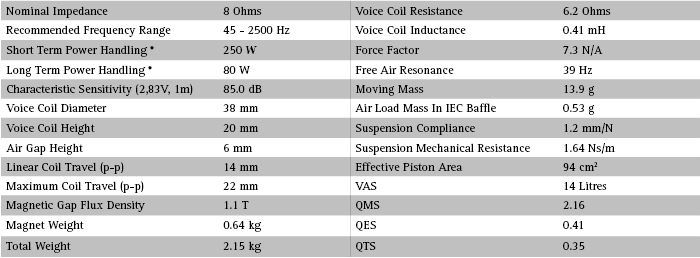

Some differences:
