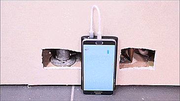

Sort of a sideways thing for this discussion but saw this thing today and wonder if anyone has used it....
http://odditymall.com/walabot-wall-sensor
It looks like a good stud/wire/pipe finder, but while it is a fun idea, I don't see much utility to the rodent detector. Unless you hear a critter in your wall, you are not going to maintain a vigil monitoring your walls. If you hear a critter, you don't need this to tell you he is there.
On second thought, you could use it to find an area clear of pipes and wires and lay in wait for him with a framing nail gun!:D
Yeah, when mice get in the house I usually am aware of it and by ear kinda know where they are in the walls. I found the exterior entry a while back and not an issue after I blocked it.
The $189 price for the finder is kinda steep, but like the detail....
