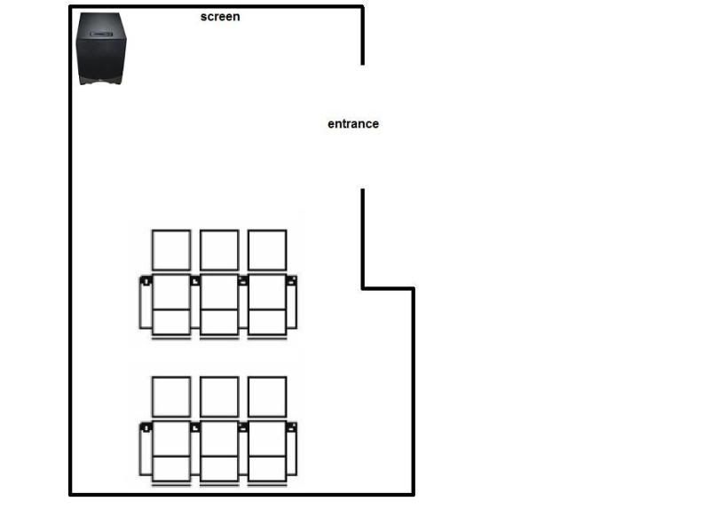

This forum is great with lots of helpful info. I was hoping someone can point me in the right direction and I am having a dedicated home theater built in my new house.
My plan is to eventually have 2 subs but I will only have one to begin with. My dilema is that all the wires will need to be ran prior to setup since all wires will be in wall and terminated at wall plates. So I will need to have a good idea of where both subs will be at before listening to them to figure out the best location. I hope this makes sense.
My initial plan was to have both subs at the back of the room.
This is the layout of the room (15x17) and this is where I would place the 1st sub.

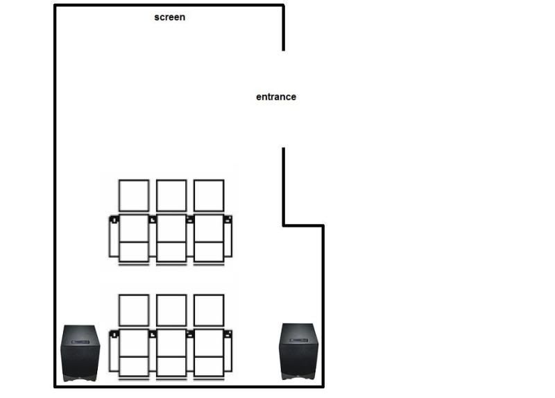

Then add an additional sub here.
But after some research, I am confused as to where the subs should go.

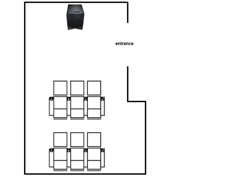

Would option 2 be better

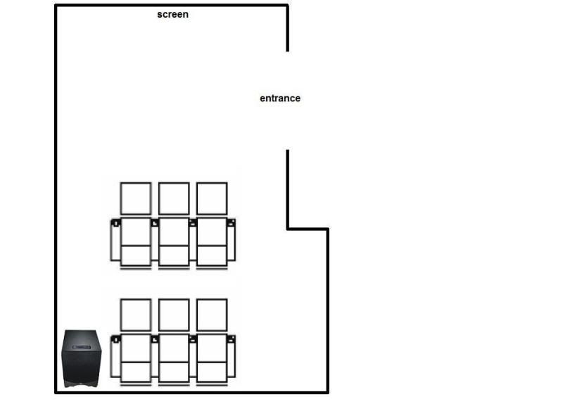

Or maybe option 3.
If option 2 or 3 is better where do I need to add the additional sub when I get it down the road.
Thanks in advance for your help

You need to put a door between that opening so the room is sealed I often have my small door open and when closing it makes a few +db in level difference.
Your room is only a few feet larger than my room but has the odd walls on one side or rather chimney breast in the middle and making one side of the wall helps.
In your case which is easier than my room the right rear side wall make a false wall a bit a timber fitted for a wooden frame and few sheets of plaster screwed up with inside of the cavity filled fiber glass or rockwool slaps so the cavity doesn't resonate. I'm doing more less same for front of the left wall in my room otherwise certain lows mostly left channel, reflects into the corner of the chimney breast and cancels out or reduces small portion of frequency. So I made a bit of false wall.
The other thing I'm thinking since your in USA and most US homes are made with timber and plasterboard is KNOCK OUT the right walls and widen the room and remake the walls with timber/plasterboard plasterboard is cheap stuff. Me I don't have that option as British homes often built with brick, I'd like to knock the chimney breast as it sticks out by 18".

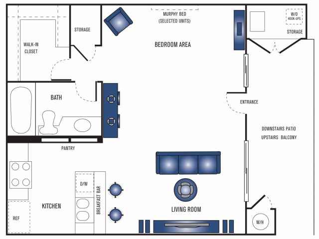

Here's my apartment, would I place a sub in the 'living room area' (thats where my A/V gear is) and the second sub in the 'bedroom area'? It's a 500 sq. ft. area which also includes the kitchen, bath, closets.
Subwoofer set up involves a lot of experimenting, because inches really do make an audible difference!
I would experiment with one up front and one behind, as well as corner loading each sub in the bed room area, as those appear to be the only useable corners.

Thank you for the ideas!. I failed to mention in the original post in the diagram, there's a makeshift partition extending from the entrance door to approx. 1/2 into the room to separate bedroom / living areas. using a laser measuring device the whole apartment is approx 4400 cubic feet in volume. however i did not measure individually each closed in space like bathroom, closets, etc, just took rough measurements from farthest wall to wall to ceiling.
