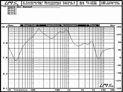

I have wanted a good pre/pro for a long time so I could power up my very difficult to drive speakers properly. The speakers present two impedance dips of 0.9-1 ohm at ~7kHz and again at a more difficult area of 0.8 ohm at ~32Hz. I have opted for a Yamaha CX-A5200 as my pre/pro of choice. I struggled to find the right amp that made sense for me. I landed on Parasound JC1's to take on the task. I would like to power the rest of the system with something that will match the linearity of the Parasound's. Short list is A51 Parasound, Emotiva, ATI or Anthem. I would consider the Monolith if I knew more about them. They seem hard to find good data on. I do not oppose other suitable but price is a concern. I would rather have more channels than needed for future upgradability.

Are you saying your speakers dip down below 1 ohm at 32 Hz and 7 kHz? Because, if so, what you need is better speakers, not beefier amps. A speaker with an electrical load like that is just terribly designed. I can't believe anyone in good conscience would sell something like that. If you are really stuck on this speakers, the amps I would look to drive something like that are pro-audio beasts like the upper end amps from QSC, Crown, or SpeakerPower. But if you want something that doesn't look industrial, you will need to save your pennies for a Burmester 909 ($75k).

Thank you for reply. I have owned since new (over 30 years) and designed by a great designer, Arnie Nudell, with this as a known flaw. The speakers have a switch to add resistance to the circuit to mitigate the concern. I listen with the switch engaged but have listened to try with switch in the "extended" mode. They sound spectacular when set in this mode. I would love to hear them play to their full potential. With switch in the extended mode, everything has just shut down. I am happy that the protection circuits perform this function but I have amps that I believe will drive this load but am now looking for additional channels for the rest of system as mentioned in first post.

Posted below is what I believe to be an accurate chart of impedance characteristics. They are a challenge and were awarded the nickname of amp-killers. I know that the Anthem line can supposedly drive a near short and that was on my shortlist. I settled on the JC1's. I suspect that they will perform well. I have not tried them yet.

Must have been one of the old Infinity speakers. Cool designs, but ridiculous electrical loads.

The switch you see on the right is a set of resistors in the circuit to mitigate dips in response curve. This was on the Kappa 9(a), which was the last year of this speaker. When engaged, nearly any amp can drive. The downside is sonic purity must be compromised. I have listened with switch set to extended which is where the low impedance values come into play. I have an R-V2700 which was the last year prior to cheapening the power supplies. I have just purchased a CX-A5200. I ran an outboard Adcom to drive this speaker but when using Yamaha gear which is set to around 1 volt of output and the amp wants to see 2-3 volt as the 565 does, it does not work well at all.

The A51 or even the A52 (depend on distance and spl required) can handle the other speakers but not the amp killers. The JC1 should do okay as long as you are careful. It is hard to say how much spl you can get from those and how much current you can feed them, without knowing their sensitivity, your seating distance, spl required and the killer's power handling limit.

Another error in the original literature was the sensitivity was listed at 102 db which is clearly wrong but some have suggested that they are at a more normal 88-89 db sensitivity. The seated position is 15 feet from speakers. The rated power handling is 60-340 rms.

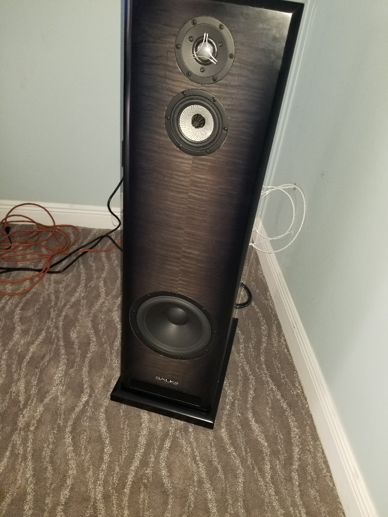

Not sure what your budget would be, but Salk Sound would be on my list (I'm an owner, but no bias lol). They have a few full range options from 6k to 10k with any finish option you can imagine.
This is the one I have
http://www.salksound.com/model.php?model=Song3+Encore
I have to agree. I love that they utilize SB Acoustics beryllium domes. These have some of the best sound characteristics I have ever seen. In fact the whole Satori line looks awesome. This would have to be one to have on the short list. Since I have all speakers with ribbons I am also drawn to the Salk with RAAL ribbons which may closely match my Ascend Acoustics Horizon center with RAAL 70-20. Yes, this sends me down a bad path. I may have to hate you for enticing me with these. I have spoken with Jim once in the recent past on these and yeah, he seems so real to deal with. It is tough to decide between the beryllium domes and RAAL ribbons. As I am looking to have great sound with very solid output, I am looking at the higher sensitivity units. The SS8's draw me in like a moth to a flame. Really like the passive use to assist the output of 8's while not having a boomy sound and port issues. How are he mids? I'll bet they are fantastic. Nevermind, I know the answer. Everything about this speaker is righteous.
