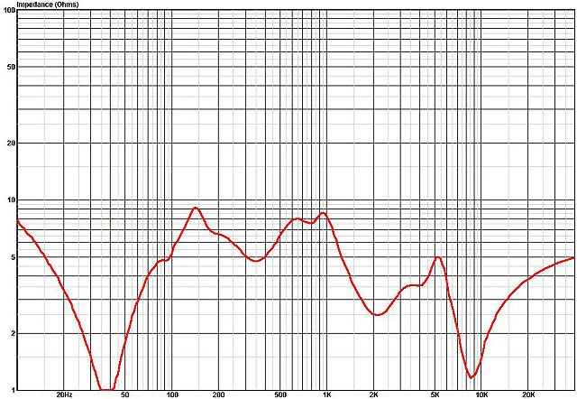

Going by the impedance graph, if you are going to keep those amp killer speakers, a more affordable way to do it instead of spending thousands on the JC1 that may barely adequate, is to get a good subwoofer and set the crossover to 80 Hz. Then you can simply drive the speakers with a proamp such as the following:

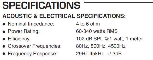

Another error in the original literature was the sensitivity was listed at 102 db which is clearly wrong but some have suggested that they are at a more normal 88-89 db sensitivity. The seated position is 15 feet from speakers. The rated power handling is 60-340 rms.
Thank you for the feedback, now this is getting interesting when you mentioned "Another error.....".
If it is the RS9 Kappa:
Then according to the spec sheet:
If the information is accurate then the speaker should not be too hard to drive, but obviously can still be an amp killer if you pair them with an average 200/300 W 8/4 ohm amp especially if it has poor phase angle vs frequency response, that we cannot comment without seeing the graph.

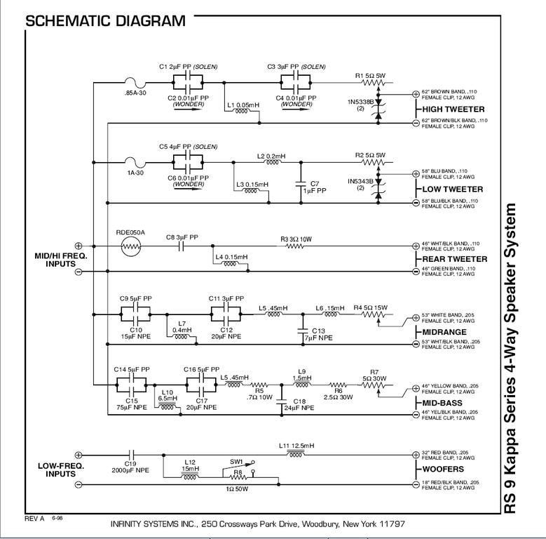

Also, if the schematic diagram (found online) of the crossover is accurate, then the impedance graph you posted is showing something quite different. For example, the calculated impedance should be at least 2.6 to 4 ohms, not 0.8 ohms as shown by the graph. Would you mind sharing the source of that impedance graph?
The other error is in response to someone mentioning that this was a terrible design speaker. If it is an error to design with this low of an impedance it is also wrong to have misguided SPL specs. 4-6 ohm is nominal as all speakers are generally rated in nominal impedance. The dips and the dynamics from music are what drive tremendous current demands and can kill amps. These were the last year of build and on such, a switch was installed to mitigate the impedance dip at the expense of sonic purity. I am thankful that the switch exists as it has allowed me to enjoy speakers for years. The graph was one I had found years ago when investigating the speakers. I have found others which are quite similar. I chose this as it shows complete resistance dips. The other more commonly found graph shows a clipped response and slightly different area of frequency response as to where the dip happens. I have mentioned the switch on several posts so I will share the schematic for those interested. This shows the variable crossover for the fine tuning at all crossover points as well as the 1 ohm 50watt resistor. I feel it was a great design for 30 years ago. I have toyed with variable setpoints but felt it unnecessary to alter greatly from nominal factory set. It has he look and function of Genesis audio speaker, as it should since both companies were founded by the same individual.
That's the schematic diagram I referred to. You can clearing see that the minimum impedance of the LF input is determined by the 2000 uF capacitor. That's why I said the impedance would be 2.6 to 4 ohms, because even if you ignore the impedance of the inductors and resistors, that series capacitor C19 at 30/32 ohm will give you more than 2.6 ohms. You can calculate it yourself using the linked calculator if you don't know the formula. (https://www.allaboutcircuits.com/tools/capacitor-impedance-calculator/)
Given the information in the schematic, It is impossible for the speaker to dip to 0.8 ohm at any frequency if the crossover is included in the measurements. Please note that at the very low frequencies, the impedance of the mid/high freq branches are very high so at such frequencies the impedance of the LF inputs are practically the overall impedance of the speaker, and again, will be at least 2.6-2.7 ohms even if you ignore the impedance of the inductor/resistor branch and the voice coil. That actually happens to be consistent with the specified nominal impedance of 4-6 ohm. There are various claim of what nominal impedance is, one being (ref source: wiki) 1.15 X the minimum impedance.
So one of the following may be the reason(S) for the seemingly contradictory information:
- The schematic diagram is not accurate, or
- Whoever made the measurements and plotted that graph did not do it right or it not accurately, or
- The measurement was done with the crossover bypassed, or
- The speaker was modified, or
- Any combinations of the above.

… and the 1 ohm series switch is engaged. If bypassed, it shuts down quickly.
I did the calculations for with and without the 1 ohm resistor, results are as follow.
Resistor in circuit:
Total impedance = 4.108 ohms
Resistor bypassed, i.e. switch closed:
Total impedance = 3.935 ohms
That's based on 30 Hz, as frequency increases, the impedance of the series cap would decrease, but the equivalent 12.5 mH and voice coil series and parallel with the 15 mH impedance would increase so at some point, say above 100 Hz, the overall impedance of the LF section will be dominated by the inductance series/parallel circuit.
If it shuts down quickly with that 1 ohm resistor switched out, that means your Yamaha is operating pretty close it's limit for your application. All else remains equal, the JC1 should have no trouble without the resistor in the circuit. Please note that the resistor simply limits the current draw by the woofer so you lose some LF spl, there should be no effects on the mid and high drivers.

This is the kind of info I was hoping to find when joining this forum. I have enjoyed watching from a distance but it is time to take part. Thanks to Gene and staff for all of their solid reviews and detailed analysis of audio gear. It is the kind of nut and bolts information that most of us tech inspired folks are striving to achieve. The following is the other graph which shows a clipped region in low freq. and not as low of a dip in the higher region. I have to believe that two different tests from different sources with similar results validate the overall impedance characteristics. Slightly different but very close. Thank you for detailed response and consideration of post.
I think it came from the same source and someone just play with the scales and magnification. I would trust the first one you posted as that one at least look a little more complete and more professionally presented. The only issue is, not knowing why the low dip, that defies electrical circuit theory.
All true. I notice all benefits in the lower range with switch and is quite apparent by crossover as to why that is so. I think you meant to say with the resistor out of the circuit? As the resistor is in series to add load and reduce current demands.
Would you not consider using a subwoofer with XO set to 80 Hz? That would allow you to avoid the most serious dip between 20 and 80 Hz. In addition, you can bi-amp at the same time, so the mid/high section will be isolated from the influence of the big woofer. Again, if you do that, there are all kinds of amplifiers that can do a good job for you. I bet those speakers will sound significantly nicer that way.
Fair question. The crossover for the woofers are reportedly at 80Hz. So if I crossed at 80 then I would essentially be shutting off 4 12" drivers. At that point I should not have these speakers and just get bookshelves. With the new Yamaha pre/pro, I can adjust crossover between speakers. I do not remember what the lowest crossover point is but I could try that. I have currently bypassed the crossover function and just let it eat so to speak. I listen to songs like Boz Scaggs "Thanks to you" or Chris Jones "Long after you're gone" to get a sense of overall tonality. Love the sound with mains running full range. I feel like I would be neutering the speakers by utilizing a XO.
