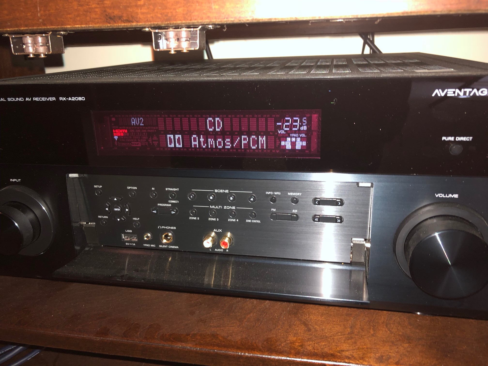

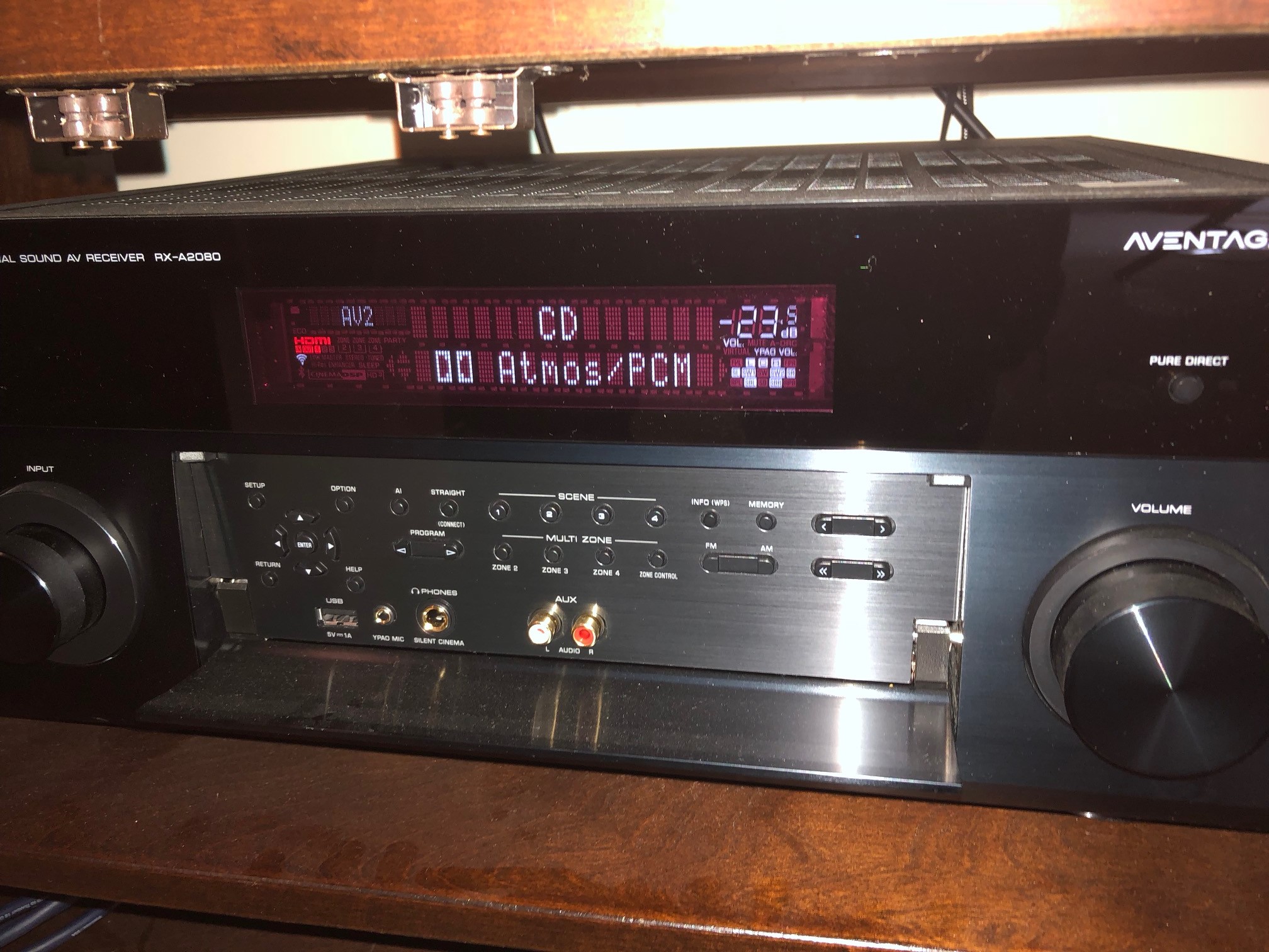

FYI, Streaming Netflix's Bright through AppleTV 4K, I was able to get an ATMOS signal (Picture included). It may seem trivial, but seeing that audio source was a milestone for me ;-) I reread Snake Eye's earlier post and realized he already said he gets Atmos on Netflix using AppleTV, I can confirm. Now I need to take some time to watch/listen/tweak settings, etc.
