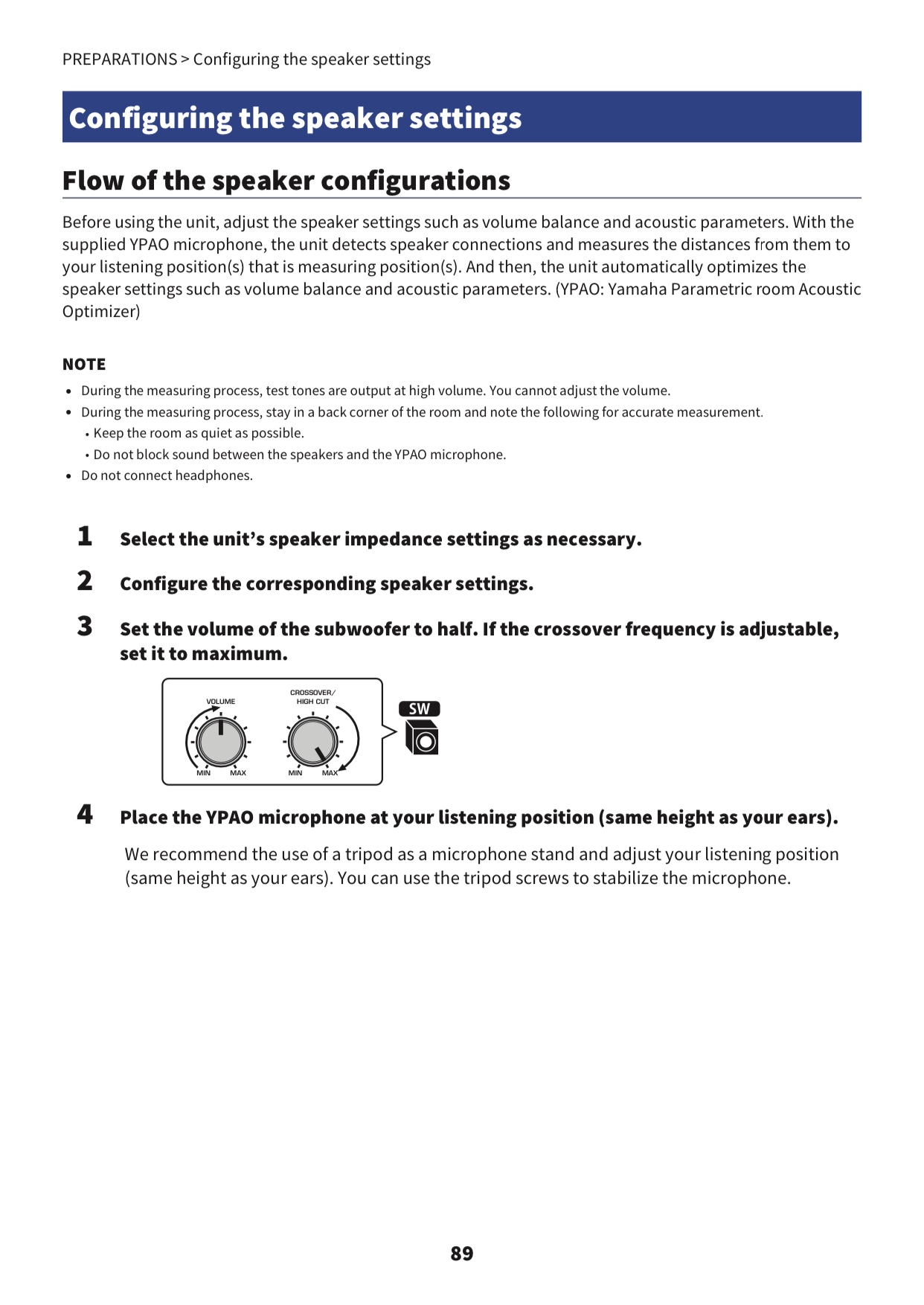

Both subs are active..thanks. Now my frustration is only one Sub shows in test tone and YAPO measurements. My other question would be should I leave the volume control on the subs themselves in the 12 O' clock position? Plus what does the Sub volume due as apposed to the Sub volume on the receiver itself?

The gain control on the sub at 12oclock is an often recommended starting point. What is the sub trim level set to in the avr currently? Generally easier to control and more accurately from the avr once it is setup (if you wanted to lower/raise the sub level later).
Yamaha usually recommends the volume knob on the subwoofer be set at 50% and the crossover knob set to max as the receiver will set the levels when running YPAO.

You'll want to at least set the volume high enough so that the test tones get heard from the microphone. Personally I find YPAO sets the level for the sub too low for my taste so I usually set the volume on the sub to results in a -7/-8 level adjustment after ypao and then I manually adjust the level back to 0.

Yeah, I've done similar teaks. Interesting that, without any idea of one's sub/subs, Yamaha recommends a 50% volume level before running YPAO. I never had a problem with it or other brand receivers hearing subs when set at about 30% volume. If I remember the last go around, the subs were at 50% and the levels came in at -10 before adjusting it. Settings change all too often 'round here as I can't leave it alone. :p

50% is just a general rule of thumb to start. It's not necessarily universal and different subs will have different gain structures. I'm not sure about YPAO, but Audyssey will prompt me to adjust the gains on the backs of my subs to fall within a certain volume range during setup. I make it a little hot, but still within the "green zone". After that I don't touch the gain knob on the subs again and do any level adjustments in the avr menu.
Right now my trims are set at -7.5 and -8 and I only bump +2 dB from there. @Tailspin70 are you saying you bump your sub trim by 7 or 8 dB after running correction? That seems like a lot, but then again I'm unfamiliar with YPAO.
