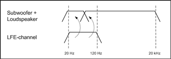

The problem is even if the specs are right, and it can play down to 40hz, it will still play lower. Every speaker has a response slope. That means it doesn’t just stop at 40, it will have the ability to keep playing lower frequencies, but at increasingly lower levels(is that an oxymoron? Hmmmm).
It looks kinda like this on paper.
