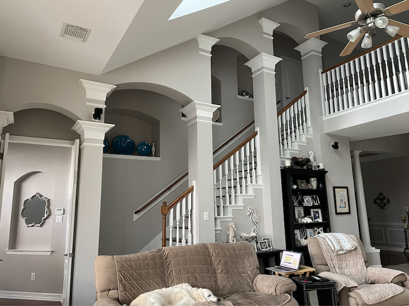

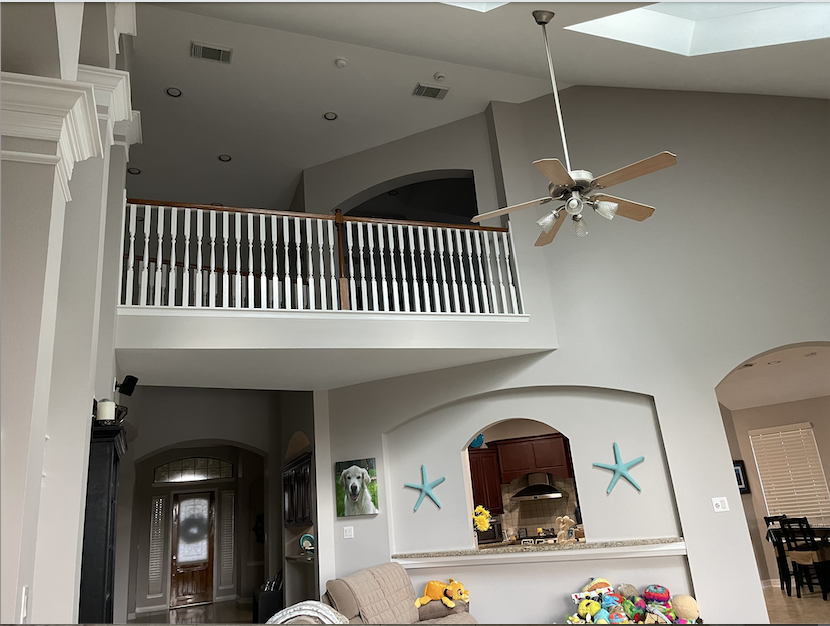

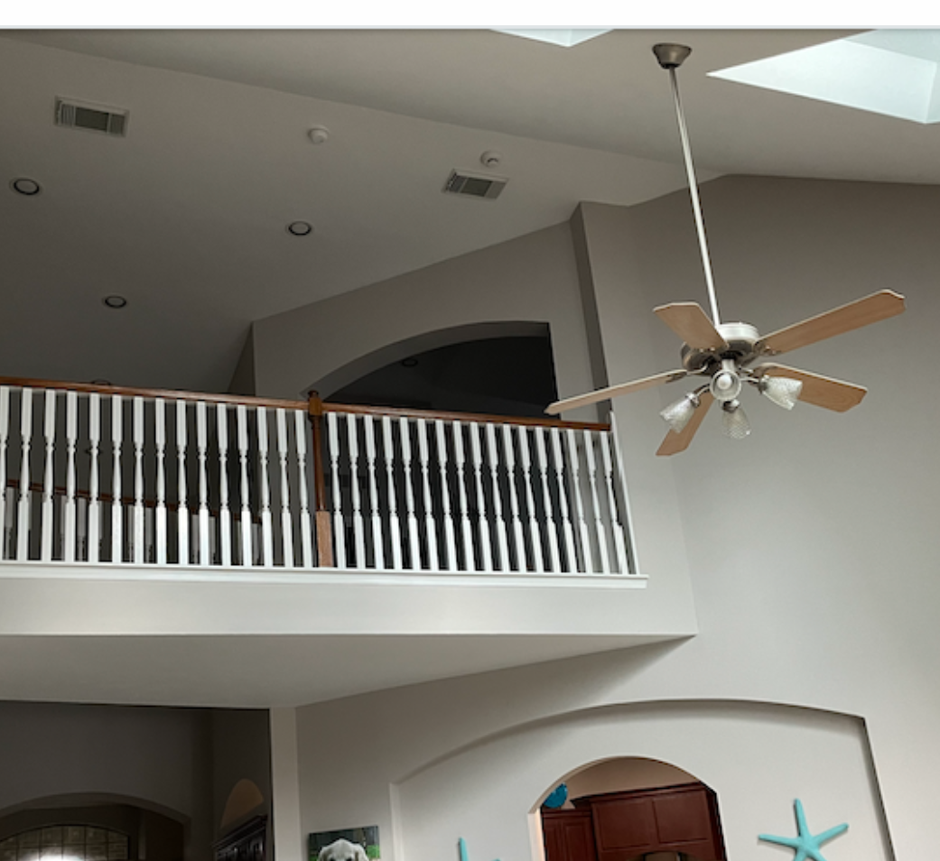

That is a gorgeous home and a beautiful room I love love the columns and the wrap around railing that goes up to the loft? And that room is absolutely MASSIVE for one sub or even 2 subs to try to fill. It's not just room size ots everything it's open too.
Okay okay this is going to be fun! I need like 40 min I'm going to look at the pictures and I have about 3 ideas I want to run by you and the fellas
I'll be back soon!

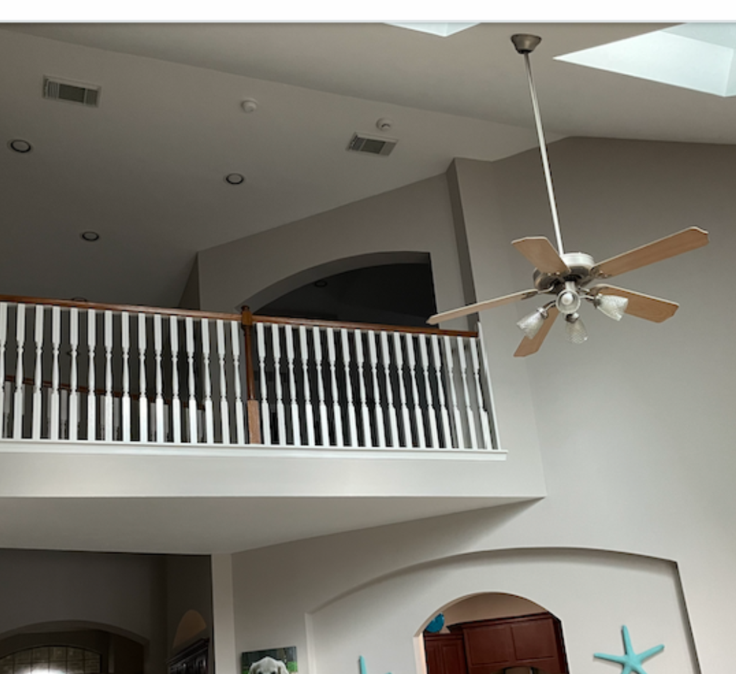

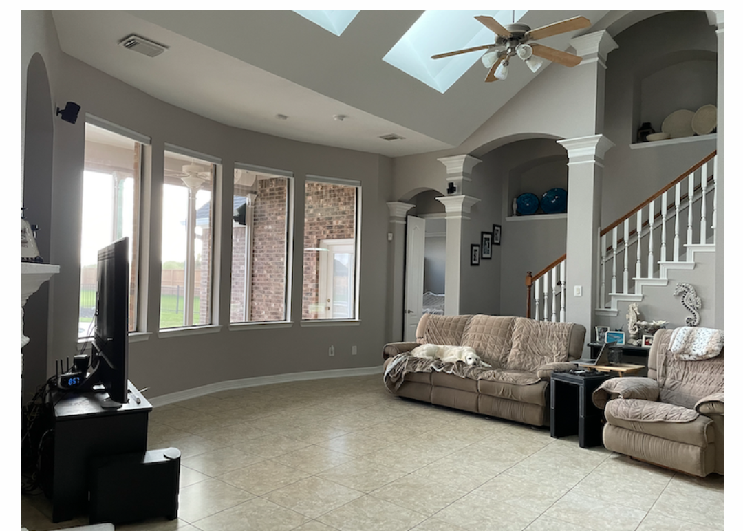

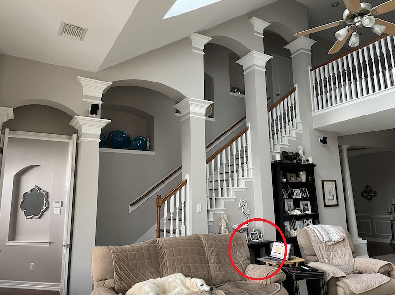

Use near-field placement to take out room size as a factor. Why not replace that table behind your listening position with a sub? I have outlined it with a red circle:
Replace that table with a nice looking sub. Look at the Outlaw Audio Ultra-X12 or the Arendal 1723 1V. You can put a tablecloth on them to keep the room looking nice. Use a wireless sub signal transmitter to avoid wires altogether. If you really want to go nuts, replace that little table between the sofa and the armchair with this sub. Both seats get blasted with high quality bass, and you have unlimited headroom since the sub is so close to you. The dual-opposed driver configuration negates cabinet vibration, so you can rest your drinks on the sub without worrying about them vibrating off the top. It's the perfect end table subwoofer.
Damn Shady, what a great idea! As long as just covering those main seats is good enough that's a beautiful solution and doesn't intrude at all on the room. The bass in those seats would be fantastic too.

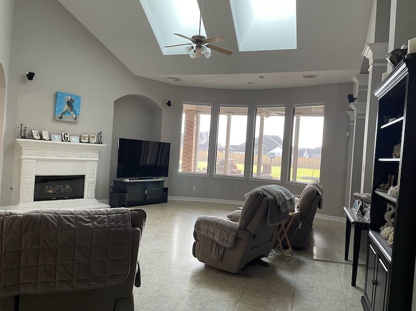

Where do you think you'd place one or two big subs? Looking at your current placement, you might want to mock up something the size of the pb-3000 (or 2000) with some cardboard....see where it "fits"
We can see how most home builders (and people in general) don't think like Audioholics when they design houses. :D
For subs, maybe get the RBH SI-12 or SI-1212 passive subs since they are only 9 inches deep and can be hidden behind the TV stand. :D
Yes I was going to say the same thing in a room like that going nearfield is a fantastic idea. Sorry OP I got busy at work but I'll be back on this thread after 11!
How would a projector cope with those skylights? Windows look like they may have shades....

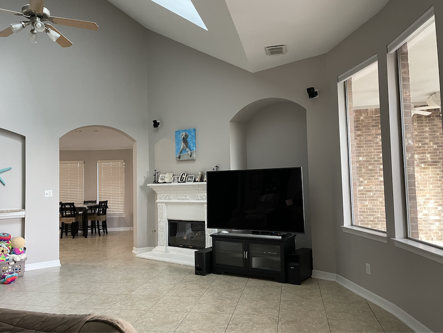

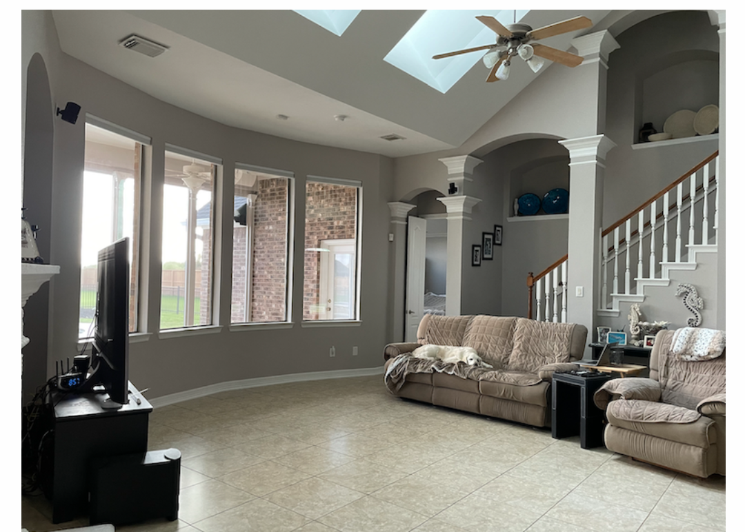

Yes, the fireplace is in the way. That is where I would have put one of the tower speakers. That is the front left. The back right is just as bad. I have the doorway to my bedroom, and right next to that the staircase. Then that is the table, about 1 foot of space and then the bookcase. Not conducive to tower speakers. :(
Okay option #1. Move the TV in front of the windows. That way you have room for 2 towers a center channel and those pre wired positions are perfect for surround and surround backs eventually tilted down I did that at an old house and it worked out great. With the surrounds up a little but angled to the listener
Option 2 go the fireplace side but mount the TV it doesn't have to be centered over the fireplace but centered along that wall. Above the mantle towards the right of the fireplace and then you could do 2 towers a center channel with 1 tower by the left side of the fireplace the other at the right corner or
Option 3 my fave one tower to the left corner by the fire place one tower by the right side of the fireplace for the center channel. And then one tower to the right corner. TV up centered on that wall like in option #2 all equipment goes in that alcove to the right of the fireplace
In all 3 options I think Shadys suggestion of nearfield placement for the subs is ideal. It's the best way to beat that room size without gigantic subs and nice looking ones as end tables or behind the seating can do very well
I had a huge living room like that in the old house and that's exactly how I beat the room size 2 SVS PB 4000 nearfield right behind my couches. It was friggin epic man.
I mean bookshelves in those spots just wouldn't give you much there not even in the right places. But if you did that would be option #4 but I wouldn't do polk S15 I'd go with Polk S20's minimum
But I'd go with the Monopricr Monolith Encore series before the polk the Monolith bookshelves would smash the polks and for less money too.
