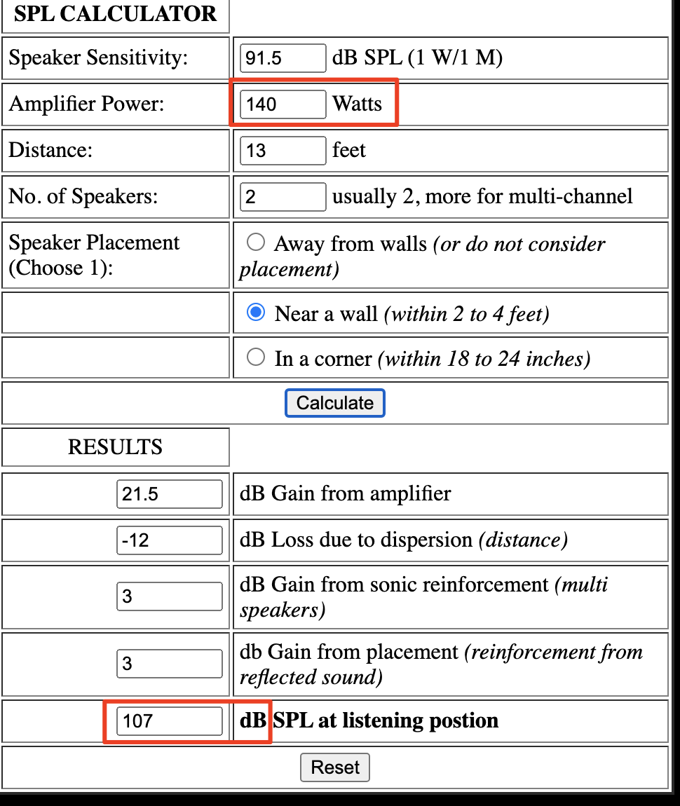

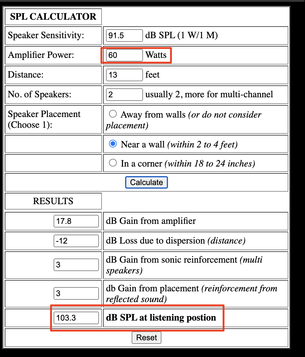

OK. I guessed I'd want max sustainable, distortion free SPL of 95db and 6db of headroom at listening position 13 ft away from speakers. Surprisingly, Peak SPL calc suggests 60wpc gets me above that:
Interestingly, more than doubling power 60 --> 140wpc increases SPL by < 4db:

That calculator is based on 8 Ohm nominal impedance. The 926 is 6 Ohm nominal, dip to 2.9 Ohm so I would consider them more like 4 Ohm nominal.
With one speaker, you would need 353 W for reference level, that is 105 dB, or about 112 W if the loudest spl you need is 5 dB below reference.
The H390 will give you 1.7 dB more, and lower distortions. I would say not enough to make a noticeable difference.
Even 5 dB below reference is probably too loud for most people.
It's a nice amp, but also a lot of money for not a lot of power.
