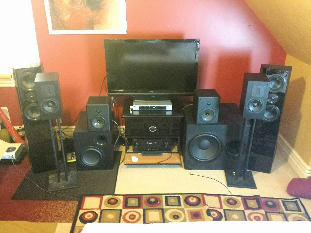

I tested both speakers in two different rooms to try and mitigate any negatives that might be room/positioning dependent.

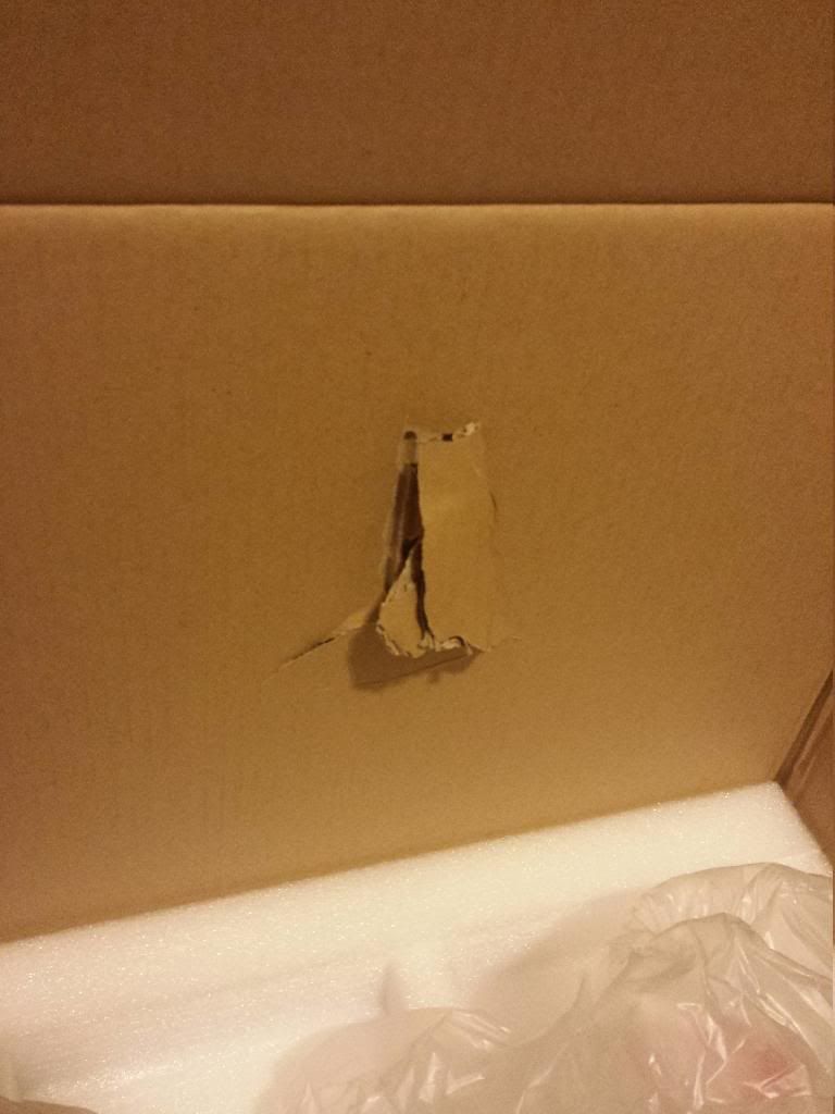

The A1bs narrowly escaped damage. It looks like something heavy with a pointy end was dropped on the box. This is a photo from the inside of the box. Luckily there was enough mechanical offset from the sides of the box, so the A1bs arrived without a scratch.
Unless otherwise stated, both speakers are being tested without room correction on pure direct and level matched.

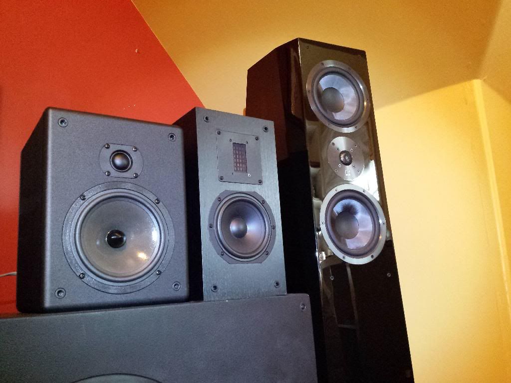

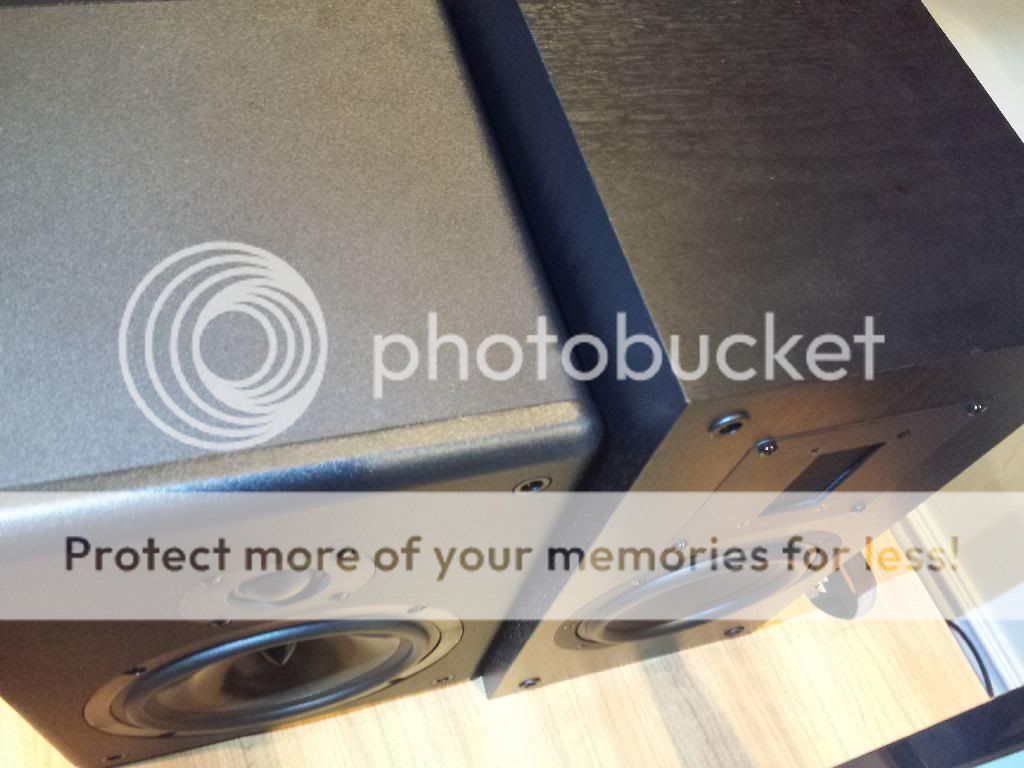

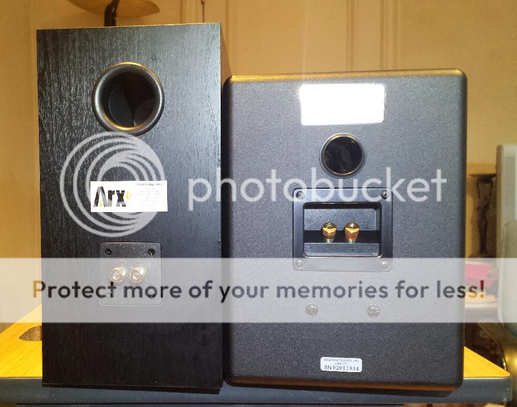

A1b's feel more sturdy, they weigh 3lbs more than the 170's. The cabinet on the A1b's is fair bit more inert. Both cabinets are constructed reasonably well, but it looks and feels like Arx took a little more care constructing theirs. I already mentioned I'm not a fan of the non-flush face and back plates on the CBM-170s, it looks sloppy in my opinion. The woofer on the A1b is held in with 6 screws vs the 4 found on the CBM-170. The economy finish on both of these speakers is acceptable given the cost saving standpoint. I slightly prefer the matte black finish on the CBM-170's, my brain associates black faux wood vinyl wrap with cheap. I didn't find any obvious flaws with either one and there were no obvious sonic differences that I could attribute to the cabinets, they both do their jobs well enough.
I didn't get the significant increase in bass with the A1b that I was hoping for. The XBL2 motor design in the A1b seems to only have a slightly higher output than the CBM-170. Granted, there is a significant driver size difference(170=6.5inch vs A1b=5.3 inches). I have no doubt that if the A1b had a 6.5 inch driver as well it would have a significantly higher output.
Note the uneven face-plate on the 170's
The A1b has a much larger and longer port than the CBM-170. The port on the CBM-170 is made of solid plastic and is not flared, The port on the A1b is made of plastic and cardboard and appears to be flared at both ends. I was pleased to find at the cardboard section of the port seemed very ridged, its not made like a toilet paper tube.
The A1b's grills are much nicer. They are made of a very thick MDF and are attached to the speaker via 4 ball joints. The CBM-170's grills are fairly flimsy, and are attached with plastic ball joints. From a sonic standpoint I'm not sure if these things matter at all. I don't ever use speaker grills anyways, so it really doesn't matter to me. However, if I did use speaker grills, I have no doubt the grills on the A1b's would outlast the ones on the CBM-170, for what its worth.
Aesthetically, I can see the A1b's having a higher WAF. That said, they are both medium-ish size stand-mount speakers, if your wife has a problem with them – its time for a new wife.
The A1b's are taller than the CBM-170s, in my application this is a good thing as I don't have to use something to raise the A1b's tweeter to ear level like I do the 170's.

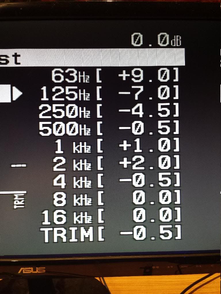

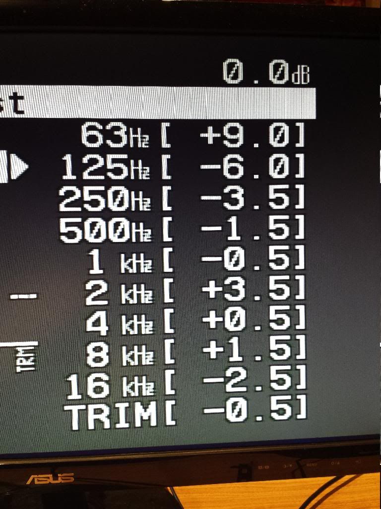

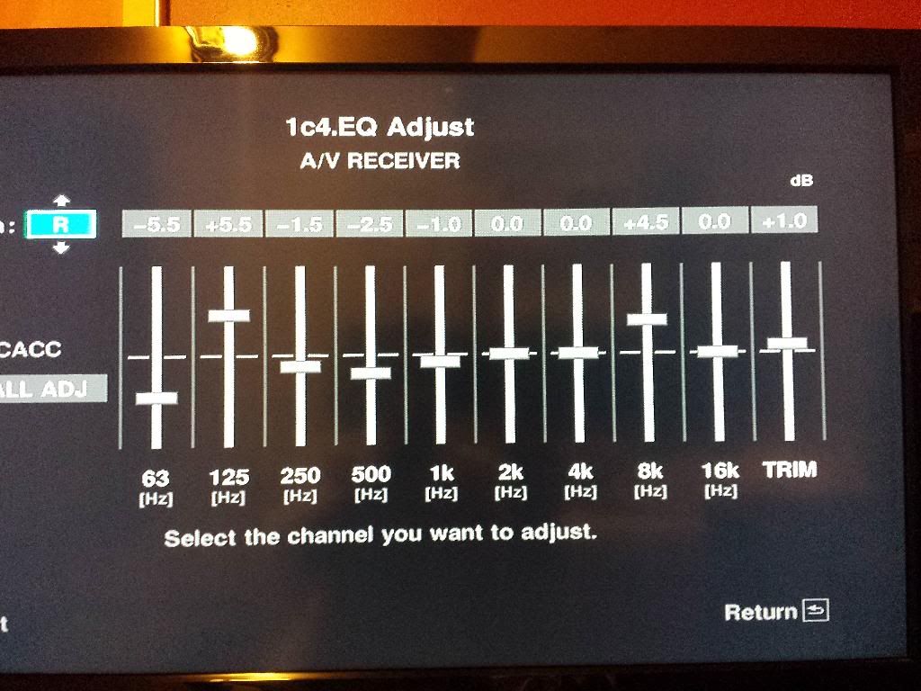

I decided run MCACC and see what in room frequency response of each of these speakers is like. Since I'm trying to be as thorough as possible, I ran MCACC in not one, but two different rooms. That way we can compare the graphs and if an anomaly shows up on one graph it can be compared to another to see if its just caused by the room or if it might be something else.
This is the correction table that MCACC applied to get each speaker to read flat in my computer room. Note, these first two are done in all channel adjust. I took pictures of what the right speaker in each case measured as.
CBM-170
A1b

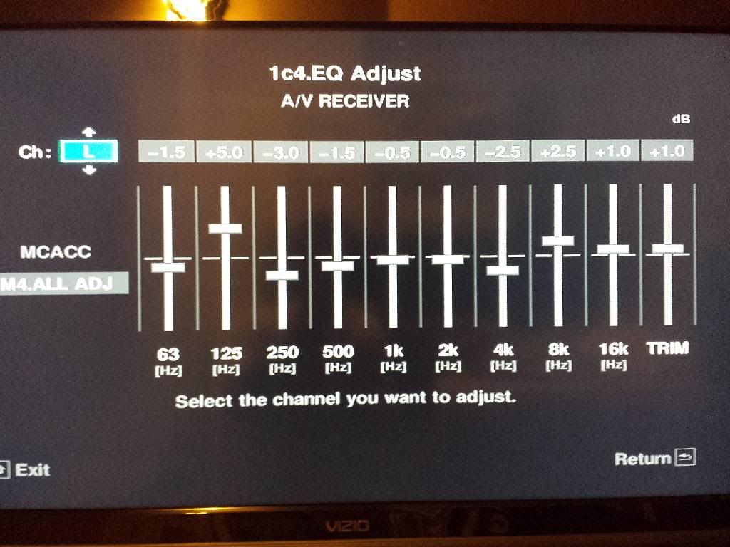

I then went ahead and ran MCACC again in my main listening room. Note the differences in the way data is displayed is due to the fact that I have a newer Pioneer receiver in this room.
CBM-170
A1b
