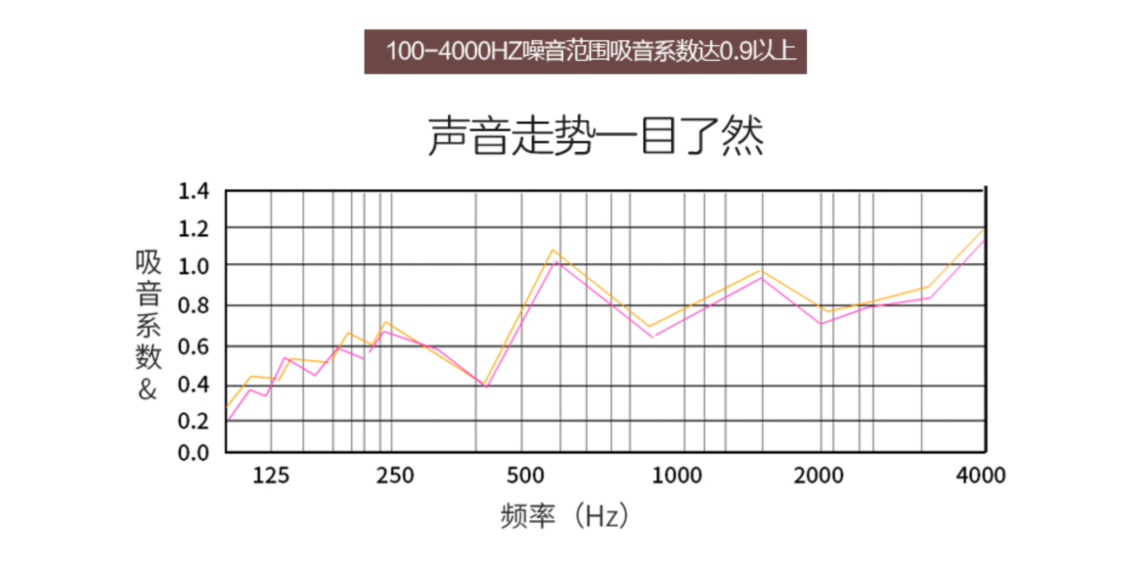

I got into the room and the sound paneling is not as dead as I thought. The sound paneling seems to mainly absorb higher frequencies (and I've attached an NRC chart for these panels that I managed to find online) - but there are other issues. I'm going to have to work with what is, because the structural layout of the room is beyond what I can change (obviously). I have attached a diagram of the room (and pictures to accompany so it makes more sense).

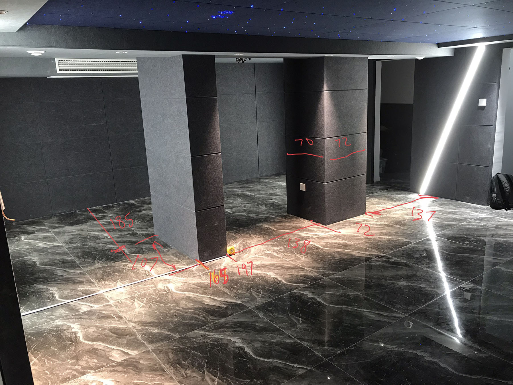

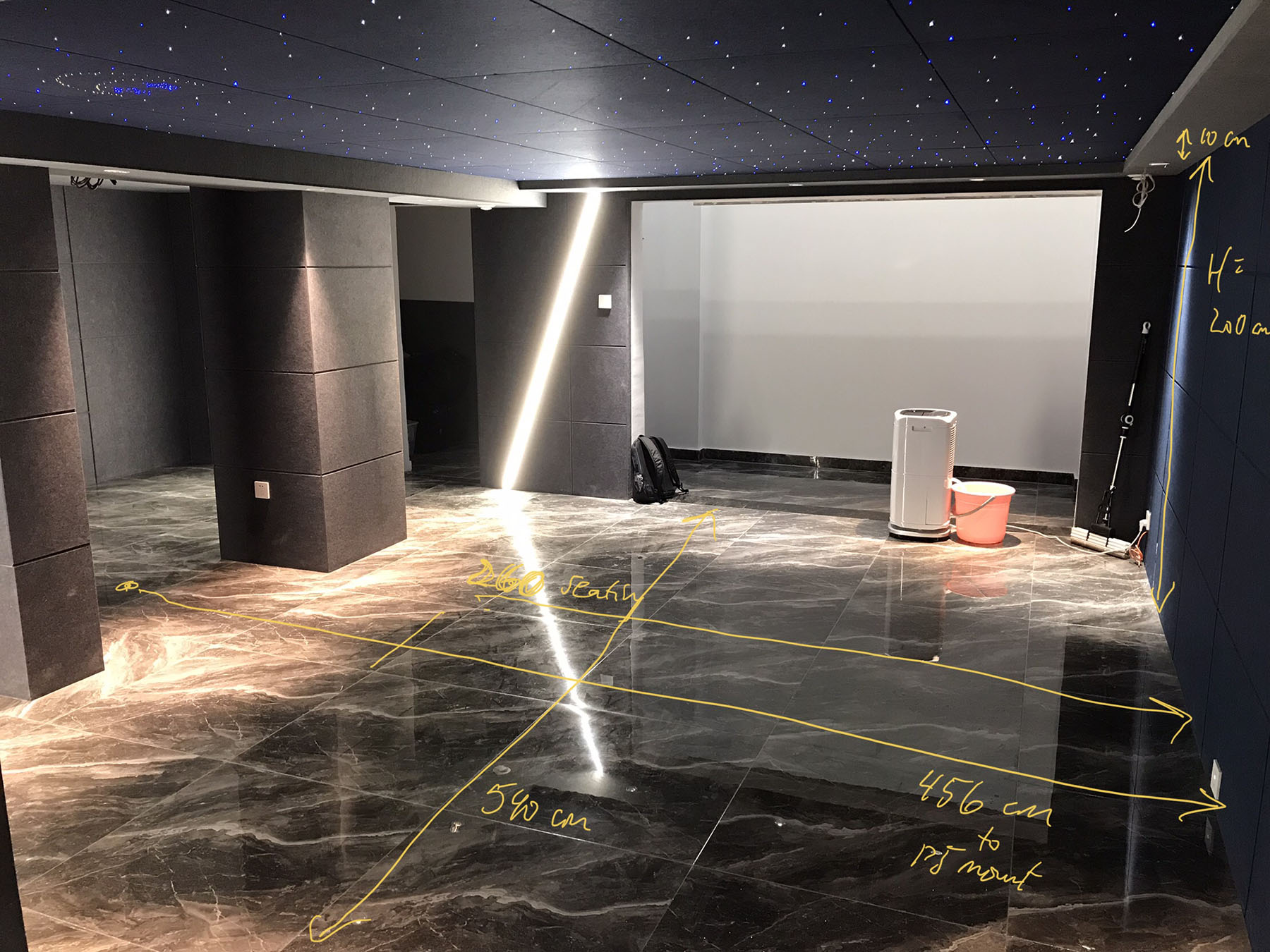

Center Channel Mounted on wall directly below the screen, about 60cm off the ground. FL and FR Mounted on the wall on either side of screen. Sub likely offset on front wall, but I'll play with placement once everything else is set-up to see what sounds best.
My main question/need for advice is: should I aim to mount the rear dipoles on the side walls (RL and RR Position A in Diagram), or hanging from the ceiling between the side walls and the couch/seating position (RL and RR Position B in Diagram)? I can wire within the walls/ceiling without much hassle for all the speakers. The ceiling is LOW - only 2 meters. But I can still mount them at about 150cm high in either location.
The damn columns (which are structural supports for the entire basement and obviously can't be moved, and which are also covered in the sound panels), are the biggest limitation of the room, as this dictates how far back the seating can go, and functionally act to cut off sound from floor to ceiling in those positions. Also prevents 7.1 from being an option. There are also large 'doors' that will be covered - either by building out actual panel doors to fill them, or minimally, with a heavy hanging 'sound' mat doors (like in a Karaoke room, which painfully, is what this room was allegedly designated for... remember, I live in China. SMH.)

Crazy idea, but I'd consider putting a panel in the doorway and shrinking the size of the entrance to the room. Then, I'd flip the arrangement and put a short throw in that big closet and a huge screen in the opening. This would allow for 7.1 setup vs the other arrangement's 5.1 setup and I'd put a bar and concession stand on the other side of the pillars. This setup would depend upon access to power outlets and some new wiring routes of course. If not an option, I'd stick with 5.1 with the couch backed up to the pillars and surrounds at the sides mounted on the walls. Either way, nice room. Enjoy!
If you will be laying a thick rug on the floor that will help as well. You may be fine without changing any panels.

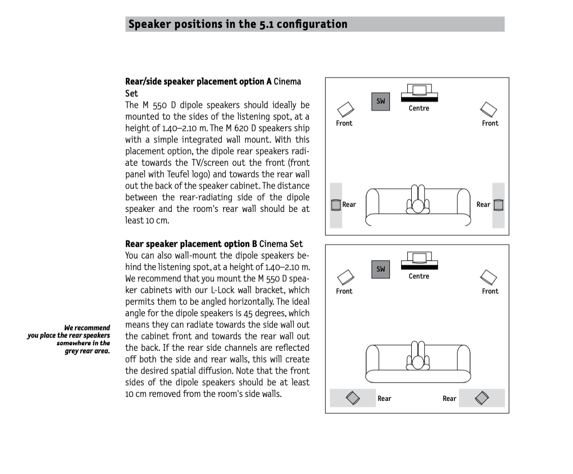

What does your receiver manual show for supported speaker setups? Position A for side surrounds or use position B if it calls for rear surrounds?
Image attached - but essentially, it recommends the sides. However, being dipoles, there isn't a 'wall' behind the seating in this room, and the rear-facing part of the dipoles will be going into the back 1/3rd of the empty room. To make matters worse, the unlovable pillars will block at least a good amount of that sound from reflecting back to the seating.
Great minds think alike - and this was my thought at one point. But what's not evident from the picture is that space isn't a closet - it actually is open straight up to a skylight two floors above, which in turn, is open to a balcony on the basement one level (this is basement 2), and just isn't practical to wall off entirely both because it cuts off all the light (which I could live with) but would also mean having to do a pretty extreme Reno (and this is a place we're renting long-term). There's also an AC vent in the very back of the room that is needed for air circulation (and temp control of the room, obvs). I think I'll have to live with the side walls. I might be able to figure out some sort of reflective paneling that could go in the far left/right of the pillars though...
With the low ceiling I would agree with your preference for the sides but lean towards getting them behind the couch position closer to the back wall (close to the doorway). Can't tell how the ceiling is laid out at the back, but I also thought about having the surrounds in the rear corners at 45' so that sound is reflected off of the back and side walls towards the couch. You would need a ceiling mount to get them out far enough, but if it's all open to the floor above then I suppose they have to be in front of the columns.
Well, still a cool room. Put a big rug down, set it all up, see how it sounds and deal with the walls as needed.
