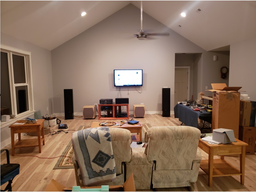

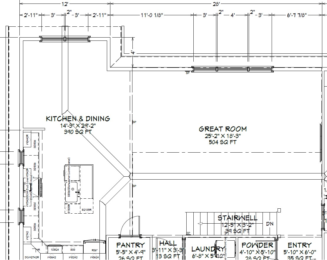

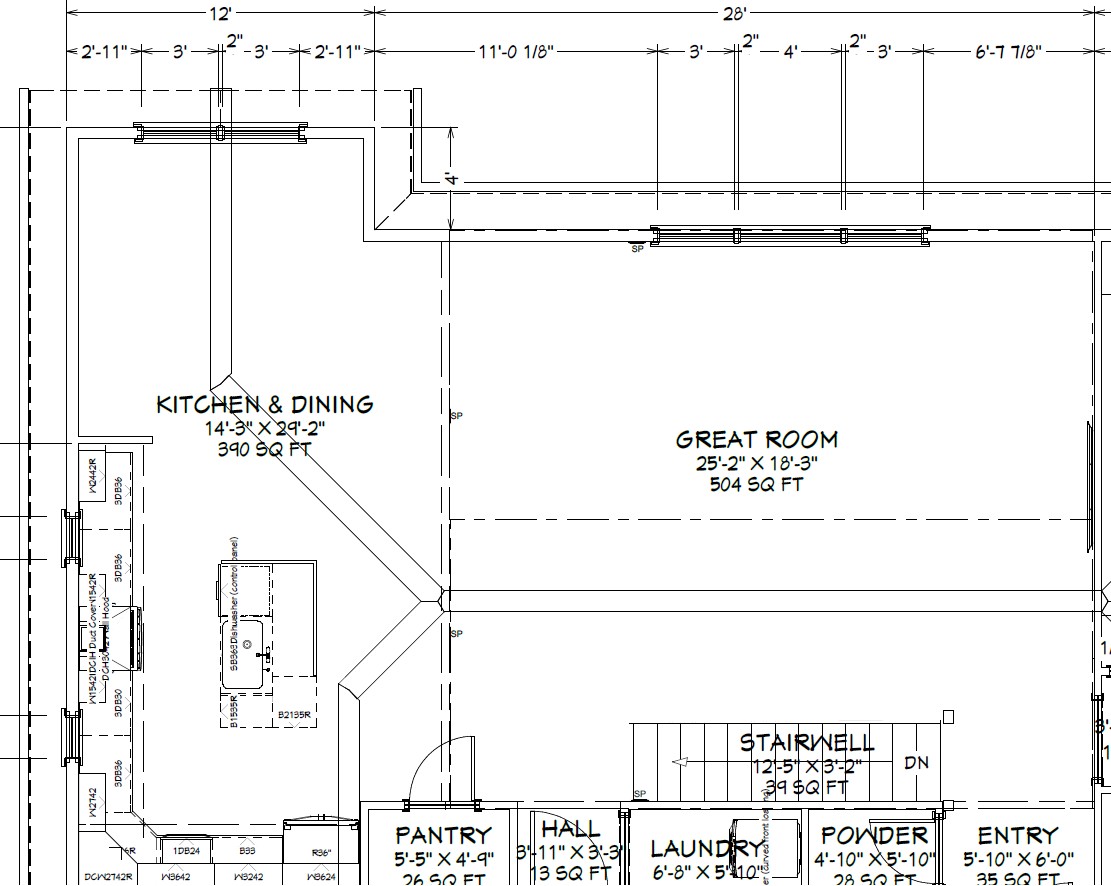

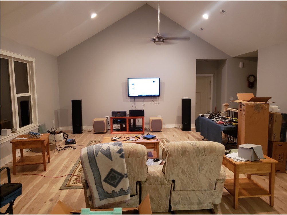

It is time to focus on my HT listening room. My listening room is ~22ft x 40ft with a 22ft x 28ft section (listening area) vaulted. The base ceiling is 9ft and the ridge height is ~17ft. The ceiling and end walls are currently all drywall and make for a very lively (echo) response. My concern is the frequencies in the mid and upper range. I normally use AMROC for treatment calculations but it is set up for rectangular rooms with flat ceilings. I am looking for an alternative way to calculate the amount of treatment needed to reduce the amount of echo coming from my vaulted ceiling.
