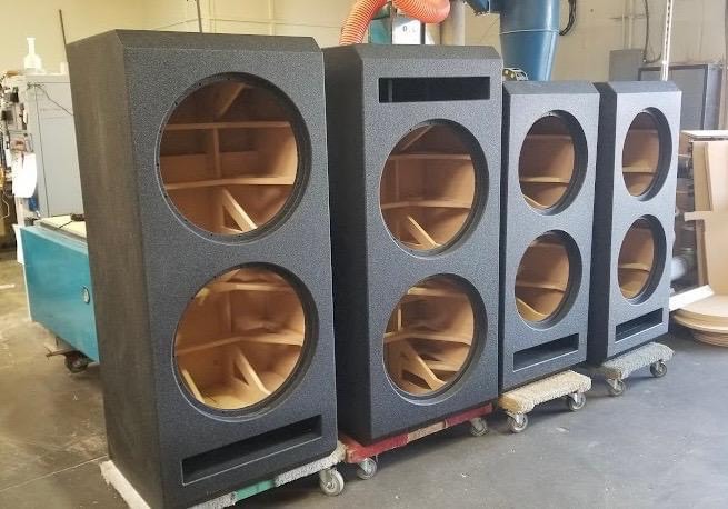

Evo Sealed Slim 21", 26.6” wide, 17.0” deep, 34.3” tall & >112dB @
20 Hz & >125dB @ 70Hz
View attachment 59624View attachment 59621
