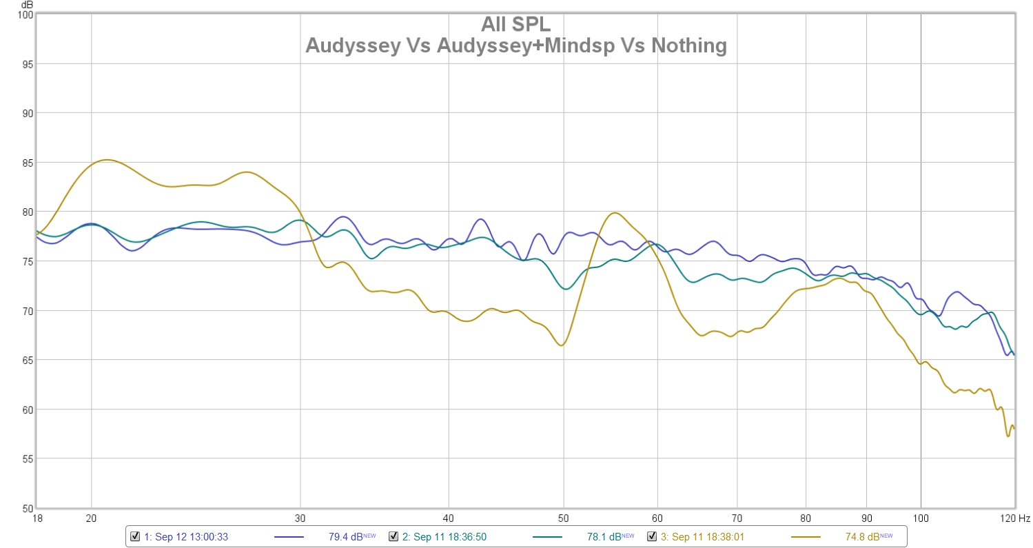

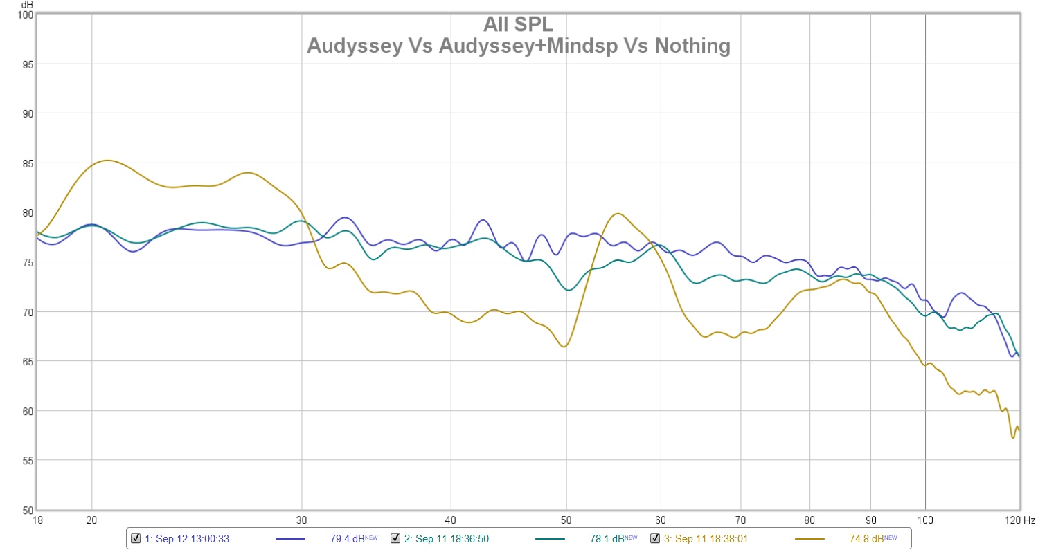

In the REW plots below, blue is Audyssey with minidsp 2XHD, it got rid of the dips at 50 and 70 Hz.
Mr. TheWarrior seems to be a helpful person, but I disagree with what he said or implied (not saying he's all wrong, just seemed extreme to me) about Audyssey, iirc he told me Audyssey would mess up the phase of my speakers/subs, without first viewing any of my REW plots. When I did post one, he did not follow up so he might have changed his mind a little but anyway that's distant memory that I shouldn't even have remembered:D.
I have a high regard for Dr. F. Toole but I am also have high regards for other well experts who may or may not have shared some of the same views that Dr. F. Toole has in his books. I have yet to order his latest book to learn more, as so far I have been relying material that he has made available online for free.
Minidsp did make slight improvements for me but with Audyssey alone, I was getting +/- 3 dB 18-90 Hz 1/24 smoothing and better in multi channel stereo, so I moved the mini to one of my stereo only system.
I am of the opinion (based on my perceived logic) that using the 2XHD with Audyssey SubEQHT will not likely get me overall better result for multi-channel material, any difference will probably be insignificant. For Stereo application, it most likely will work very well with SubEQHT/XT32, but at the moment I don't have an extra suitably equipped AVR for otherwise a good experiment for me.
Thanks PENG. I know we've discussed Audyssey on multiple occasions. I apologize if I left you hanging, in the past.
With the example above, those are very pretty graphs showing that each EQ solution provided a different result. But it is only one piece of the necessary information to make any useful comments. And that seems to be where my 'telling' rather than 'showing' has gotten me into trouble.

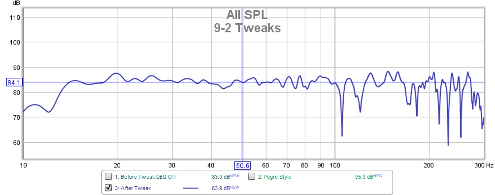

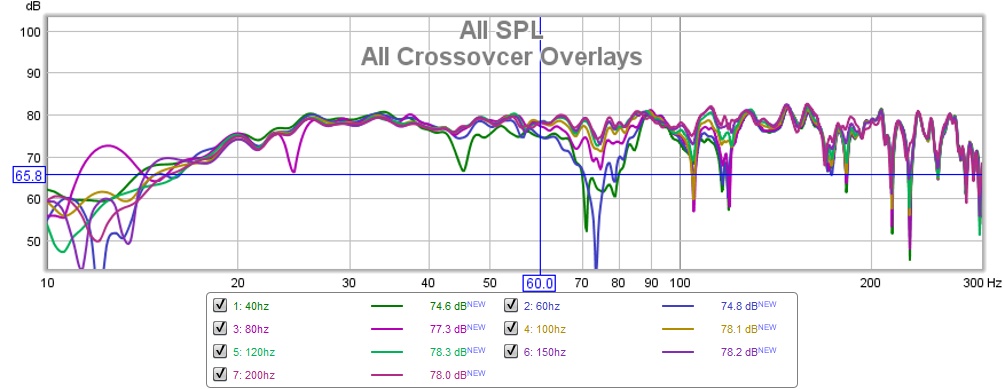

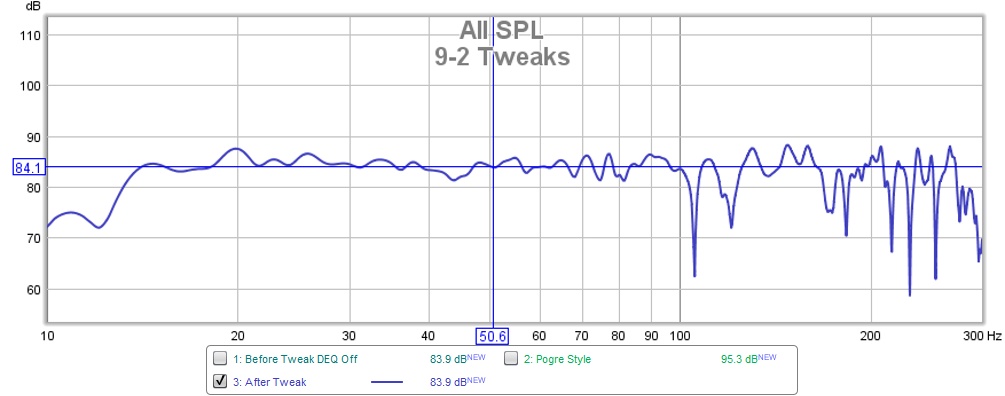

Here's where I'm at right now.
Gene posted another method I haven't tried yet in my thread that I might tackle this weekend.
This is one of many sets of sweeps I did while I was collecting data and calibrating. This one shows me that a higher crossover definitely gives me a better response. I didn't use smoothing on any of my measurements either. I wanted it all. The good, the bad and the ugly.
Is this a composite of subs only or all woofers available?
All woofers available. I had my towers active for the sweeps.
*Edit: My sub only sweeps look a lot better, but since I'll be using my towers to listen it just made sense to include them with my sweeps. I'm very interested in trying out what gene suggested with bi amping my front towers to treat the woofer sections like 2 more subs, then sum them all as one.

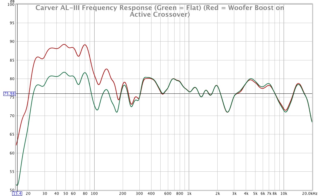

Alright, I finally unpacked my UMIK-1, connected it to my old Macbook Pro and took some measurements of my AL-III Dipole Ribbon speakers (see photo below; they're 6 feet tall). After playing with the active crossover Q/EQ/Trim controls to see exactly what effect they had on the room, etc. I took the measurements below in the graph and other than changing the level for the bass to make a "flat" graph (versus the boost I like to listen with),I ended up almost the same as I set by ear for the final graphs. I don't know what a "typical" room response interaction looks like with a variety of speakers so you'll have to tell me if you think it's decent or not considering it's got no EQ other than the active crossover settings that mimics the original passive controls on the back of the AL-III speaker (before the cheaper "S" model came out and got rid of the controls to save on the crossover costs). The total adjustment range is like 3-5dB I think (varies by each control). I smoothed the response by 1/6 octave. The red line is where I normally set the woofers (which cross at 200Hz) and the green line is the "flat" level setting. I hope I set it up correctly... :D
The mic tripod was sitting on some stacked cushions to get it closer to ear level and pointed straight ahead about 10 degrees above vertical. Compared to my old house, the bass response in particular sounds much better on the wood floor now than concrete (tactile feel) and I think the room itself behaves better in terms of sound. It's not only varied in shape behind me but there's a long hallway that seems to act like a bass trap and evens out the response over much of the range (wasn't that flat sounding at the old house). Using an SPL meter with test tones, I thought it measured pretty darn flat from 80Hz down to 30Hz and the graph seems to confirm that (couple of dips 90-125 and 165-180, but with the boosted bass it actually creates a nice averaged "drop" down to even flat with the ribbons, which is what i thought it sounded like and the graph seems to confirm save some minor bumps.
The green curve is about +/- 5dB averaged room response if I read it correctly. Obviously, the bass adjusted curve goes quite a bit higher below 200Hz. The speakers are rated 27Hz-20kHz +/- 3dB. They're also now 24 years old... (I've had to tighten up the ribbons three times) so might not be quite what they were new, but still seem to sound pretty darn good to my ears. They're also dipoles and Sonic Holography is engaged (which I tried on/off and it actually improved the response smoothness a little bit in some areas so I left it on).
Now the question is whether a Mini-DSP with DIRAC would/could make a significant improvement with the system. Is it worthwhile?

First thing is to go to limits tab and set for 45 low and 105 high. Your looking for a 60db window. That will show you more precisely the response. The 1/6 is fine as that’s pretty close to human hearing. The taller window hides a lot. Looks like almost 15db bass boost?
VonMagnum
VonMagnum
I'm seeing more like 8db above 'flat' bass levels (e.g. 60Hz is at 80dB, boosted it's at 88dB and it pretty much tracks the entire way save the bottom and tops of the curve where it meets the ribbons). It's an analog knob and I didn't test it by ear (used to measure about 6dB above 'flat' with the SPL meter, but then I didn't pink noise flat either, so it might be off a dB or two from what I used to see. I don't listen at 'flat' so it doesn't much matter. It sounds better downstairs at +4 to +6dB as well to my ears.
VonMagnum
VonMagnum
OK, here's a tighter graph for you. "Flat" is within limits of 71dB to 81dB throwing out the final dip almost right at 20kHz itself (+/-5 from 76 midpoint). Boosted is 71 to 89dB range (i.e. bass below 200Hz boosted by 8dB). That also gives a 20Hz response at 75dB (not too bad for dual 10" woofers, although obviously down from 89dB high. Bass is pretty solid at about 25Hz upward, though. They were rated 27Hz-20kHz). All the output from 200Hz up to 20kHz is from the 48" ribbon driver (2-way system). The dipole imaging makes them sound almost holographic in the room too (close your eyes and you'd almost wear someone is actually standing there singing, etc.) Kind of freaked me out when I first got them.
I'm thinking corrected, they could be pretty flat indeed over the range (and boosted have a nice even smooth slope). How much 'audible' difference that would make is the real question.

I'll probably get to the home theater response tomorrow or Monday. I've got some SSD drives coming among other things, though so it depends on how smoothly things go. I plan to bump the old Macbook Pro up to a 500GB SSD from its 7200 RPM Hitachi spinner.
PENG
It looks decent, but I would like to see 1/12 or even 1/24 smoothing. In my experience, no matter how hard I tried the manual method using spl meter, tones, crawling, adjusting phase, PEQs etc., it could not get anywhere closed to a 30 minute session using Audyssey, and presumable Dirac or AARC could do a slightly better job, on paper anyway.

I've been reading up more on the different graphs, measurements, theory, etc. at work on some down time and even the makers of MiniDSP don't recommend using less than 1/6 octave smoothing above 250Hz or so due to your ear's inability to hear it. I seem to recall it getting some pretty up/down variation with no smoothing, but then these are dipolars and may excite the room a bit more than typical with a delay because if it.
I'll try some settings and graphs when I get home, however. I'm more interested in decay times for room modes, etc. than overall frequency response at this point. I also want to see at least the mains on my home theater plotted and compare against the Audyssey predictions, no Audyssey, etc.
PENG
Higher resolution is needed for comparison purposes, not that you hear the difference. So if you are not interested in comparing the effects of, say for slightly different toe-in angles (just a example), then 1/6 smoothing is fine.
