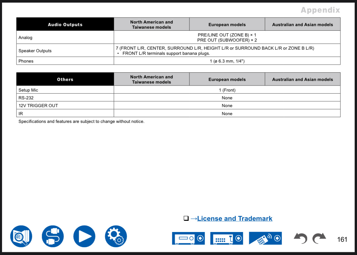

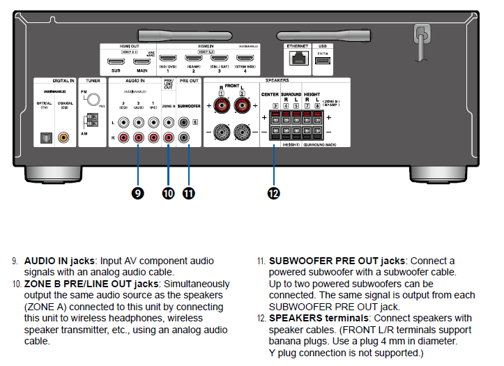

I would agree with using an ext. amp with the AVR, but I can't because the Onkyo 5100 does not appear to have front right and left pre outs, below is from the manual, unless the EU models are different, that might be possible, otherwise the pre outs are for subwoofers and zone B only.
Anyway, the OP can confirm that easily by a quick look at the rear panel.
That is odd as the picture I brought up showed right and left preouts. There must be two versions.

The Pre Out is for Zone B and it could be used for connection to an amplifier to power the speakers when using a 2.0 speaker configuration. Zone A can be turned OFF and just Zone B ON. The Zone B Line Out volume level would need to be set to “Variable” when connected to an amplifier.
If the receiver is in its default state, things need to be adjusted for the 2.0 setup. It defaults to a 7.1 speaker configuration with Subwoofer set to Yes and a 100Hz crossover setting for the seven channels.
There is no 2.0 Speaker Configuration setting. So, it must be set to 2.1 and Subwoofer set to NO. This will automatically set the Front Speakers to “Full Band.”

It can be a dangerous thing to use the Zone B Pre Out. It isn’t intended for use as a Front Channel Pre Out. It can work in a pinch for a 2.0 setup but the Volume setting for Zone B must be set to “Variable” when connecting an amplifier or a loud fixed signal will be output and it may damage the speakers.
Some Onkyo receivers will have only a Zone B Pre Out and some a Zone 2/B combo. Only the RZ30, RZ50 and RZ70 have proper Pre Outs for every channel for use with external amps. They also feature the Zone 2/B combo.
