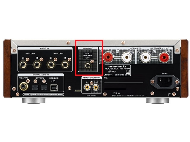

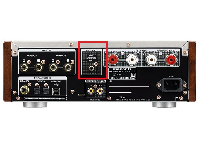

Just a pre-out, leaving any bass management up to your sub. Some subs can accommodate bass management but usually quite limited. Just looked at one of those units....ouch expensive for a 35w/ch simple int amp. Not even pretty (that porthole look sucks IMO).
You're talking about Marantz? Don't let @fuzz092888 hear you :D:D I like that one, but it's out because of power (or rather a lack there of) and now because of sub out being just a pre-out.
A stereo amp without this feature usually isn't performing any filtering. In that case, your speakers are fed a full range signal, and you would use the crossover knob on your subwoofer to achieve a good blend.
Does a regular bass knob on the front help to lower the feed to mains? Is this what it does? If you happen to have a pre-out, should you lower the bass on the front of the amp (you know the treble/bass knobs). Or would this affect the sub pre-out too. Would there be less bass for all units? Probably yes, eh?

Pretty much. Now if you find something like this, the options open up a little bit:
Normally a jumper would connect the preout to the main in to complete the loop. However, one can remove the jumper and send the preout to a subwoofer like the SVS SB2000:
Here you would set the low pass filter, and connect the outputs back to the "main in" jacks on the receiver/integrated. In the SB2000's case, the outputs have a fixed filter at 80Hz, so your speakers would consequently receive a high passed feed. The more expensive SB13U one ups that with a variable high pass filter for the outputs for added flexibility/improved integration.
Correct; it's most commonly a bit of PEQ around 50Hz. Not sure what impact (if any) it has on a sub-out; it may vary by manufacturer in any case.

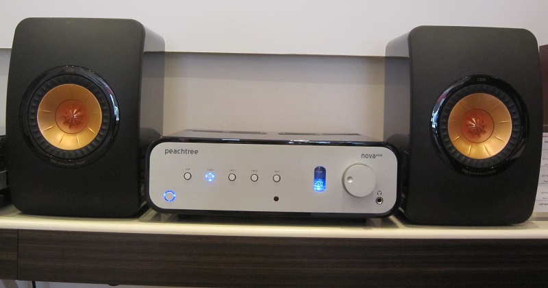

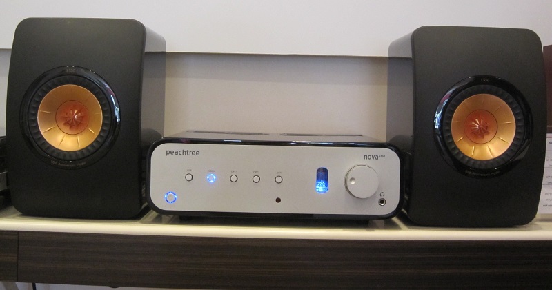

What I meant with 2.1 (and now I see my fallacy) is an all-in-one intgr.amp that is stereo with a sub out. Just like that Peachtree Audio pic I posted. It is a stereo integ. amp that has DAC built in, it has USB in for your laptop, (some even have phone docking), it has a sub out (although it is just pre-out) it can house a Sonos ZP80. So it is a center unit that does it all. But no tuner, no 7.2 outs, no video etc.
The Peachtree Audio nova65SE you mentioned sells for $800 in the US. It is a rather minimal product with little or no digital processing, and what looks like no bass management. The amp section is small, a 65 watt/channel class D amp. In my honest opinion, this should sell for much less than $800.
You may like the Peachtree's size, but I think you can do much better with one of those Yamaha products such as the A-S701. I admit, I didn't read about them in enough depth to know for sure if it offers similar bass management as most AVRs have. Does anyone else know?

It is somewhere very close to this, or at least along those lines:
I only have to place it better and I WILL be using stands. (Do my pictures show when I put them in a reply??)
You may know that I also have a pair of LS50. I have driven it with my AVR3805 (again, I know that won't work for you) and my separate preamp/amp system. I prefer the AVR's sound only because of it's subout. The Cambridge audio preamp's preout has a toggle switch to select either full range or 200 Hz LP, ridiculously useless.:D
By the way, I tried the LS50 without stand for a while. My suggestion, get the stands. For me, it was $300 well spent.
