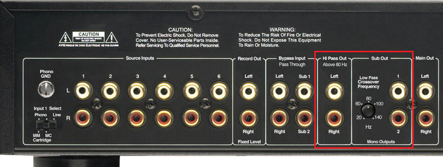

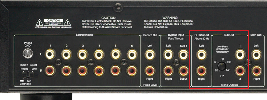

For me, the biggie has always been a sub out with bass management.
When you say bass management do you mean something on the inside or just a crossover knob on the amp itself? In other words if I find a sub out (no knob, just a 3.5 jack like the smaller one for headphones) on the back does this necessarily mean that there is some separation of frequencies inside? If I open this amp maybe I'll find just two wires going from left and right speaker out, only on the inside to make it look more serious.
I did find a couple of amps like this, but I'm still waiting to see what speakers will I be matching my electronic with.
Steve81
Steve81
Audioholics Five-0
Bass management can take the form of digital processing done within the AVR, or a labeled low pass filter knob for the sub combined with high passed outputs for your speakers. You can see an example of the latter in this pic:
A stereo amp without this feature usually isn't performing any filtering. In that case, your speakers are fed a full range signal, and you would use the crossover knob on your subwoofer to achieve a good blend.
So this is as good as nothing (or not really nothing but all it does is tidy up a little bit)?
