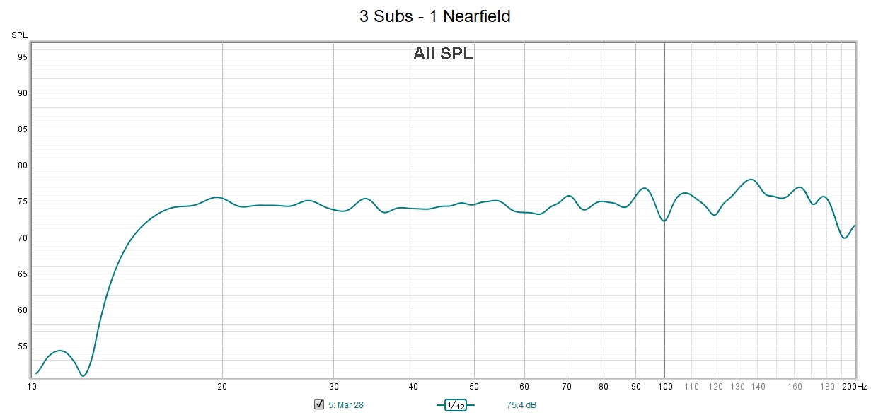

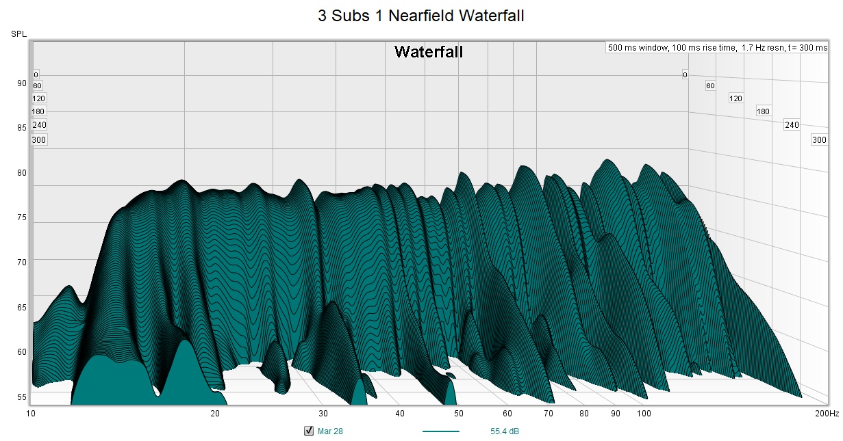

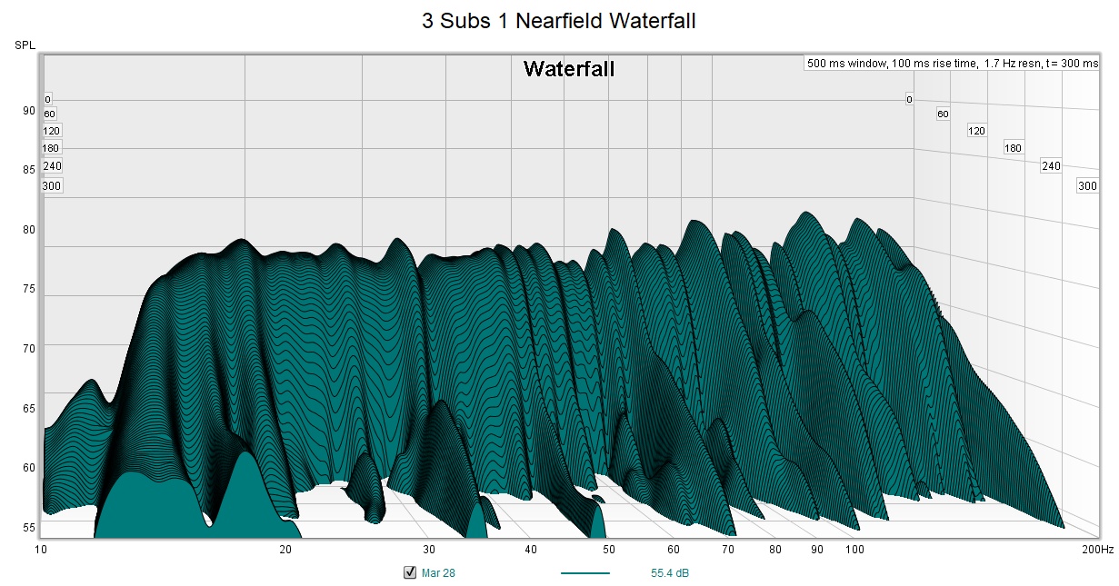

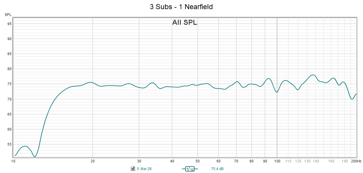

Calling it good for tonight! I'm just now kicking back and doing some listening. Hard to describe the difference with mid bass. Just seems clearer and more "there". Deep bass... nearfield is another level. I can really feel it shake my chair! It's pretty awesome! I'll go back in again again and do a little more tweaking, but it's pretty dialed right now. I did my usual for a house curve after I got it flat like below. I got poop bumpin' right now, lol. Oh! No issues with localization either!
View attachment 46066View attachment 46067
Wow that chart looks sweet! Great overall response!!! I bet it sounds so awesome bro super happy for you!
