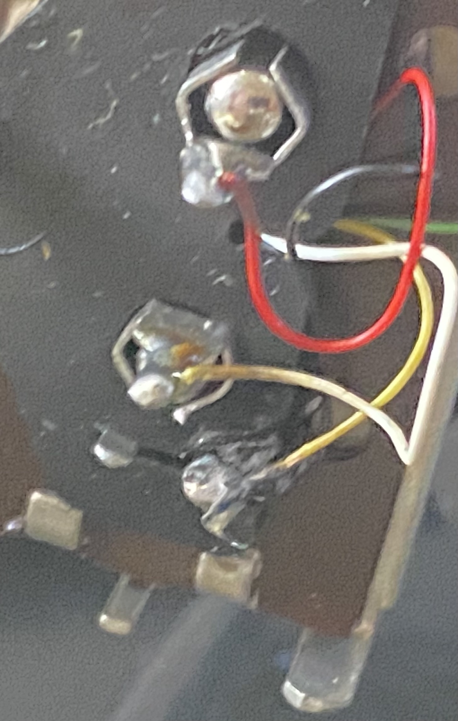

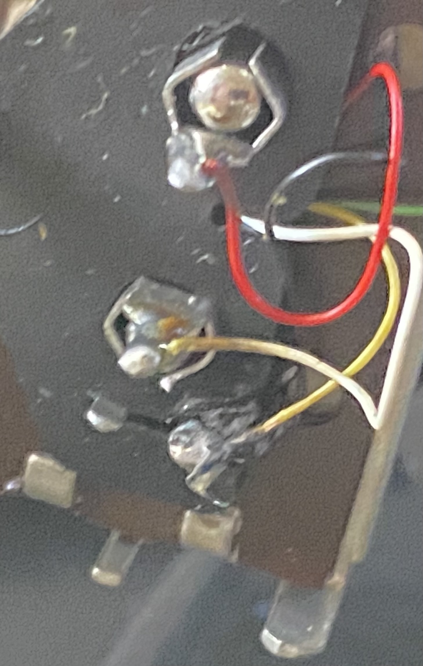

Garrard Zero 100SB cartridge wire disconnected from RCA port. The light brown wire needs to be resoldered but the wire is so thin (like hair), I am uncertain how to solder it back on. Any tips or tricks?
I need more information. Since it is an RCA port you are talking about, I assume this is inside a plinth, and not the cartridge end.
Pictures would be helpful so I don't give you incorrect advice.

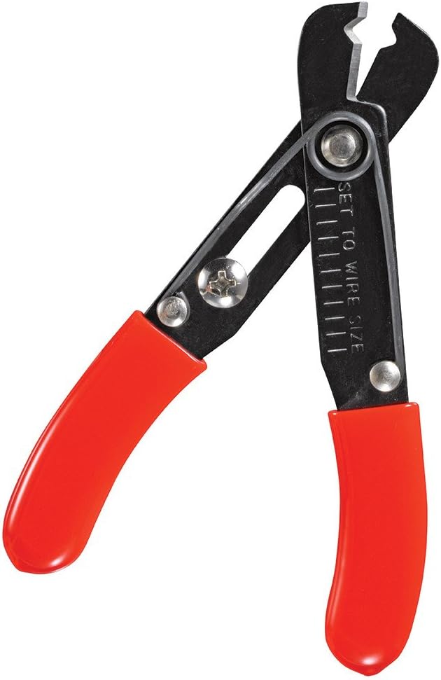

That looks very straightforward. End the wire to be soldered with wire strippers.
For audio work these are my favored wire strippers.
Now you need a soldering iron, and high quality multicore solder.
Twist the end of the wire to be soldered and tin it with the hot iron and solder. Put a little solder on the iron, now apply it to the wire and apply more solder until it runs smoothly.
Now do the same to the connector.
Now apply the tinned wire to the RCA plug. Now let the tip of the soldering iron rest on top of the wire against the RCA plug. Leave it there until the solder runs smoothly. Now remove the iron, holding the wire in place, and blow on the junction until the solder is hard.
Now you are done.

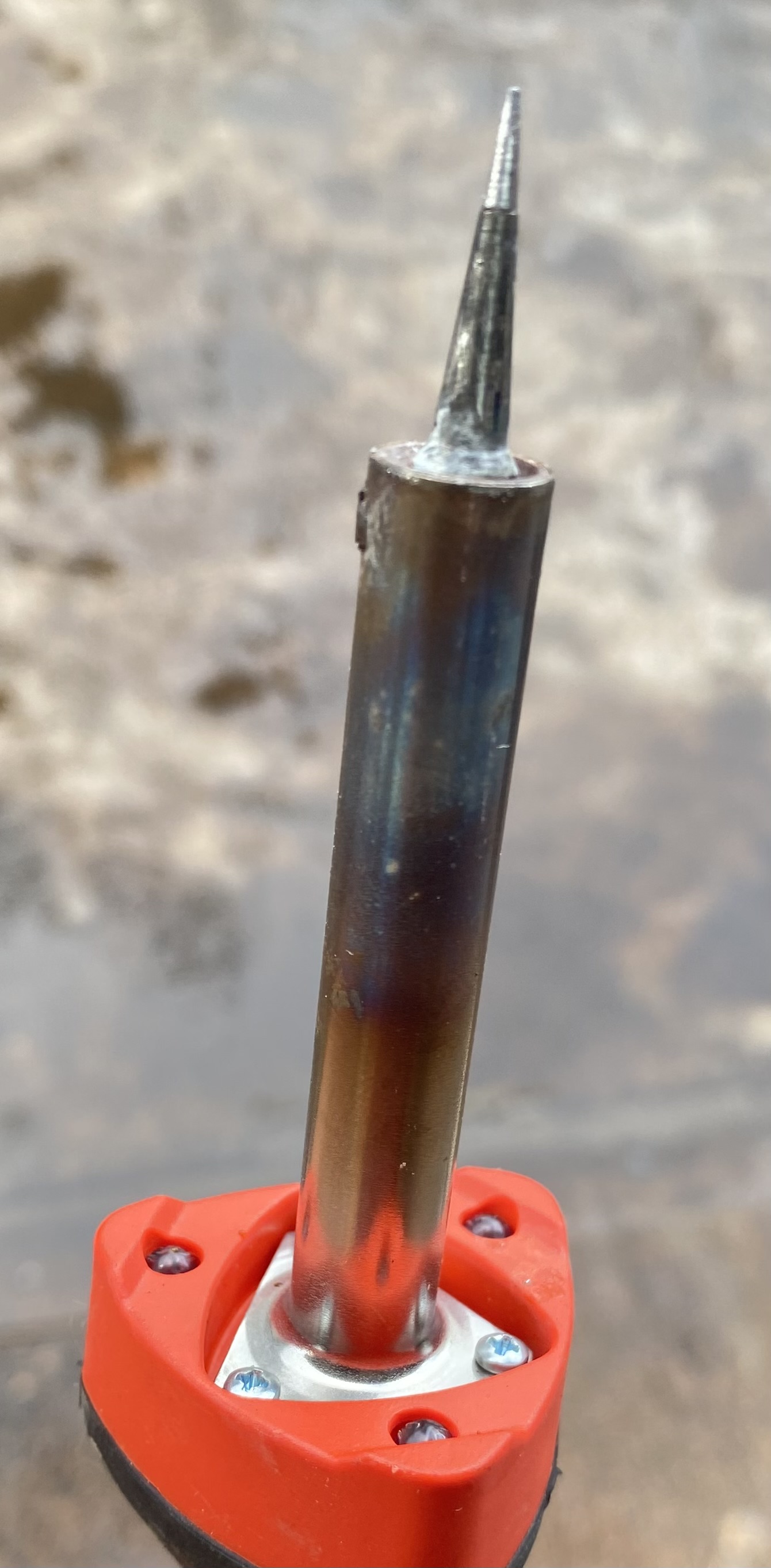

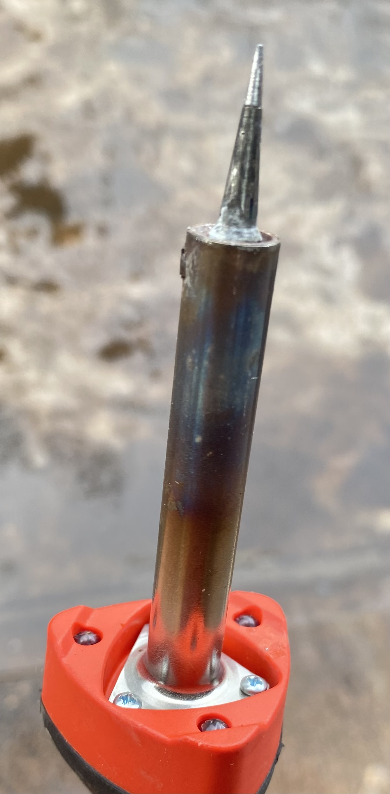

Thank you! So a multicore solder not separate flux and solder. Got it. Sent a pic of my soldering tool.
Thank you! So a multicore solder not separate flux and solder. Got it. Sent a pic of my soldering tool. View attachment 67493View attachment 67493
That soldering iron should get the job done for you.
