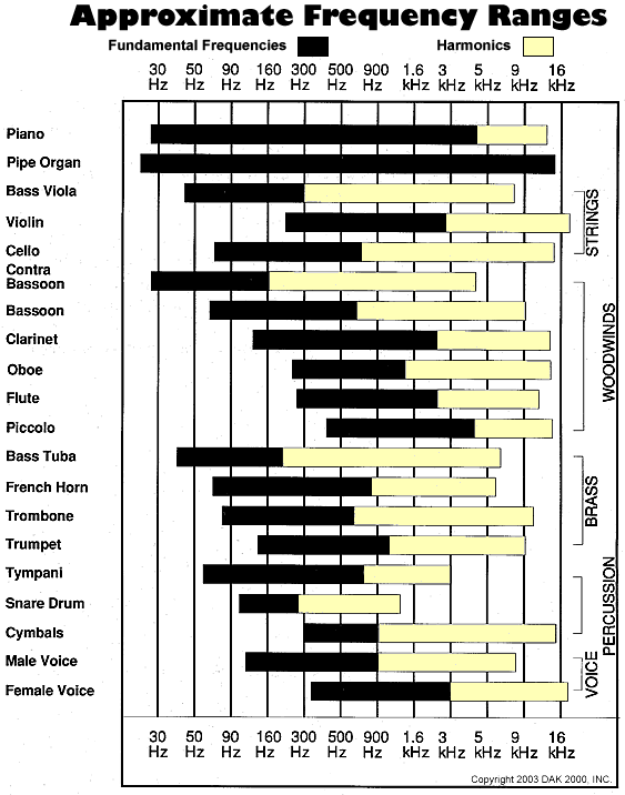

Here is the frequency spectrum of most orchestral instruments.
I'll add the tuba which comes in different sizes with fundamental ranging from 29 to 44 Hz.
The orchestral bass drum is of particular interest, as it can give the orchestra at times that massive punch and wallop.
The initial crack is a huge energy output from 100 Hz to 15 KHz with a decay from 20 Hz to 100 Hz. The big energy punch is in the attack.
You will see that only three instruments have fundamentals just below 30 Hz. Only very large pipe organs have fundamentals at 18 Hz and most not below 32 Hz. That is because most organs only have 16 ft stops at the deepest and not 32 ft.
Now the preponderance of the energy radiated by instruments is in the range of the fundamental.
So you can see where the power is really required, it is from around 60 Hz to 1.5 KHz. And I will say this again, but the bass range extends to at least 600 Hz and many would say 900 Hz. Mid range starts somewhere between 600 and 900 Hz. I tend to think the higher number is more realistic.
When you really absorb what I have been saying you realize where amp and speaker power really needs to be concentrated. You can clearly see it is not in sub range.
Not only that, but a sub not only really separates a lot of instruments from their fundamentals but actually puts a crossover right at the range of the fundamental of a lot of instruments.
I agree with one of my mentors, the late Ted Jordan, that crossovers have a deleterious effect separating fundamentals from harmonics. The usual sub crossover is in a terrible place. The flat room response is not the total package at all, as it says nothing about time, which is the neglected issue.
