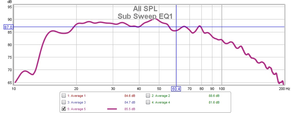

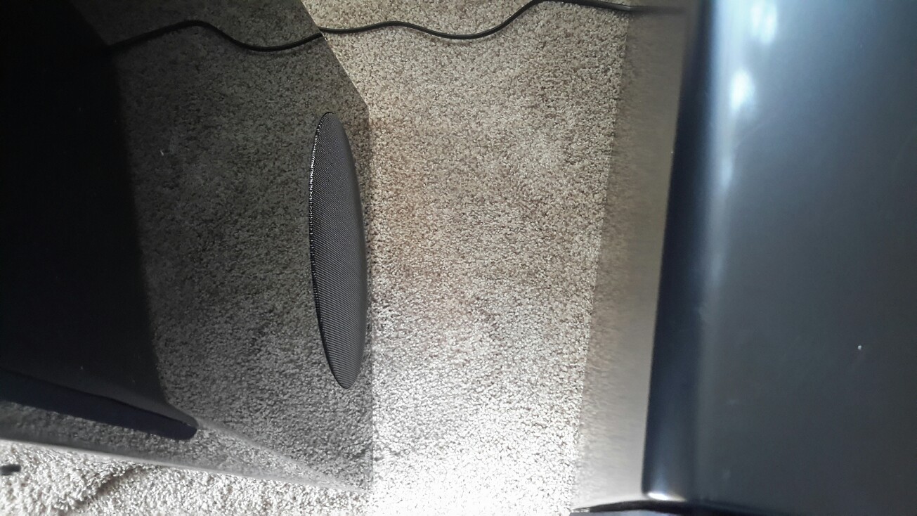

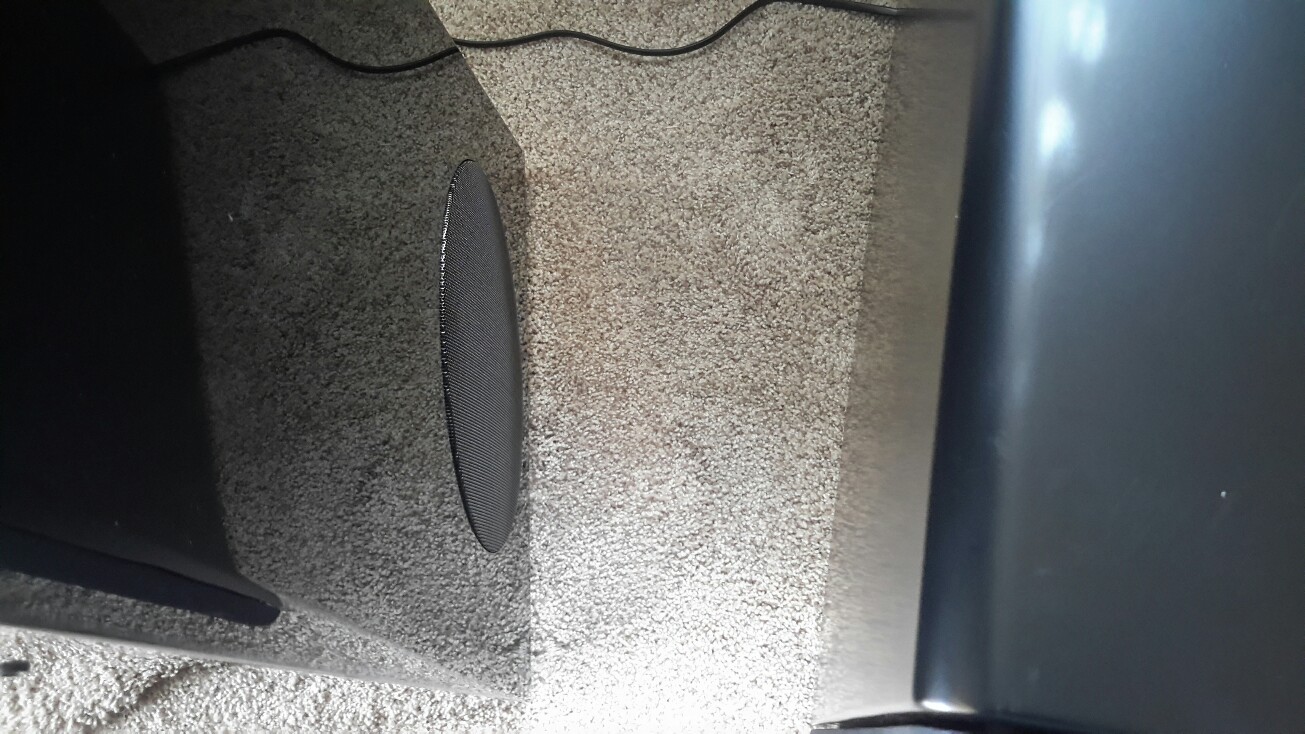

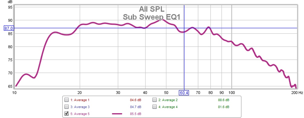

I'll add also that those nulls disappear when my subs are on. The subs themselves mess up the tower's response. They're too close to the mains and each tower is firing an 8" right into the side of a woofer cabinet. If I pulled the subs out of there they'd probably measure even flatter.
There's only 6" between the sub and that driver on either side. Not ideal, but I have subs. :)
That's my bass response with the subs on.
