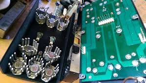

Where are those exquisite heat sinks that was mentioned? I am thinking a good sized heat sinks.
Here U go, the tunnel is extruded and U can see the staggered finger heat sinks for each output device... The top cover is a filtered air intake, mounted on the rear is a temperature sensitive, servo-controlled fan, air is drawn through the top cover through the tunnel and the the hot air is exhausted out the back. The staggered finger heat sinks create small eddys of air circulation around each output device as the air is drawn through the tunnel....
Just my $0.02... ;)
mtrycrafts
mtrycrafts
Just my $0.02... ;)
Thanks. Great picture and explanation.
