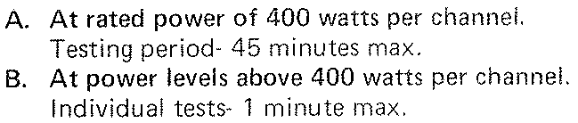

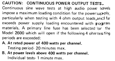

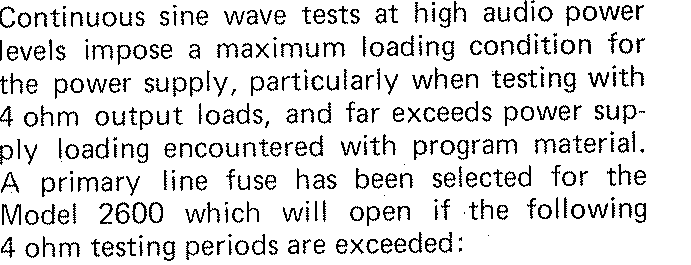

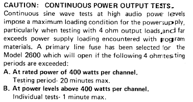

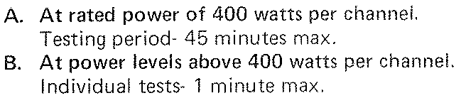

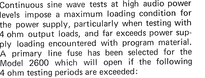

Preconditioning is 1 hour, but as you know that's at 1/3 full power at the time (later changed to 1/8). At full power it obviously can't go as long, that's why 45 minutes maximum per Marantz owner's manual. By the way this thing has a fan, you should be able to see it at the back right?
If you go with the service manual, it was only 20 minutes.
If you still have the Owner's manual, it should be on page 25:
Service manual, page 7
I cannot see a real world use case driving the 2600 for 45 minutes continuously @ full power output into either 8 or 4 Ohms..... The 2600 thrives on high power output but as the original FTC statue stated the actual power measurement is only 5 minutes @ 20Hz, 1kHz and 20kHz after preconditioning for an hour @ 1/3 rated power output. The reason for the 1/3 power output for preconditioning was that put a very high stress on the power supply.. And as U know even today some brands install fans just for the power supply...

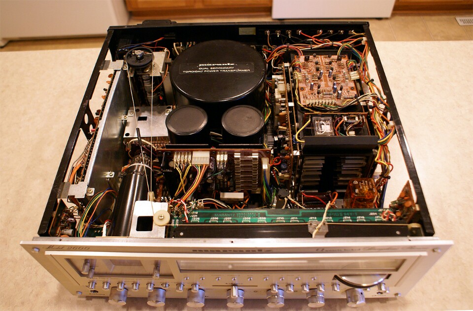

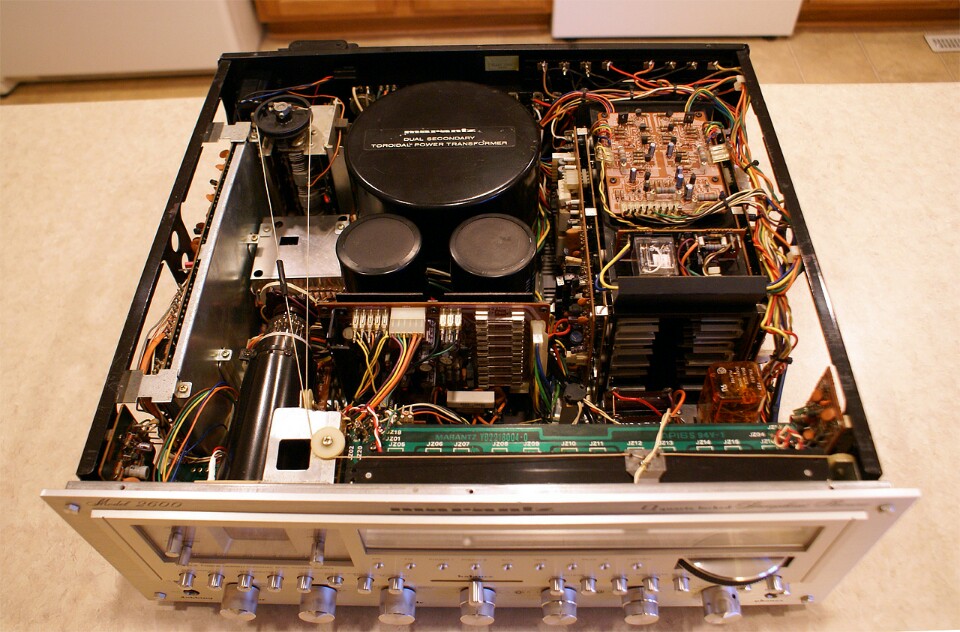

So you guys got me looking and I found a pretty good image of the the insides of the 2600. This thing really is a beast.
