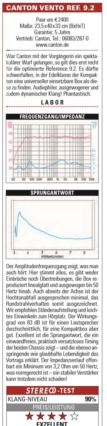

I don't agree. The higher end Polk speakers are really good, and they are at least as accurate if not more so than any of the brands you mentioned, even Revel and Kef. The measurements for the LSiM speakers in particular show them to be extremely linear. Here is the listening window for the 703:
Does Canton produce anything that measures that well? I haven't seen it.
The deal is over on the canton but they happen frequently on accessories for less. Check out kpaceguy on YouTube, he just went from lsim to vento line. Said it was a monumental improvement over Polk. I really like Polk audio too, from rt2000 to lsi25 I had. I tried lsim 707 and it was nice but too dark sounding for me. Just my preference, still nice speaker though. I actually liked rti12 better than lsim.
canton does very well on graphs as well. They are all over the internet but most are in German. Enjoy doing the research on them. It’s a fun company to look into. The 9.2 are just bookshelves too

canton does very well on graphs as well. They are all over the internet but most are in German. Enjoy doing the research on them. It’s a fun company to look into. The 9.2 are just bookshelves too View attachment 38331
