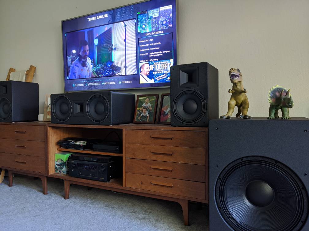

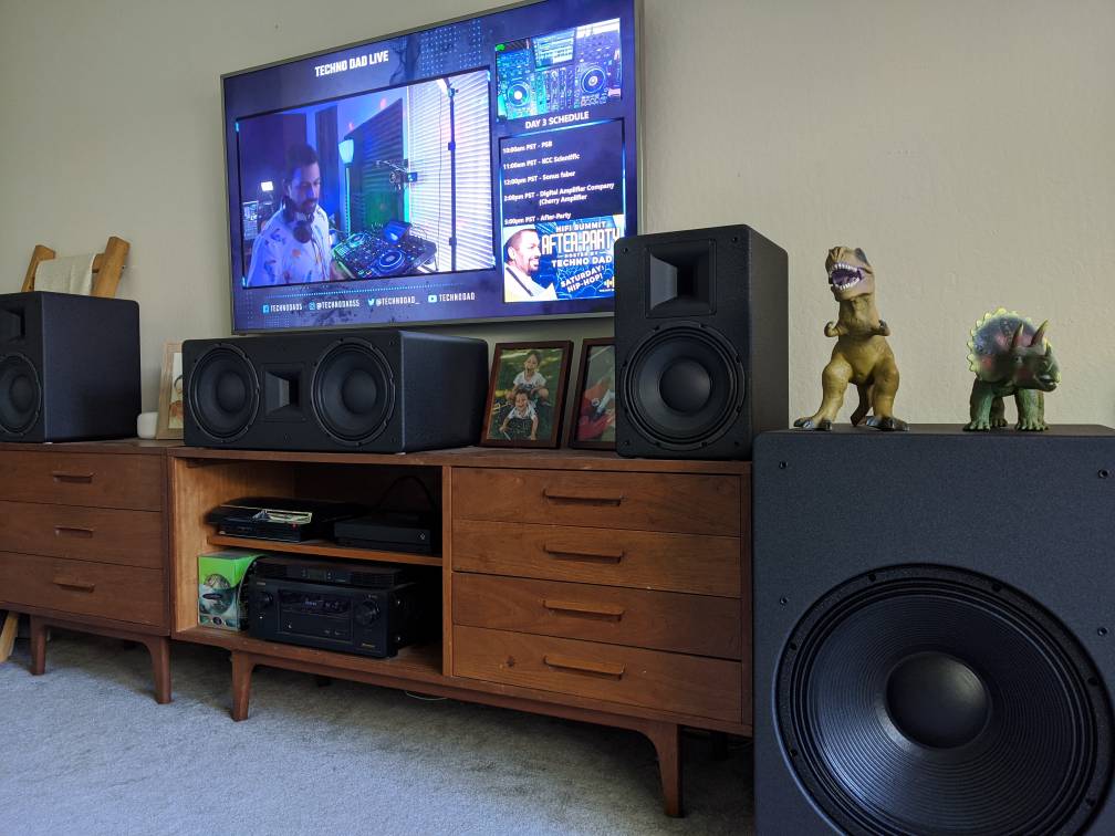

Thanks everyone! Great options. Has anyone heard the PowerSound Audio MT-110?
Yes i own some they are great IMO.
I listen to my movies at reference levels and I get ZERO distortion. They don't go below 70hz so you definitely need a subwoofer.
