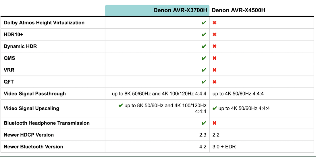

If I was looking at a new AVR and I had a decent external amp I would go with the 3700. It's sonically better than the 4500 and has additional features and runs cooler:

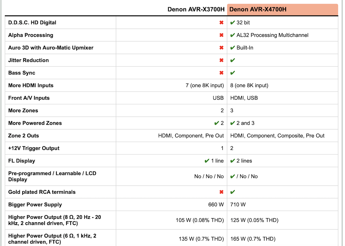

If I wanted Auro-3D and dual readout lines on the AVR I would go with the Denon 4700.
The problem with going with the older 4500 or 3600 is there has been significant changes since then and quite frankly - they are old models. The 4500 is several years old tech. My 4500 broke down after 9 months and it's still in the shop waiting for parts... After a month in the shop I bought a 4700 and will use the 4500 in another room if it ever gets fixed by Denon.

I posted a comparison list. While the 8K port is obvious, Atmos virtualization, HDR10+, Dynamic HDR, bluetooth headphone support, newer bluetooth and HDCP versions are all new features. At some point, you have to decide if I'm going to buy do I want older tech or the latest?

I posted a comparison list. While the 8K port is obvious, Atmos virtualization, HDR10+, Dynamic HDR, Bluetooth headphone support, newer Bluetooth and HDCP versions are all new features. At some point, you have to decide if I'm going to buy do I want older tech or the latest?
8K, are you serious? HDR 10+, how many TV brands, UHD disc, streaming services provide HDR-10+? If you would have said better amps I could understand. I don't think it's wise to purchase just on the grounds of being a new tech.
I can't report better amps. My 4700 ran super HOT until I used ECO mode. Eventually, I moved all my speakers to external amps and selected "Preamp mode" in amp assign. Even still the unit has some heat coming from the top. The Denon 4700 runs hot.
