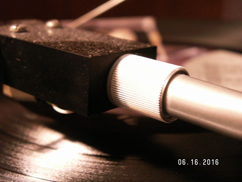

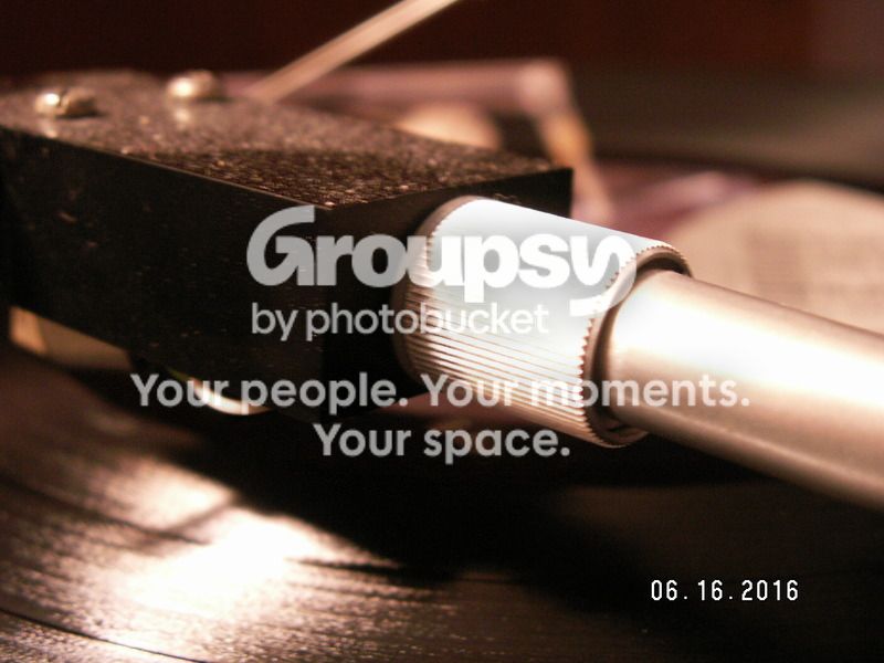

The collar on the tone arm that locks the headshell in place is somehow loose so the headshell is easily moved out of alignment.
I think I need a headshell. I've just been careful with it and check frequently to make sure the headshell is lined up to the platter. The turntable has been functional all along though so I've been listening happily away.
