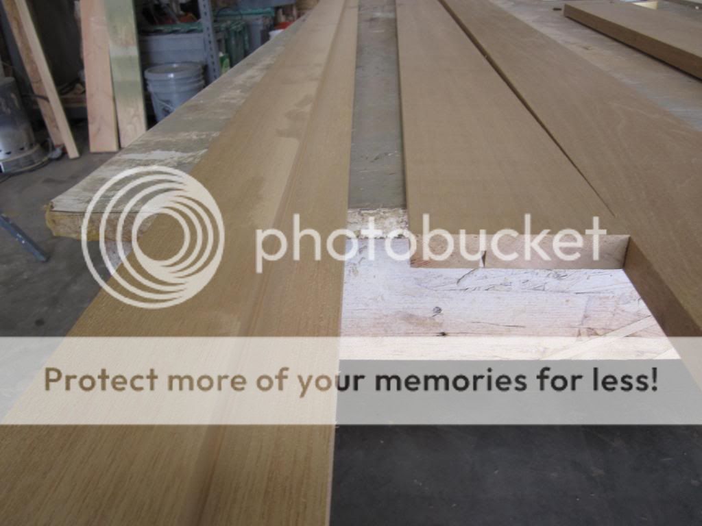

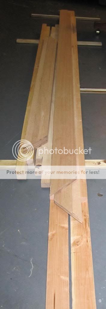

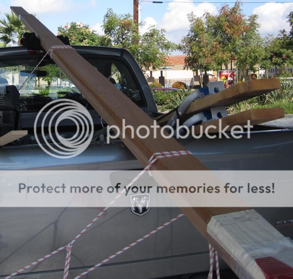

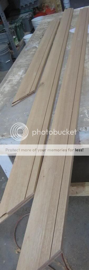

We finally acquired all of the wood, and cut everything yesterday. I am pretty excited. We cut rabbits into the entire screen back outer edges, so that it will fit snugly into the framing (we're still going to fasten very well of course). Wood splines for the corners. No extruded metal for the screen spline, but just instead bought the thickest rubber spline they had at HD (too bad they didn't carry solid spline, but the hollow stuff still seemed to be extremely firm). It's all now in the garage, waiting for the day for my friend and I to be free on the same weekend. The false wall's vertical supports have rabbit cuts too, so that the longest horizontal boards will fit into them, and strengthen it all since the boards are running perpendicularly (sorry I can't explain better). Maybe I have energy to post a pic or two now. Anyways, I've never been on wood cutting tools for this long in my life, and particularly such nice ones. His table saw fence is worth $850? Well, most of my work was involved with the chop saw, rabbit cuts, planing. It was a lot of fun, and I learned a heckuva lot, and I am extremely appreciative of my friend. He did all of the spline cutting, for both corners and screen dados (he probably would have walked me through these too, and explained all the whys, if time permitted). We don't know which method we will use to pull on the crowns/bows of the inner vertical boards; we might use a cable pulling outwards, for minimal blockage of speaker (it will be very strategically placed). I'm wondering if my friend is just overkill, though I trust him, because at least a couple of the vertical boards that I picked out were pretty darn straight.
OK, a few after all. Trucking the 17ft long and shorter PM boards to the shop. (We picked up the Doug Fir later that day).
Rabbit cuts on the PM screen frame.
Angled corners with screen spline dados.
Waiting to be installed, wrapped and/or covered.
