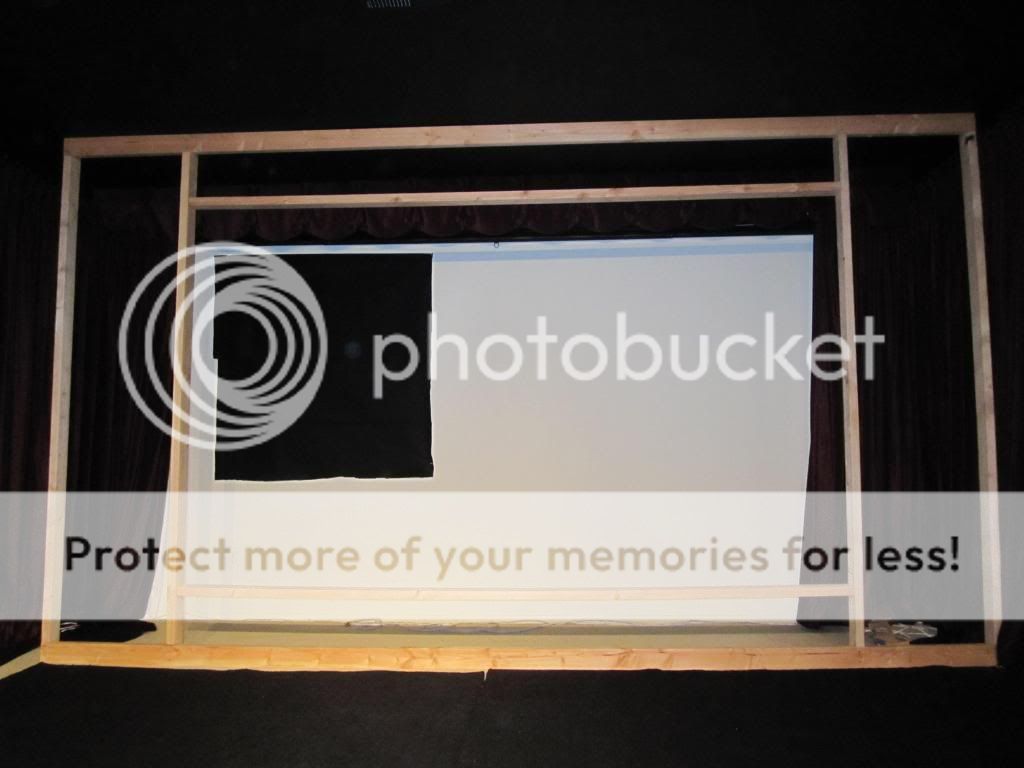

Some good progress, until I hit a mental roadblock, which is stopping me from applying fabrics, and that is the second guessing of the method to mount screen. I think I will go with what my friend advises, which is flat black drywall screws. Right into the front velveted frame, into the false wall. He believes that "the best way is always the easiest way", and that if I ever wanted to do machine screws, I can always do so later. However, this idea implies that to get behind the false wall, I have to take off the screen (no velcro of speaker cloth on wall). (My other idea was to velcro a side or both sides of the wall, and to screw from behind the false wall into the screen frame.) I hope the reflectivity of black screws buried in velvet would not be an issue.
So, he told me over a beer how to apply the fabric. I will use 3M Super 77 for the first time, and do the corners or any area where two pieces of fabric overlap last with the spray. I will use a very sharp razor blade to cut through both, peeling off the segments one at a time, then finally use the adhesive at the corners (the fabric is already glued in the "middle"). I will pull only moderately at the beginning, let the flaps just fall at the end. After all this, then I will actually pull harder to staple to the rear. I have to be 100% sure on mounting method before I do this, because once it's on, there's no going back.
I will use 2x 6" wood screws to both and top of false wall, to fasten to ceiling and floor.
The false wall was built a tad too tall only on the left side. I took off a bit of paint when "dry fitting" it, but my only real concern is to make sure I don't take any texture off the ceiling. I think to plane the top would be just too much, and I don't think I want to deal with taking it apart and re-cutting.

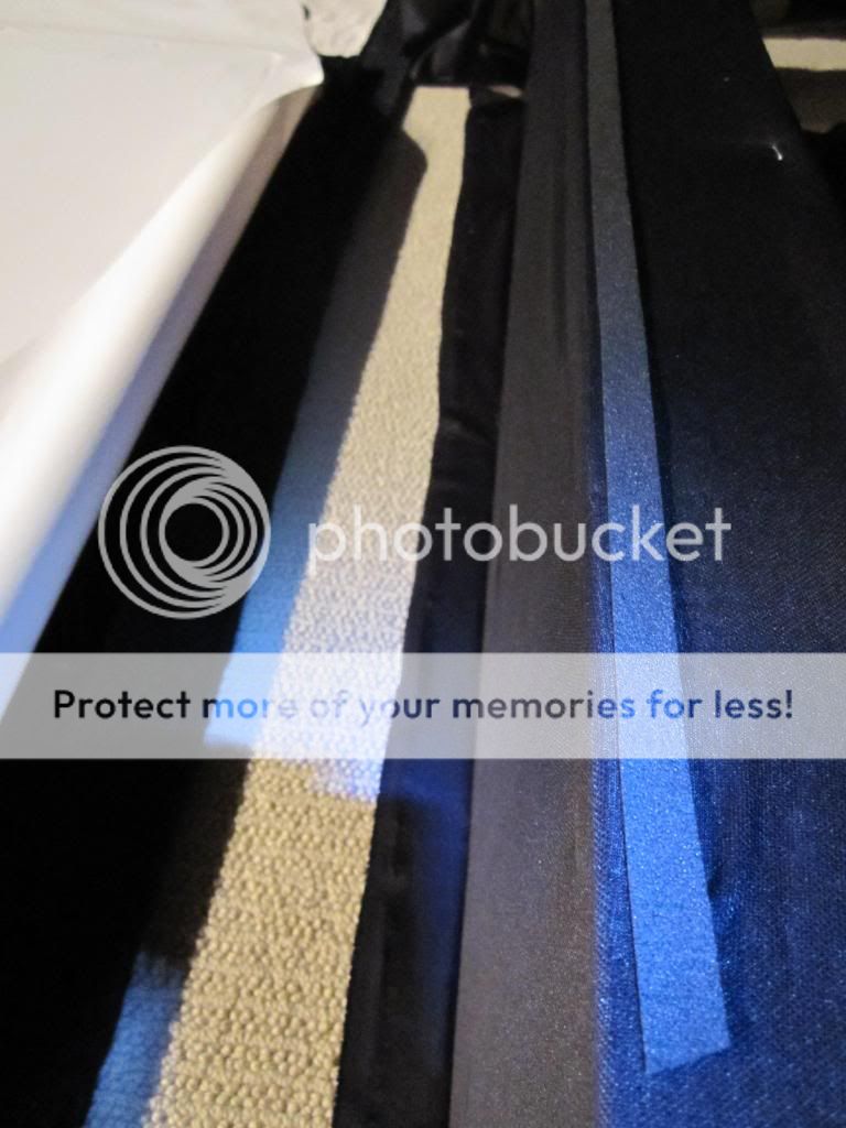

I tested samples of velcro on cloth, and I am happy to say it holds very tightly, which makes my life much simpler (and is totally welcome at this point).

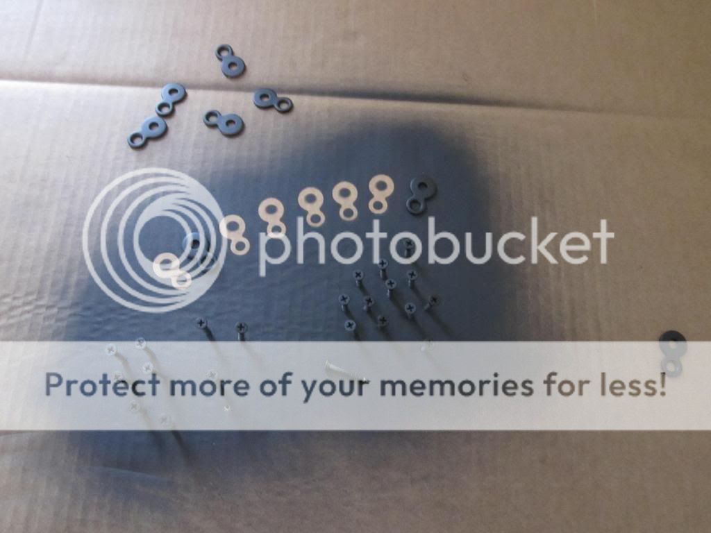

Even though the brackets and nice screws I picked up probably won't be visible at all, I still went at 'em with spray paint. I suspected my friend's idea of drywall screws drilled into the front was a very bad one, but after seeing the Fidelio in person, I realized it was truly the worst idea possible! haha.

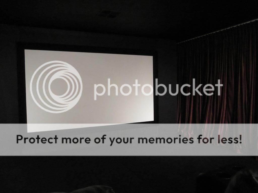

A shot of the finished screen frame, resting against the curtain. Close up shots of the screen frame are impossible, a couple of pics came out nothing but pitch black. Oh gee, the false wall's screen cloth looks like it's sagging on the bottom left, but it isn't.

I AM DONE. :D Ok, at least all the constructing is, video cal is 95% done, and audio cal is halfway there. Thanks again to those who had input and feedback for me earlier in this thread.
I think I see a bump in the velvet in the photos, bottom, just left of center, and I pushed/pulled at it with my finger tips, so hopefully it's perfect there now.
I also wonder if I should have painted the framing wood, particularly the bottom length, because I notice it in the photos. I think I'm fine though, because I don't normally have this lighting arrangement with all of the track lighting pointed towards the front for work purposes, and now photography purposes. I do wonder though. Oh well, too late now!
Both sides are attached at the extremeties with velcro, at 3 spots, top/middle/bottom. I can't ever get the speaker cloth to be perfectly smooth all across it seems, particularly at the bottom, but at least it's not visible from most viewing angles, and definitely not when the lights are off. I believe that this was the best method, as to take the screen on/off to access the rear would just not be cool.
It appears I took off a bit of paint where it can actually be visible at the very top/left (where most of my mallet blows took place). If the cloth sags there, it can be visible. I'm not sure if I'll try to touch it up there; we'll see if it ever becomes an issue again, or a frequent one at that.

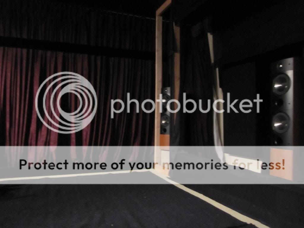

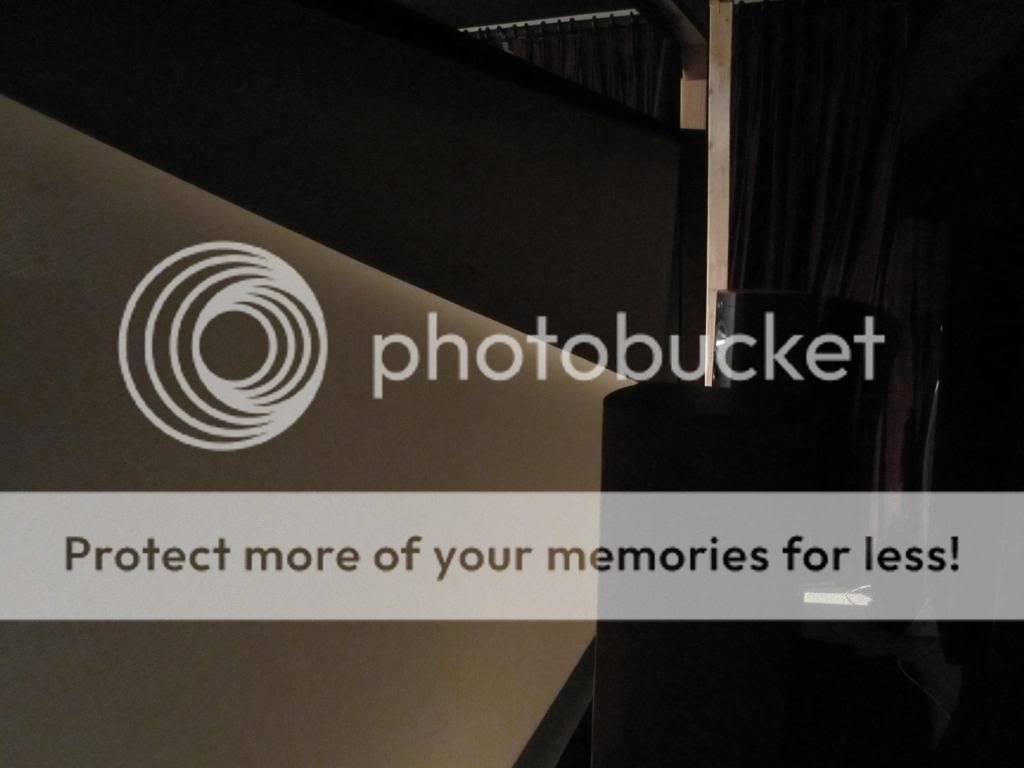

I only used four brackets after all, two on each side, about a foot from either top or bottom. To do so, I had to cut little slits in the speaker cloth to get to the framing on the other side. I suppose if my frame/screen boundary(s) rattle with big LFE hits , I may add more brackets. I hope to be fine with velvet all the way around, and some foam tape as well at the bottom.
For the razors to cut the slits, I really don't know what to think of these Feather razor blades I've used for this project. Yeah, they are way sharp, but I think they do wear fast, but they're so darn thin and flimsy it's sorta hard to know when an edge has dulled. I think a lot of my work might have been easier with sturdier blades, even at the expense of some sharpness.
More light control: I don't remember if I said it, but I put fabric on the floor behind the wall. I also put patches of black cloth on the fronts of all three cinder blocks, and even the lower wood panel of the center speaker (my speaker cloth is only so wide, so it couldn't reach the bottom maybe by about half a foot). No, I couldn't be bothered to cut a long piece of cloth again, to be stapled.
All in all, I learned a LOT, even if only little things about this and that, but they all add up. It also proved to be quite a workout for me. Well, I think that covers most of it, so without further ado . . .
Bracket, no flash. I like my solution, but now I really wonder how people mount theirs.
From the left.
From the right. You can make out the right speaker's drivers.
From the middle, with dimmer lights, still pointed forward toward screen.

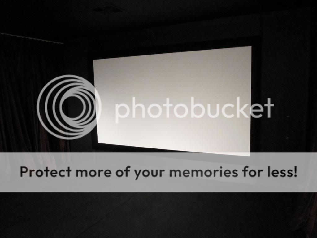

Well, this thread was originally about a false wall, but I'm going to talk about the screen here, because that was the whole reason for the wall to begin with. So, IMO, this screen material is a no brainer for the money, assuming you sit roughly double digit feet or more away from it. I for one cannot detect any texture whatsoever from the seated position or even closer. This material has been said to be one of the most color-accurate available, and I am coming from on of the least color-accurate in the Dalite HP. Ok, well the colors do seem to be more accurate, with a greater and more defined pallette it seems to me, but OTOH I do think I'm also getting more familiar with the Spears disc too though. There is also the whole placebo thing, but my point is that this idea was all for the audio, but I think the video has improved a lot too!
There is no question that obtaining an outboard CMS with colorimeter should help tremendously with my rig.
I ran Audyssey MultEQ XT, and it bumped my center speaker by 2db relative to the mains, which is caused by the weave. I will likely have to run it all again, because I need to check/recheck sub settings/eq that I want to do prior to XT.
Bye bye midbass boosts from having center speaker too close to floor, and MTM lobing at the extremeties. Bye bye off-axis dropping of brightness with a retroreflector. Hello much improved visual and aural performance at the extremeties. Hello best acoustic match, and hello best panning possible.

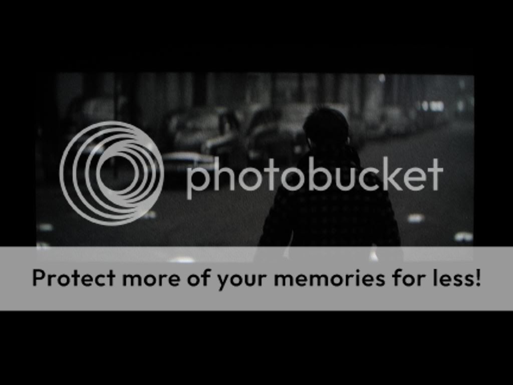

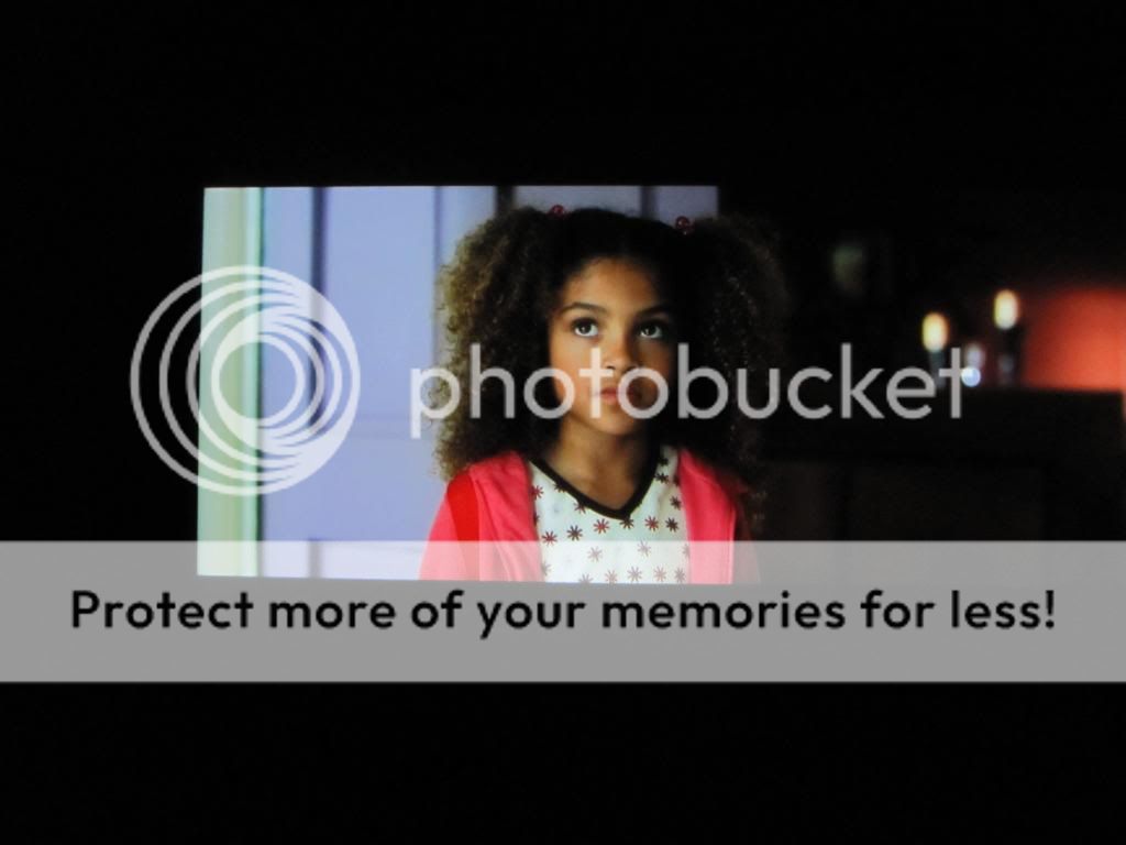

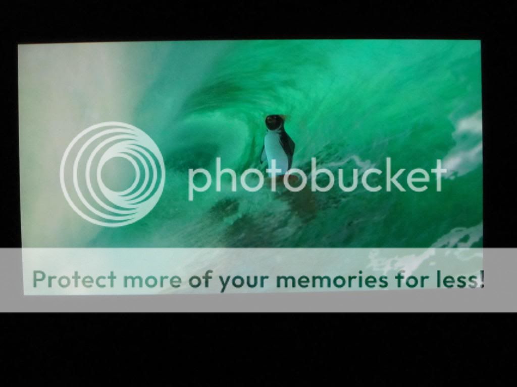

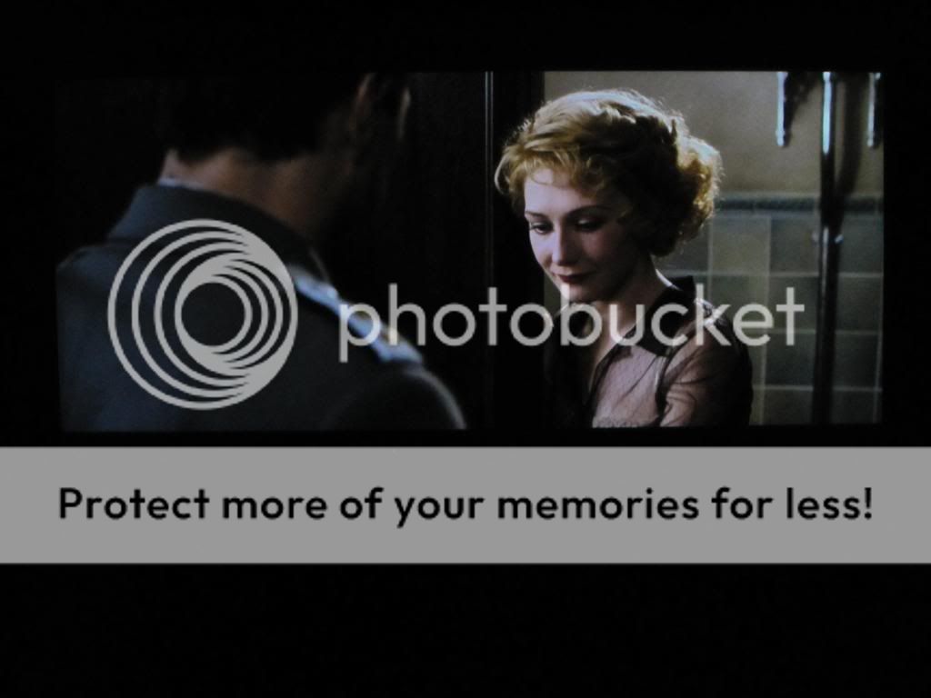

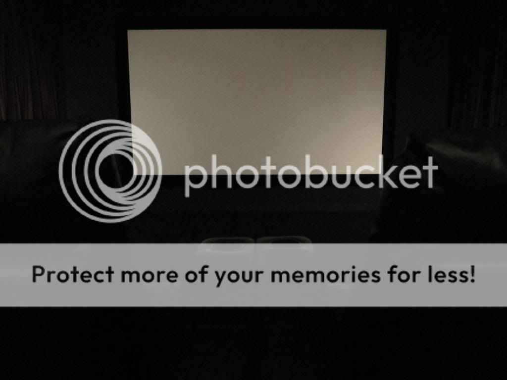

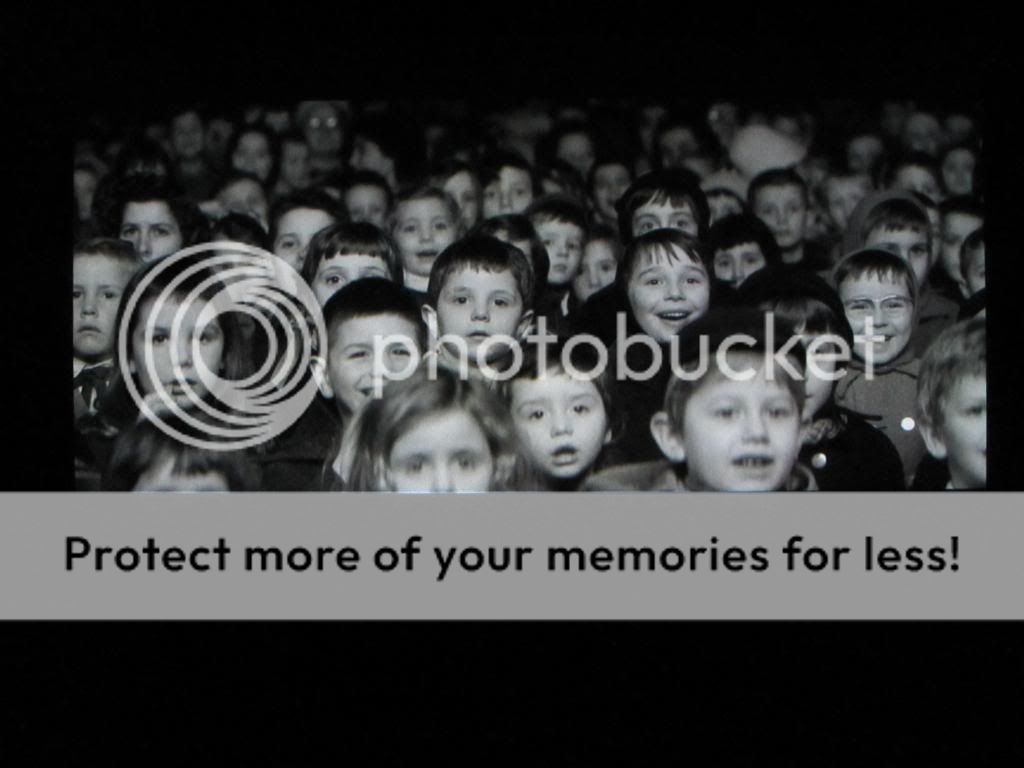

Some screenshots. I didn't even bother with long exposure, which I now know I should have. The first two are from The 400 Blows, my personal reference title for black detail. When being so taken aback by this trait, I asked around, wondering if B/W films just have some inherent advantage. Well, Josh Zyber taught me that this title is one of the rarer gems that don' suffer from artificial contrast boost, and that it doesn't really have to do with being B/W. Watching live, you can see a clear checkerboard pattern on the kid's jacket, with details of the fabric as well. In the photo you can't see jack. My point is that the PQ looks waaaay better than what I'm giving you here. Of course, screenshots are generally said to be useless, but at least they're fun. I will try to take more shots later, but with longer exposure, instead of just point/click.
From one of my favorite demo titles, Creatures of the Deep episode, from Life as narrated by Attenborough. This episode is perfect for a light controlled, large screen system.
While I still think Ratatouille remains the best as far as animated PQ, I wasn't going to skip 10 previews to take a couple of shots. So, I thought of Surf's Up instead. They purposely added "grain" to the movie to give that old school surf documentary look.
Carice because she is pretty even immediately after vomiting.

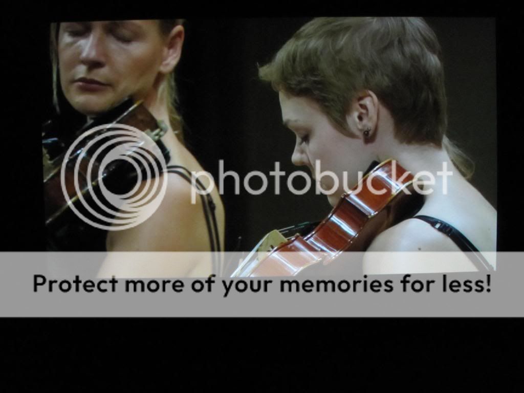

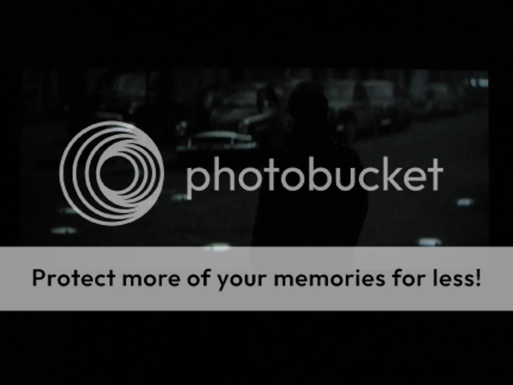

Kill Bill 1/2 are perhaps the best in PQ, out of what I own, as far as live action goes. I'm sure I have others that are on or close to the same level, but I sure can't think of anything off the top of my head that surpass them. There are better shots to be had, but I just grabbed this shot since it's so close to the beginning.

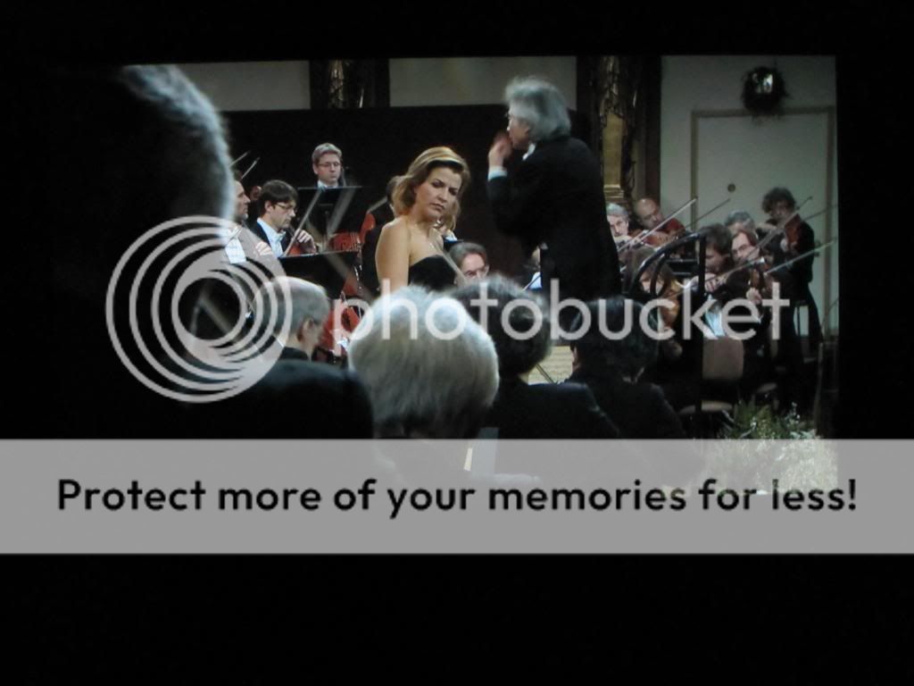

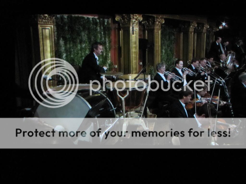

Concert BDs, I have a fair amount, but I only put in two so far. My tweeter is pretty much smack dab in the center of the screen, and it's GREAT!
Brandenburg #6.
Beethoven Violin Concerto.
Tchaikosvky Pathetique.

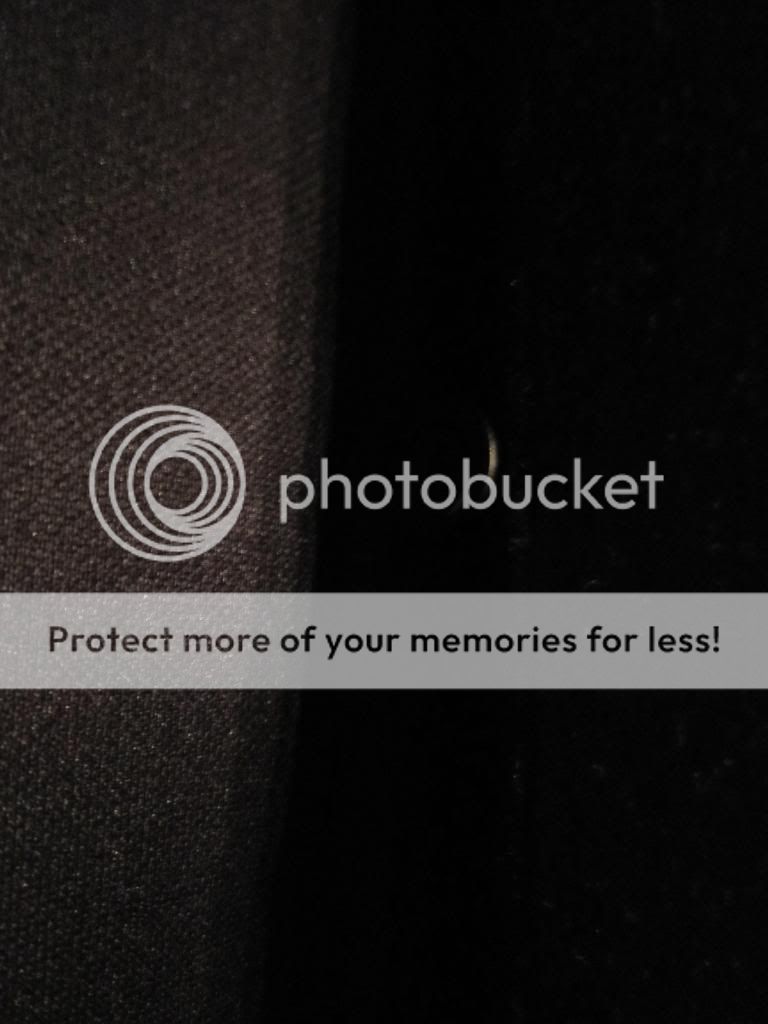

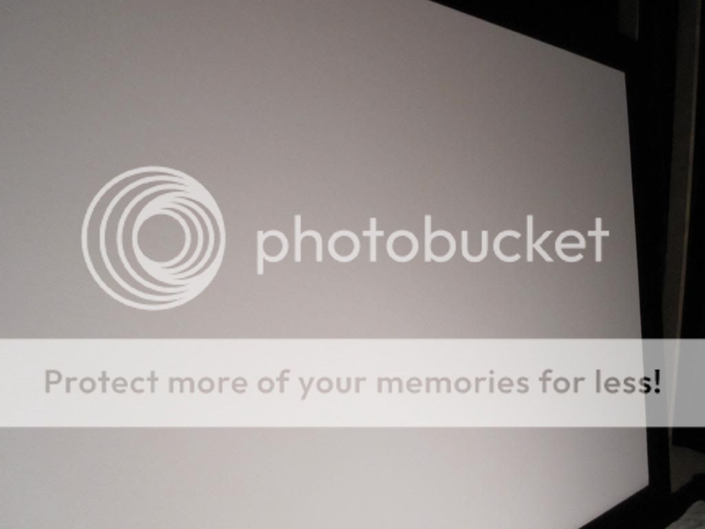

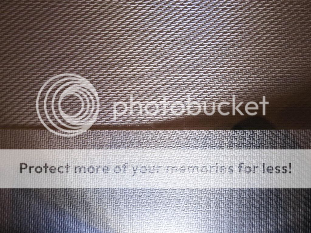

Ok, I am wondering if I have overstressed the fabric, or have damaged it permanently. Or that maybe this is normal after fixing/stretching? Hmm.
I think* Seymour said that if it's pulled too hard the holes become diamond shaped? They look square in the photo, right? I tried lining up my sample with the tilt, and you can see that the screen material is definitely more pulled apart . . .:confused:
If it's true that there is only 1% give, and if it happens to be true that I shouldn't go past that threshold, uh oh.
J
jostenmeat
OK, LOL, Chris said I'm fine, what a relief, haha. That if I take the sample and flip it around, it will look identical. Whew! :eek:

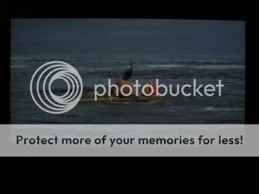

So, I tried my first long exposure shot ever. I didn't even try any other length of exposure, but only a single shot at 3.2 seconds. The bottom photo is it, the first one being the photo that I have posted here already. The mic boom and adapter that I obtained for Audyssey calibrations has now found another use in taking long exposure shots.
