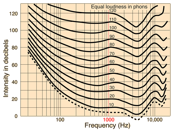

General discussion of how to interpret the Equal Loudness Curve (for those who have not had the chance to spend time thinking about it yet):
Lets say we are listening to a String Quartet. Lets say the musician played at 90dB for the performance that was recorded (obviously no musician records at one SPL, but go with it). We generally assume the musicians are going to provide a good presentation, so they will automatically be adjusting the levels to maintain what we perceive as balanced levels across the frequencies.
Thus, for example, the String Bass will be plucking a 40Hz note much harder than an 80Hz note as a matter of routine so as to make them sound the same volume to the human ear (by the curve, they need to play 9dB louder at 40Hz vs 80Hz. So, while the 90dB curve is not very flat, the musicians are automatically matching the perceived sound levels at different frequencies by ear. The musicians are generally oblivious to this aspect of their performance, but have optimized the EQ for us for the level (SPL) of their performance!
If we take this recording and play it on our system at 90dB, we will get the correct EQ for the entire performance (and the sections where they drop to 40dB will also be fine because they EQ'ed everything by ear and we are reproducing it at the same level they played/EQ'ed it by ear)!
When we adjust the volume from 90dB to 70dB, we are attenuating the volume by 20dB across the entire frequency range, but if we look at the chart, if we attenuate 1000Hz by 20dB, for the sound level to match at 40Hz, it should only be attenuated by 16dB (instead of the 20dB it was lowered, meaning an EQ of +4dB is needed at 40Hz) and at 20Hz (generally not a big deal since music doesn't usually go this low) it should only be attenuated by 14dB (instead of 20dB,meaning an EQ of +6dB is needed at 20Hz).
You can see how the slopes increase (in the bass region) as the volume is lowered indicating more and more additional EQ is needed as the volume drops.

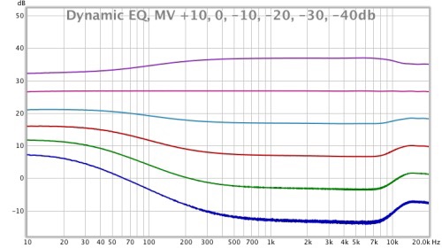

William Lemmerhirt
William Lemmerhirt
@KEW, thought you might enjoy this chart. It’s what you already know in your mind but just graphed out. It’s how Deq is applied vs different volume levels.
I knew that DEQ boosted the bass, but I don't recall this graph.
I always set my speaker channel levels (Trim levels) so that my Master Volume was usually -30dB. So looks like the 30-40Hz got boosted 10dB+. No wonder the bass was great. Haha. :D
