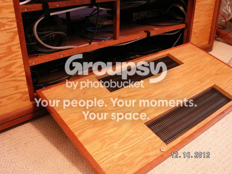

I still think you shouldn't go for a fan until you are certain your cabinet cannot passively vent enough air to deal with heat build up. ...

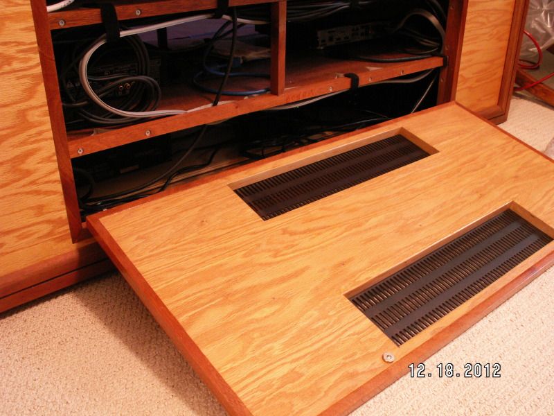

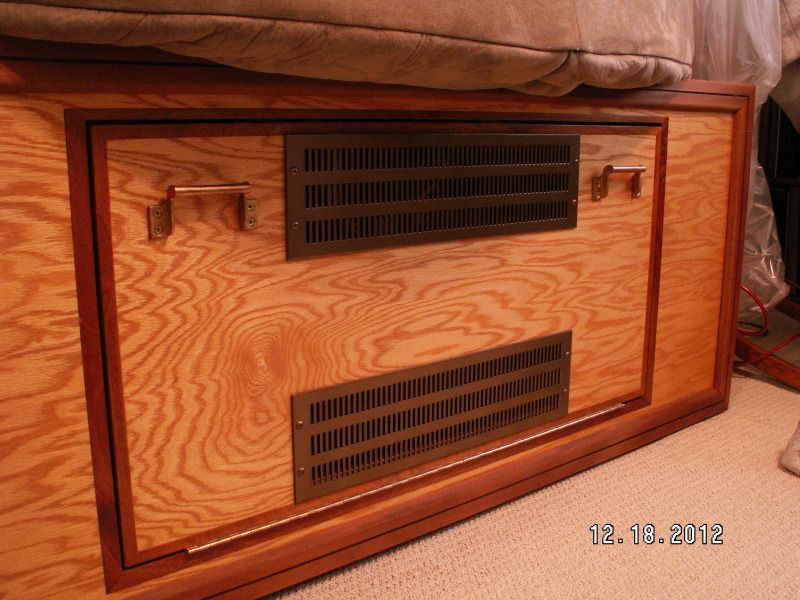

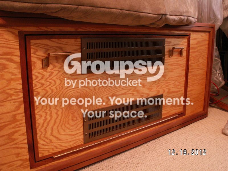

I'm in this camp too. (I also liked that interesting router work that the fan covered, and was wondering how it was done. It looked nice.) If you have to go with fans, DC fans will be quieter.
Alex2507
Alex2507
There's a certain something about people who never learn and won't listen ... :rolleyes:
... but I cut that design in with a coping saw.
The design sort of uses that little circle in the middle to support the two longest grates.
I might have made that up or copied it, not sure.

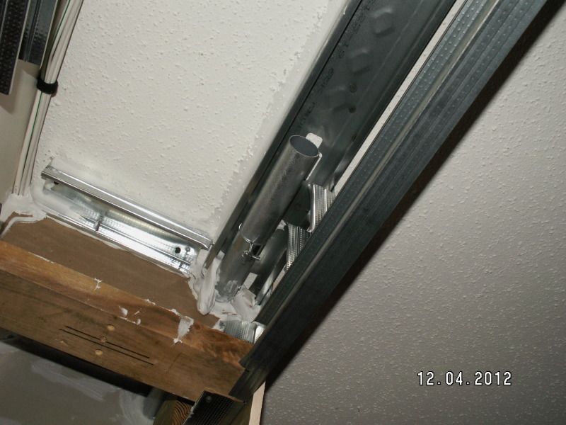

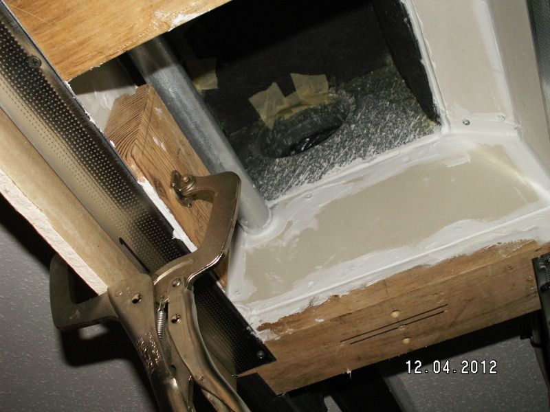

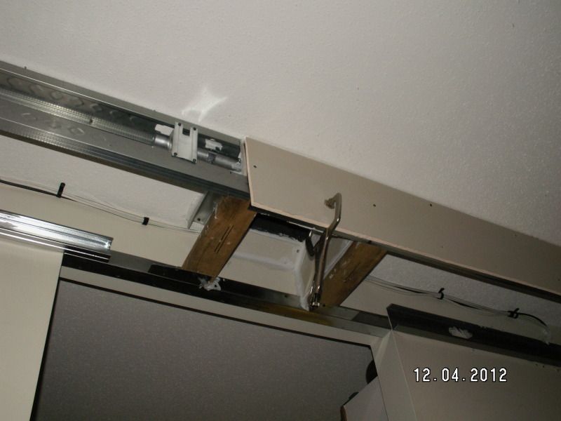

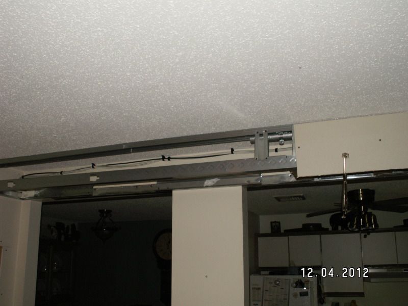

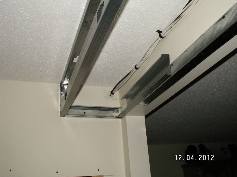

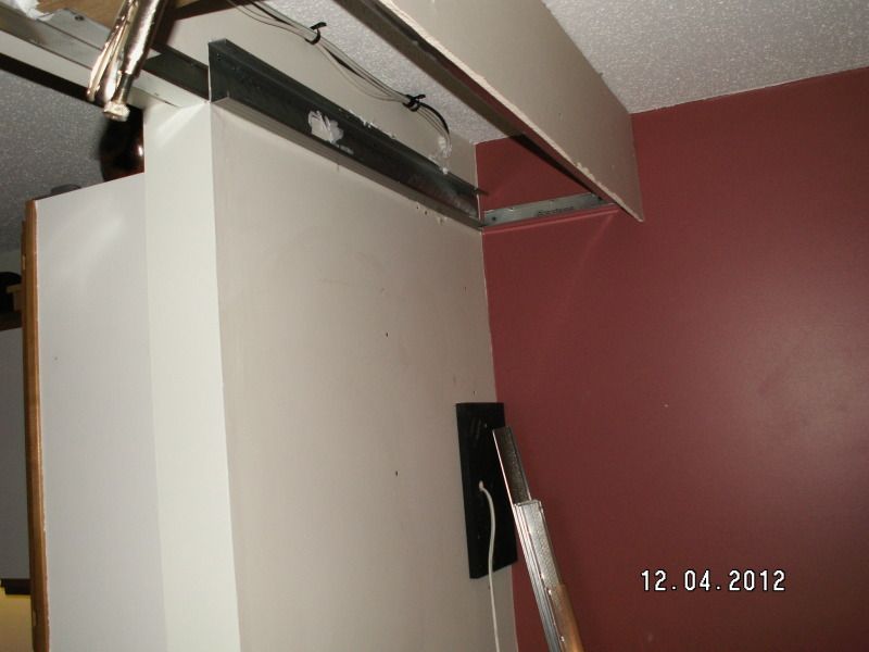

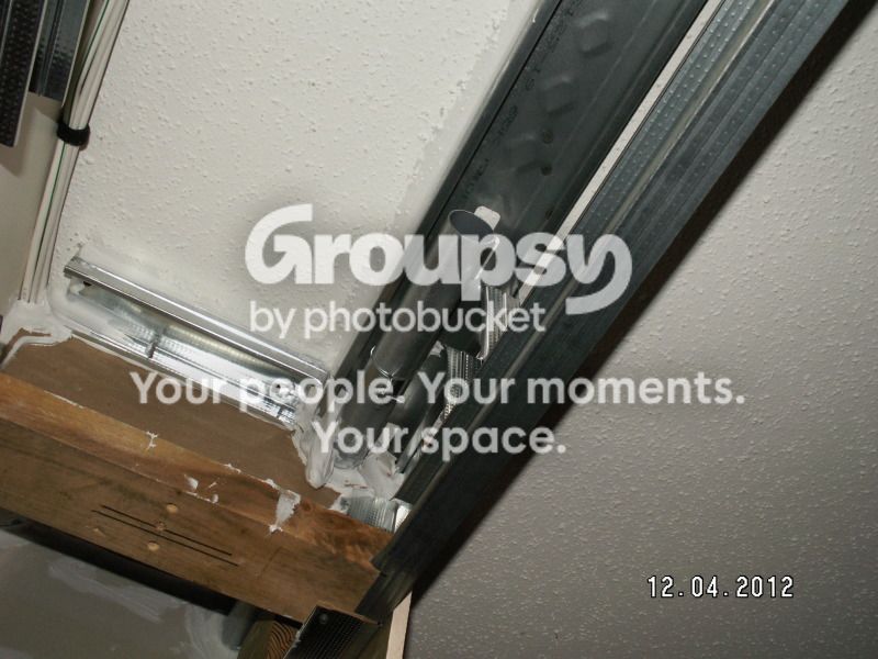

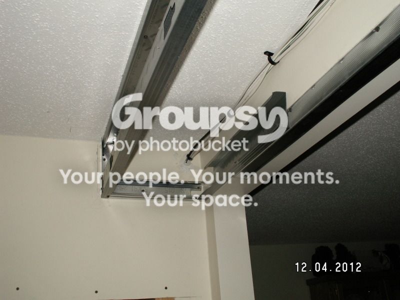

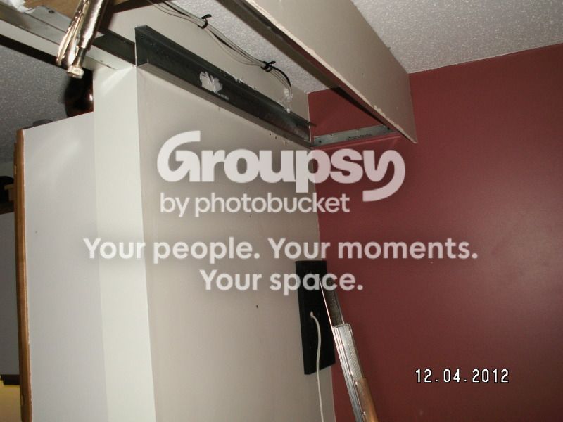

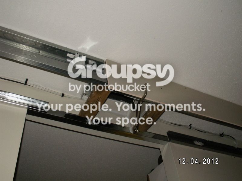

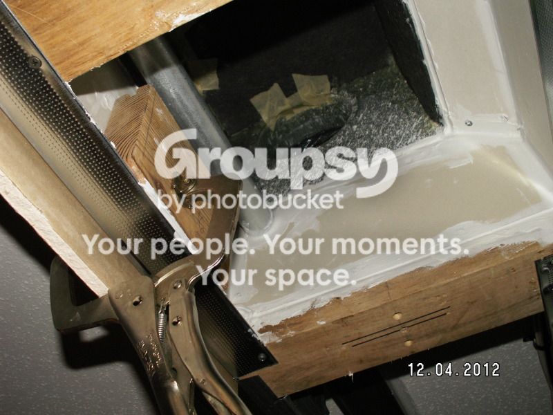

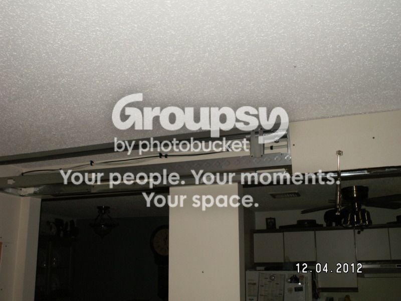

Alex, if you finished the whole job before showing any of the photos, you'd be a genius instead of a lazy tease.
I guess I'm not going to make genius. I tried though.
Yeah ... I can't make any sense of it either. Now that the duct to the diffuser has been lowered/extended to the bottom of that soffit I can set the light. Then the other side of the room gets a matching soffit and light but there's no diffuser there and I'm matching this side so it will be easier.
I'm pretty beat right now but there's some pic's.
Alex2507
Alex2507
Fixed the hole in the wall yet ?
Nope.
I need to come out of that wall with 120 volts from the overhead lighting circuit to feed a light at that I'm going to install at the end of that soffit. Getting the 120 volts from the overhead lighting circuit into the wall was a big deal. Extending that duct to receive a diffuser was a big deal in that it determined the width of the soffit. Running 120 volts across the front wall and down the matching soffit on the other side of the room is not such a big deal but needs to happen before I can insulate and close. Then we move onto tape and paint ... and then the baseboards. Never mind the ugly condition caused by leveling that soffit line at the openings.
I'll let you know when that hole is fixed. I promise.

I still say Rick and I would have had the whole thing done and ready for mud in about 45 minutes.
Swerd
Swerd
I guess I'm not going to make genius. I tried though… I'm pretty beat right now but there's some pic's.
OK, installing soffits, lowering ventilation ducts, adding 120 v AC lines, etc., all in the effort to get your audio stuff off a hope chest gets you somewhere between genius and lazy tease, leaning heavily toward obsessed genius :D.
