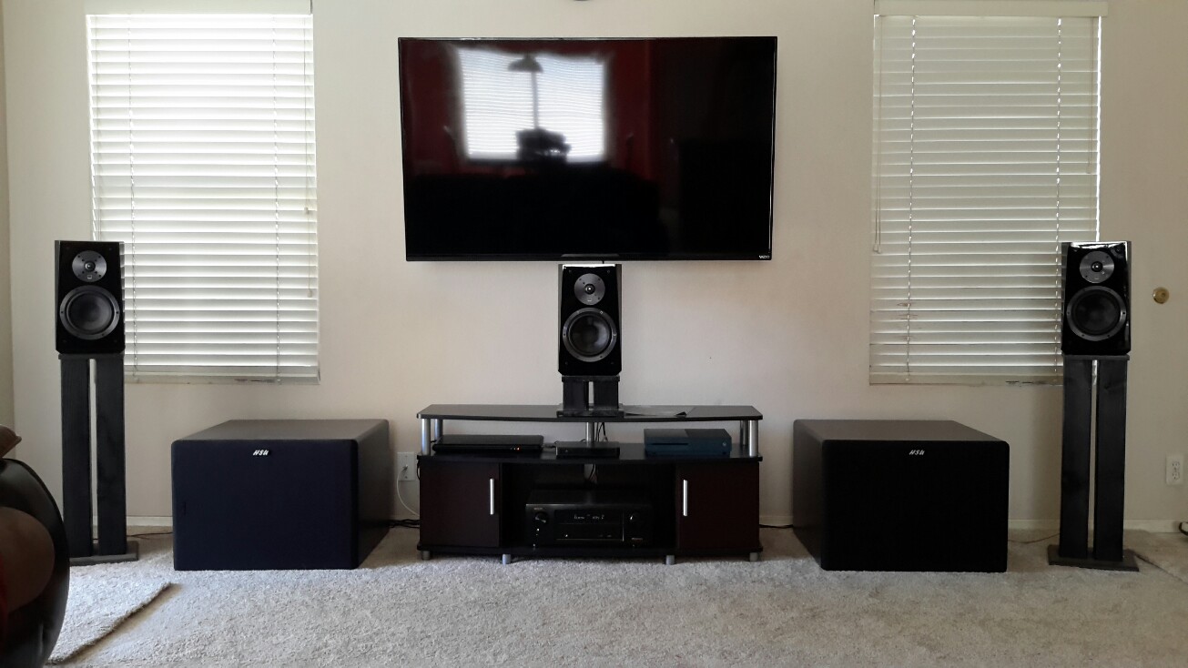

Here are 3 ultras across the front courtesy of Pogre:
Pogre
Pogre
Hey, that looks familiar! :cool:
I like Kurt's suggestion. I used those Ultra bookshelf speakers as my mains for quite a while before I got the towers. If you can, a bookshelf will make a better center channel, but not a lot of folks have the room, so we have dedicated center channel speakers.
I love my system. I came into a nice little windfall a little while ago and had some fun money to spend so I got a separate amp and the tower speakers because I could! If I'm being honest though, it wasn't a huge improvement. I *think* (placebo, anyone?) I have a little bit more presence in the midrange, but the real gains with the towers will be better bass extension. If you have subs that negates those advantages and makes getting bookshelfs a pretty compelling option.
The towers sure are purty tho...
