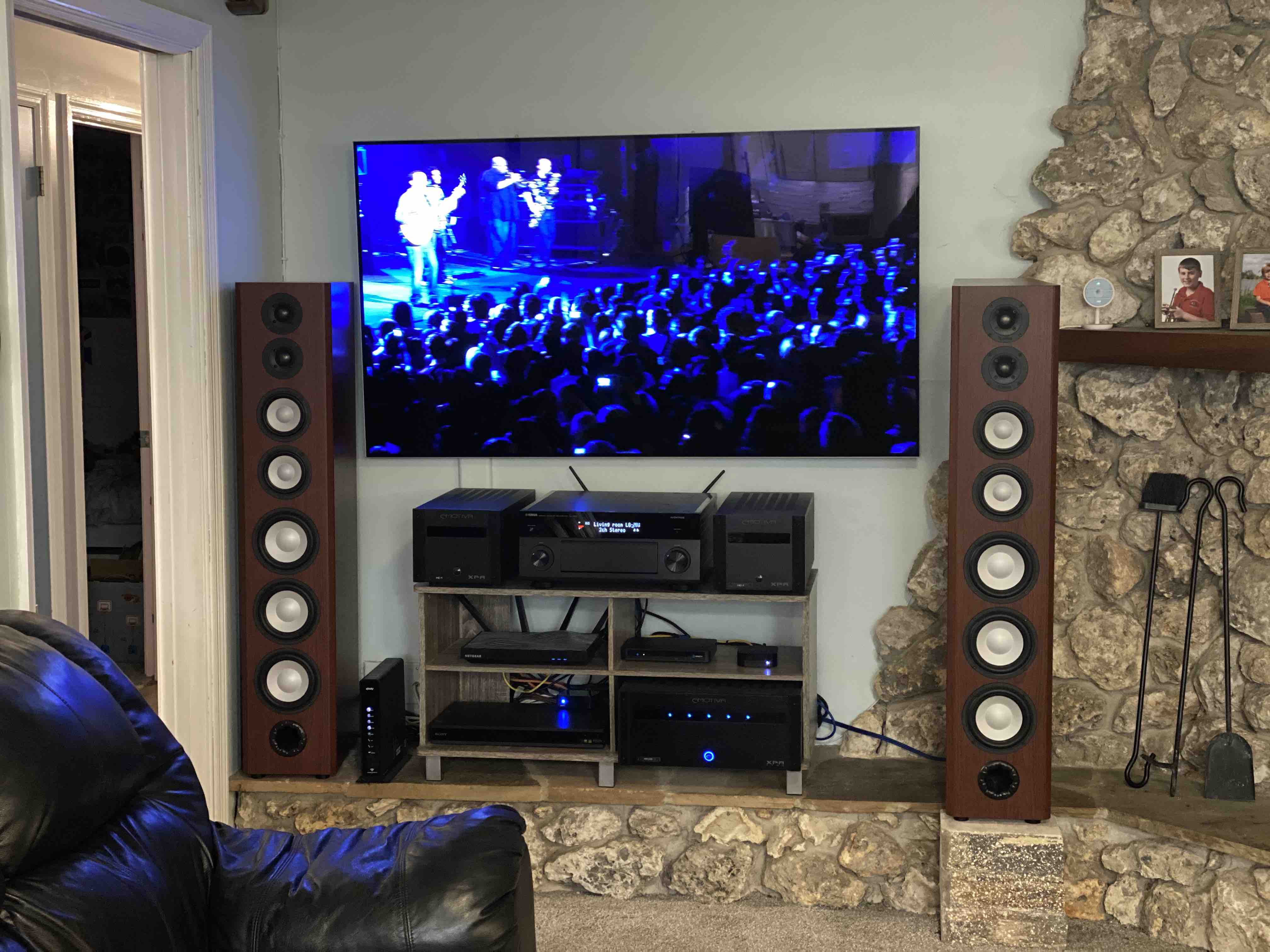

Hey guys, while hooking up two new Emotiva mono blocks (XPA HC-1) to a new Yamaha 5200 processor, one of them wasn't pushing my front right very well. I power cycled and now it won't turn back on. The power switch on the back seems to be a momentary switch now. The other mono works fine. Is this a common problem? I guess it's just a brand new bad apple from the factory? Really frustrating. I was hoping there maybe a method to resetting the master power switch.

It is not the switch. The amp is kaput, and shutting down due to a serious internal fault.
You will need to return the amp. Let us know how you get on. There has been a lot of complaint on here about poor quality and even worse customer service with Emotiva.
If you still can, I would return both and get something else.

Well, it's brand new out of the box, first use. Hopefully they will exchange it.

OK, let me be blunt. Return them both or you will soon regret it. Emotiva offer no service at all after the warranty period. They did that to Gene owner of Audioholics, and other members. I other words you need to drop those two amps like "Hot Potatoes".

By the way a question to the OP. Those speakers do not look like B & W 702 s2s to me. What are those speakers in the picture? I ask as they look as if they could present a really difficult load. I see in the Emotiva warranty that it is void if the speakers drop below 4 ohms. Those speakers look as if they likely could.

They are Axiom speakers. Looks like the M100. Really sorry to hear about your amp troubles. TLS and others are giving you good advice though. I know it's a PIA, but if you can return them and cut your loses, that might be a good idea. But Emotiva has to take care of you either way.
Axioms, I think?
Yes, you are correct. They rate them as four ohm, but with that driver configuration they have to be lower. To be honest they do a really good imitation of something that fell of a white van! That is no way to design a speaker however you cut it. I bet those are the reason his amp blew up.

Given that the amp failed right out of the box, I doubt it was the speaker. It's just the bathtub curve of reliability, if something is going to fail, it is likely to happen either right away or way down the road. I agree about the speaker design, it is a mess, but it is possible, depending on the driver loads and how they are wired, that it isn't all that bad as an electrical load.
It may or may not be an difficult repair. It could be a blown output device, or just a bad relay, or loose connection. In any case, Emotiva should replace it if it is within the return window, or if not, fixe it on warranty. I hope they will pay for shipping, though it weighs only 28 lbs boxed so it wouldn't cost a fortune to ship.

When you wrote that the switch is momentary, are you referring to the little round button (the circuit breaker), or the power switch? Have you tried pressing the breaker to reset it?
Have you disconnected the speakers and tried to turn it on?
