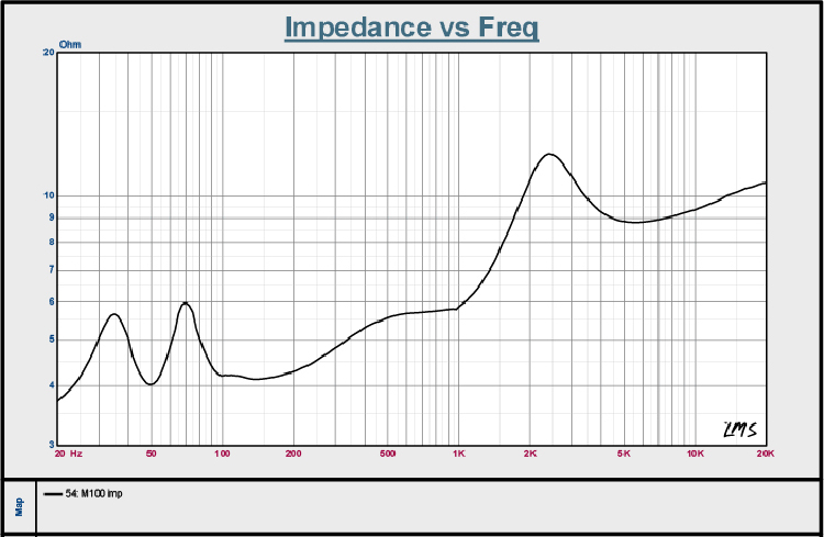

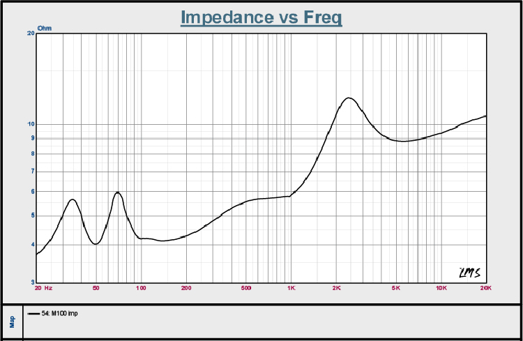

Not just rate, they measured 4 ohm too, in fact its the minimum so the nominal impedance should be higher. The reviewer said:
Axiom M100 Floor-standing Speakers Review - HomeTheaterHifi.com
"The impedance is of particular note. The fact that the impedance remains above four ohms for the entire audio band (ignoring the tail below 20 Hz.) means that the M100s should be an easy drive, even for AV receivers (not normally known for their four-ohm performance).

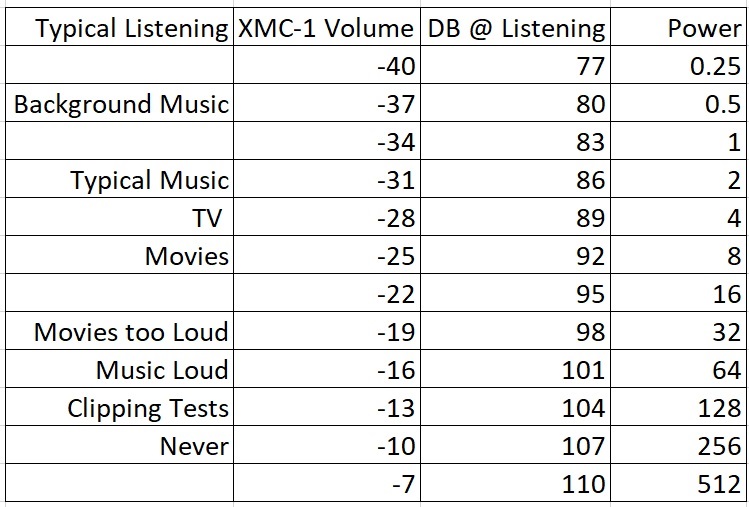

At first, I thought that I would clip these amps. When I had one AHB2, I watched Aquaman UHD BD plenty loud, the Salon2s running full range.
During the Kraken scene, the Salon2 woofers were really moving but there were no clip indicators. These are implemented with a Spartan 6 FPGA and are very sensitive.
Into 4 Ohms, the AHB2 produces 180 WPC, that is 1/2 the power of the ATIs.
After that, I decided to measure the volume from the Salon2s when playing pure tones at 2.83 volts at my seating position. This was Volume -31 on the XMC-1.
That results in the following power requirements:
I can clip these amps but not any any level listening to music or movies that I find enjoyable.
