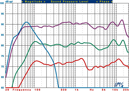

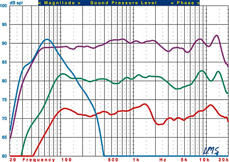

Here is the a9 and the center (purple trace and green trace respectively)
The A9 has a has an eleveted midrange which is considered warm
The CS looks pretty good until around 2.5khz which is at the top of the female voice fundamental range where harmonics take over out to 17khz. Both speakers will have issues at that range, but not horrid (again subjective for most) and require boost to transition from the area below 3k to get it a little flatter.
