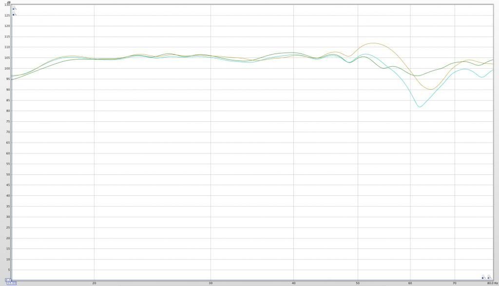

fuzz092888 Audioholic Warlord Feb 13, 2012 9,103 0 113 42.3464° N, 71.0975° W Apr 14, 2013 #45 After some more help from the ever patient Dr. Mark with the EQ and a little room correction courtesy of REW and MiniDSP this thing sounds amazing. The bass is deep and tight, but obviously needing more power. I don't think I'll need the 4000 watts per driver for my space, but I'm definitely looking into getting somewhere in the 1500-2000 per driver area. So now both DIY subs I built are functioning like a dream and I couldn't be happier with how they turned out. At this point I need to give the speaker projects a break and turn to some house projects:building a new computer desk, adding a walk in closet to the bedroom, and possibly a new front deck type entrance (not nearly as big as it sounds). In the meantime I'll be thinking about how I want to finish them. I'm thinking about veneering one and HVLP painting the other so that I can get a little experience in both methods. The best part is being able to check off two projects from the list. Now I'm slowly but surely moving towards building a pair of speakers, which should present new challenges, but more fun.

TLS Guy Audioholic Jedi Oct 30, 2007 27,288 0 113 79 Eagan MN Apr 14, 2013 #50 fuzz092888 said: After some more help from the ever patient Dr. Mark with the EQ and a little room correction courtesy of REW and MiniDSP this thing sounds amazing. The bass is deep and tight, but obviously needing more power. I don't think I'll need the 4000 watts per driver for my space, but I'm definitely looking into getting somewhere in the 1500-2000 per driver area. So now both DIY subs I built are functioning like a dream and I couldn't be happier with how they turned out. At this point I need to give the speaker projects a break and turn to some house projects:building a new computer desk, adding a walk in closet to the bedroom, and possibly a new front deck type entrance (not nearly as big as it sounds). In the meantime I'll be thinking about how I want to finish them. I'm thinking about veneering one and HVLP painting the other so that I can get a little experience in both methods. The best part is being able to check off two projects from the list. Now I'm slowly but surely moving towards building a pair of speakers, which should present new challenges, but more fun. Click to expand... Nice work, glad you are pleased with it. I warned you it would be a power pig. That is a brute force design if ever there was one! Reactions: fuzz092888

fuzz092888 Audioholic Warlord Feb 13, 2012 9,103 0 113 42.3464° N, 71.0975° W Apr 14, 2013 #52 TLS Guy said: Nice work, glad you are pleased with it. I warned you it would be a power pig. That is a brute force design if ever there was one! Click to expand... It certainly is! Now that I've tried it the brute force way, the next sub will definitely be a Dr. Mark way. Took a few measurements after I ran the REW RC. Here's what it looks like from the 3 seats on the couch from 15hz to 80hz, which is at or above the crossover to my speakers. Reactions: Steve81
