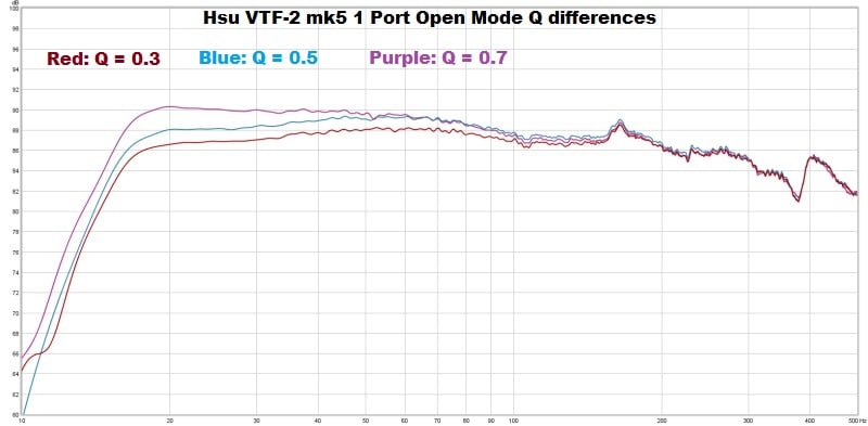

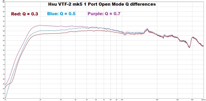

Idk. That vtf curve looks a lot nicer to me.
That is the curve the manufacturer put out. Here is what I measured:
I think both are nice subs. I would say if you prefer front-firing, get the Hsu, but if you like down-firing, get the Outlaw. Both are fine companies. They will be so close in performance that this is one of those cases where you should purchase based on looks!
