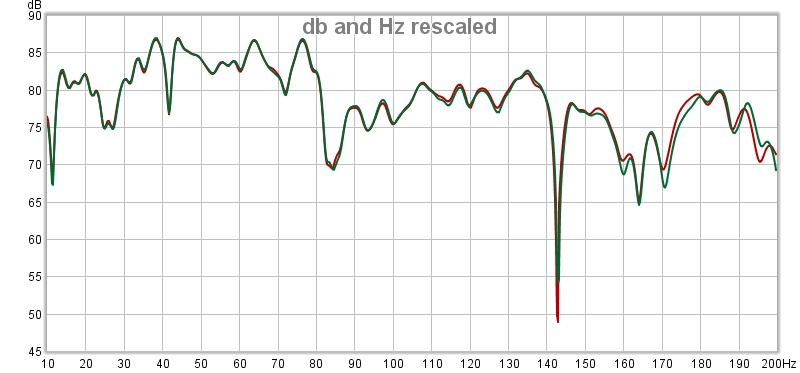

Audyssey only.everything in the sub is turned off.
Ok. This should do it.
Okay, that looks like no smoothing, which is good imo. Really let's you see what's going on. It looks like your baseline or goal is 75- 80 hz? If that's the case then you can do mostly cuts to flatten that out. That one sharp dip will likely disappear with some mild smoothing.
I'm sorry, but you gotta refresh my memory I forget which sub you have. Is it a HSU VTF3 MK5? If so HSU recommends running room correction in EQ1 with 1 port open.
And I hate to do this to you but I'm gonna be busy for the rest of the night starting soon so I'll probably not be able to get back to you tomorrow. Let me just say that you are on the right track, you figured out how to do a successful sweep and it looks right. Your bass response could use some work, but it's not too awful bad. I think you're going to realize some nice improvements.
