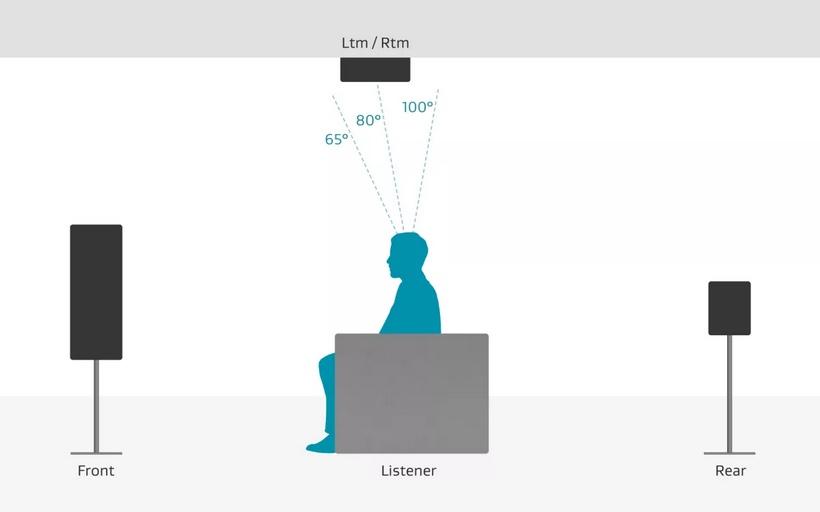

Just a thought since you have ceiling speaker already you could add real surrounds and go 5-1-2 would seen to fix some of the issues I would think .
John Lohmann
John Lohmann
Thanks for your input, Mark.
We definitely considered that, as it was suggested by more than one person. The issue is that we simply can't add bed-level surrounds to this setup based on the room layout and couch positions; it has to stay 5.1 in this house, at least (possibly 7.1, as we have extra in-ceiling speakers that can be moved to behind our listening position, but still in the ceiling, of course).

Another problem is that depending on where the current surrounds are, they might function very well as overhead speakers. A single pair of overhead speakers should be just in front of the lister by roughly a couple of feet.

The way the room is set up, these in-ceiling surrounds would still be pretty much right over our heads if we used them for Atmos channels (adding the ear-level bed surrounds).
Ok that would probably be close enough. For some reason in my mind they were farther back.

Oh; I was thinking this WOULDN'T be an ideal setup. So if the bed-level/ear-level surrounds were added, the two overheads could be pretty much right above the listening position?
If we went with a standard 7.1 setup with the two extra in-ceiling surrounds, yes, those would be further back.
Well not ideal but close enough to the spec.

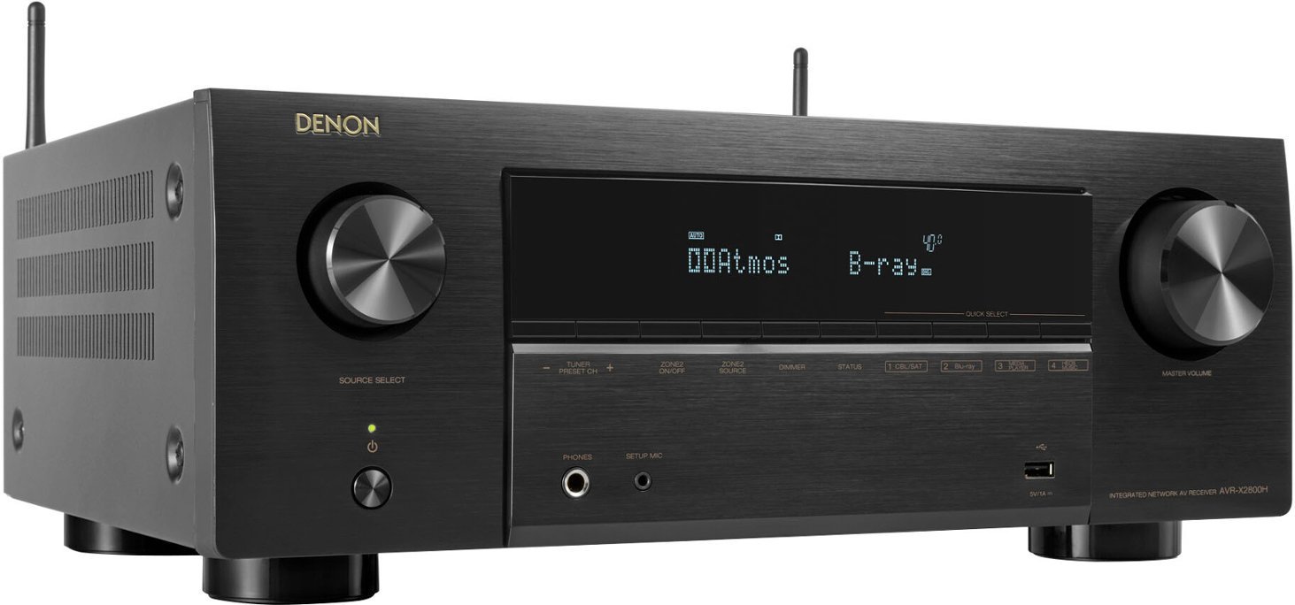

The biggest issue for me is the fact that Voxx/Sharp/Premium Audio Company or whatever they're calling themselves now removed the way the Onkyo displays show information on them, specifically with regard to codec/sound mode. In the past, you were able to see the name of the input ("DVD," "Cable Box," etc.) AND the surround codec in use ("DTS," "Dolby D," etc.) AT THE SAME TIME. These new models only show the input name and volume number constantly, unless you press the "i" button on the remote, after which you could scroll through different layouts until you see the sound mode being used. However, the screen goes back to the input name and volume after a few seconds...that's absolutely ridiculous, and something so many Onkyo fans have complained about. There was even a petition on AVS signed to get the company to fix this through a firmware update, and I have spoken via email to at least two reps from Premium Audio about it...I don't think they even care.
What's sad is that there is SO much room on the AVRs' front displays -- especially the RZ models -- to incorporate both the input name AND codec, so I don't know why they dropped this. They also removed the helpful "IntelliVolume" input leveling system, which was a big head-scratcher; I mean, Denon still offers this on their models, though they call it "Input Level Adjust" or some such name.

I totally agree about the displays, and believe me....I HATE looking at my 2800's front readout when checking to see if it's processing codecs properly. It's almost making me want to put my old Onk 605 back in, just for that...
