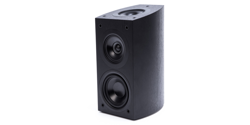

The towers look flat
I agree. I don't see an angle in the towers or bookshelf. If there is an angle, it's very slight at best and certainly won't beam as drastically off axis like the diagrams suggest.
herbu
I suspect they would say the shaded area/path in the diagram simply highlights a subset of the actual sound for illustration purposes. How much/strong/focused it is within the shaded area is tbd, but critical to the effect.

Could it be that AJ did some crossover magic (for the top driver) to intentionally have main lobe directed towards the ceiling? Almost like an an anti D'Appolito, with weaker lobe directed to tweeter axis. Now the lobes being frequency dependent, I don't know how well this idea would work in practice.

No. Possibly to some extent with the DSP processing in Atmos itself but I see nothing that indicates the sort. Being able to angle the driver to a specific location on the ceiling would be a benefit that nobody is currently exploring. Stay tuned for my article.

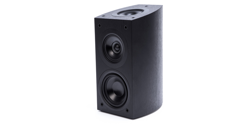

Definitely angled.... (EDIT: Click on pic)

Amazing what a real picture can do.. Thanks
Yes Andrew Jones emailed me to confirm the top baffle is angled but left/right speakers are identical.
