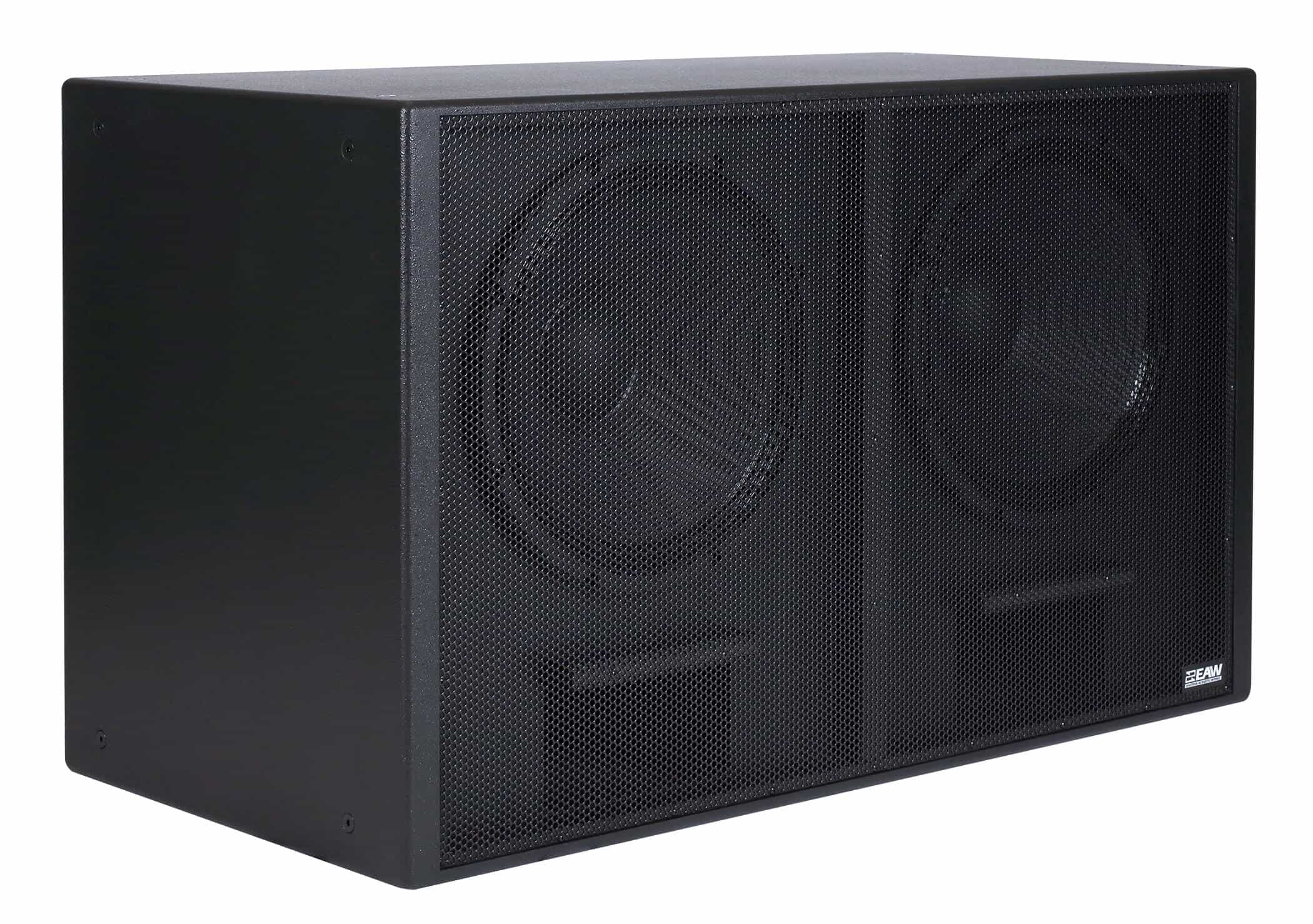

I wish I could hear a live sound sub....do they dig deep or just play loud? To be honest, I am looking for something that will rattle the rafters,"seriously"... will the live sound subs connect to my denon receiver?
Pro audio subs don't really play that deep, but do have very loud output at 40 Hz and above. Not much of your music have content below 40 Hz, for example, that "I Shine" tune you like, I just took a look at a spectrogram of it, and its deepest bass fundamental is around 40 hz. If you want something that will play very deep and very loud, I would look at the JTR subwoofers mentioned in the above posts, or take a look at this article. Those subs are not cheap though. As for connecting to your Denon, some live sound subs are powered, and some will need you to add an amplifier. If I were you, I would stick with powered subs. They mostly have protection from over-driving, whereas a passive sub will have no such protection. If the SVS subs did not have strong limiters, you would doubtlessly have destroyed the driver in yours.

The subs from Reaction and the pro-audio subs will majorly outperform the PB13 Ultra for your purposes. The PB13 digs deep and is very clean, but it doesn't get that loud.
