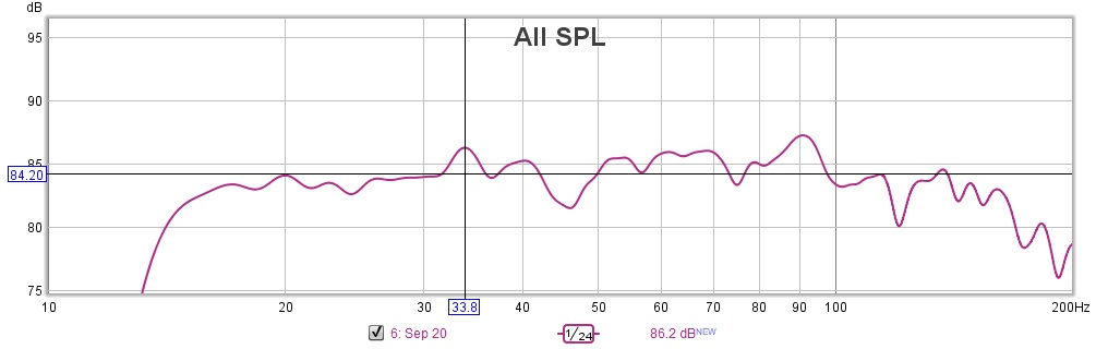

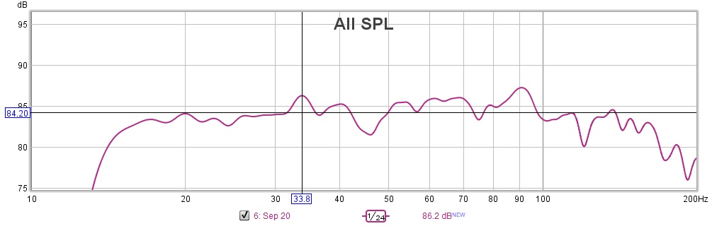

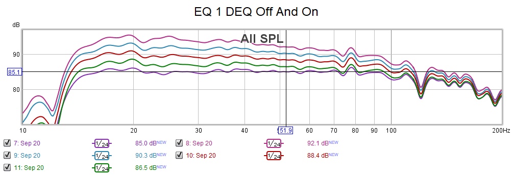

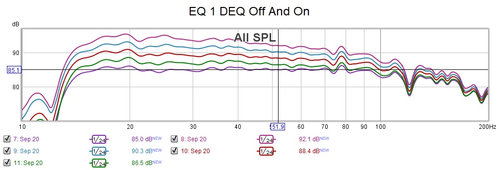

This is where Audyssey got me. It's actually a little bit better than I expected.
That's much better than the "before", which I forgot to save, damnit. No tweaking with the app either. I flattened most of that out to about +/- 2dB with REW and a Mini and because Audyssey did some of the lifting first it was pretty quick and easy.
