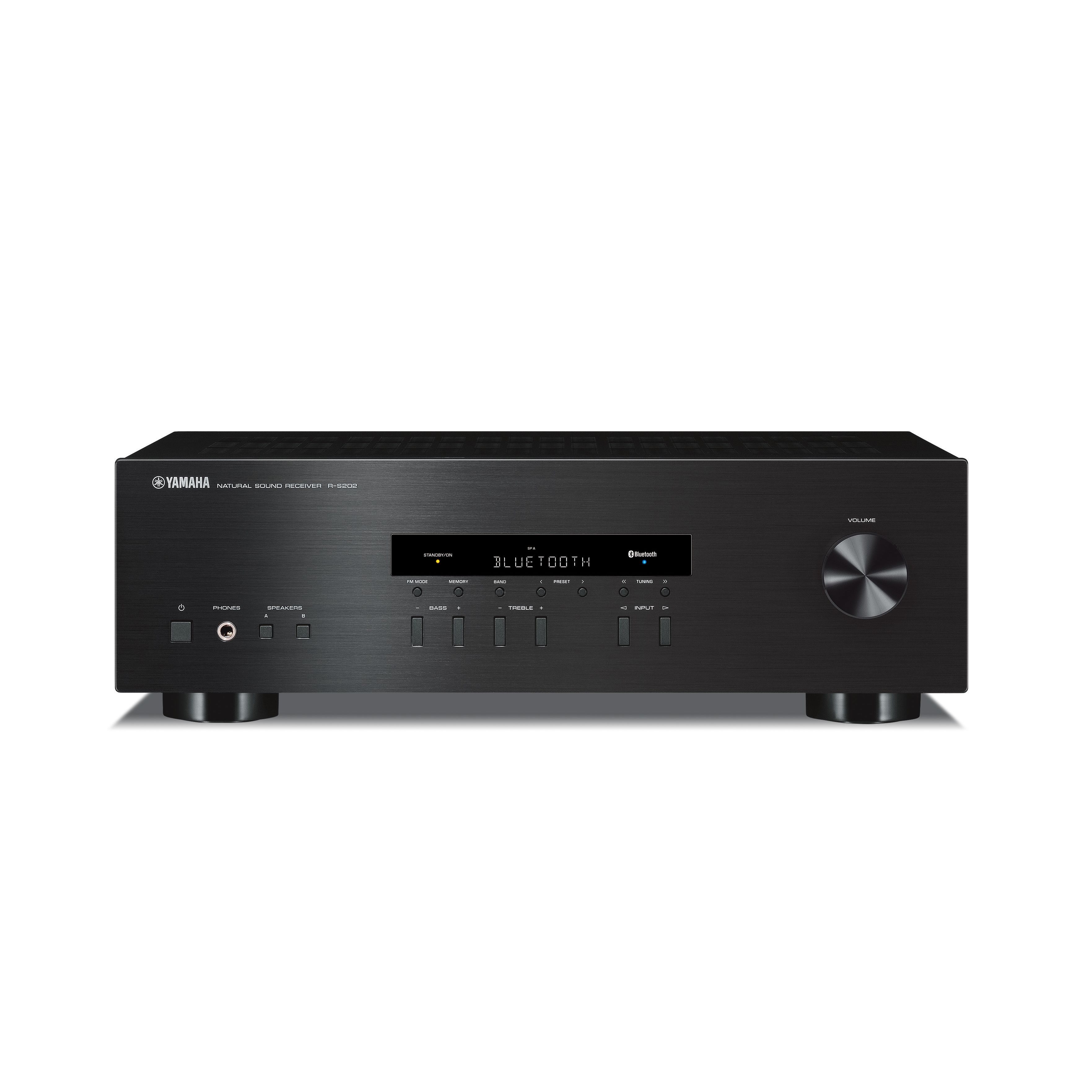

For example, I looked at the the Yamaha R-S202
It doesn't even say if the FM is digital or not. Can I assume that a receiver like this is digital FM or do I really need to find ones that specify so?

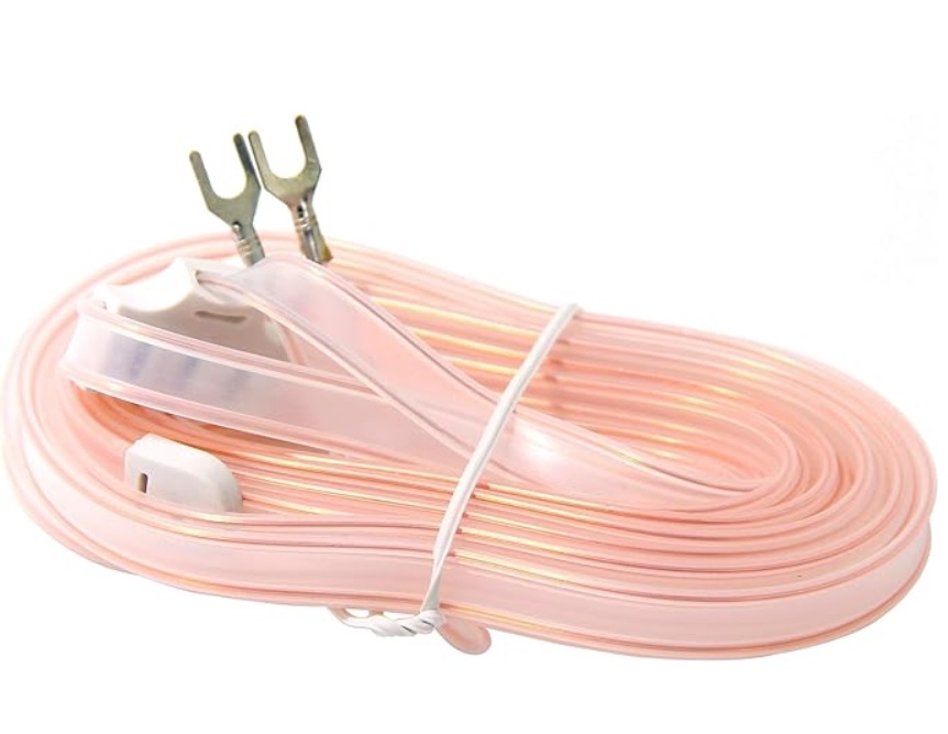

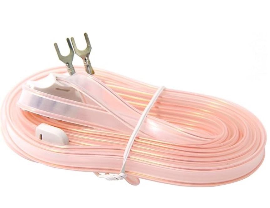

I do have a regular antenna like this attached.
It's not about static, dropouts or an obvious tuning problem. The stereo is on the north side of the house facing the city where most of the channels are coming from.
I can't really put anything higher up. I could get a better antenna. But I can't really describe what makes it so horrible sounding to me and to one of my sons. My wife and the other son don't think anything is wrong with it. Perhaps it sounds very compressed as in lack of dynamic range.

It is not inherently bad, just hard to execute properly. First is to get a good signal to the radio, receiver or tuner. If you are fairly close to the transmitter a good loft/attic dipole will surface. This can work up to 20 to 30 miles depending on terrain. Distances greater than that require roof arrays.
The type of antenna pictured above will not give quality reproduction.

So that antenna I have may also be junk. I can't really put an antenna anywhere but on a bookshelf in back of the TV and stereo in the living room. I don't know what to get though. There is so much crap on Amazon I wouldn't know how to weed out the crap.
