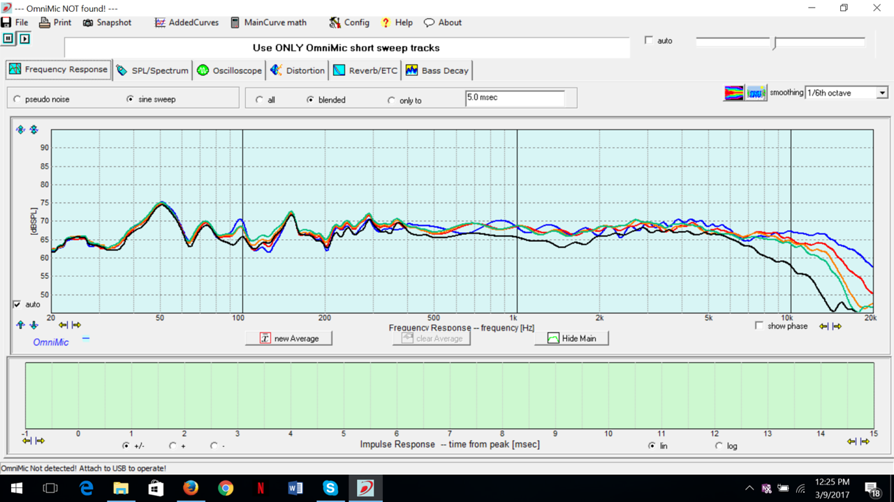

The dispersion of the speakers is excellent. The black line is right out at 90 degrees.
This is the waterfall plot.
You can see at 2.5 KHz the crossover is not quite perfect, they never are, but it is very good. The vertical dispersion is obviously controlled, which is what you want as that reduces room problems from ceiling and floor reflections. Great care was taken with the crossovers and I followed Joe D'Appolito's teachings on MTM to the letter in the design. I used George Augspurger's mathematical model in the design of the lines.

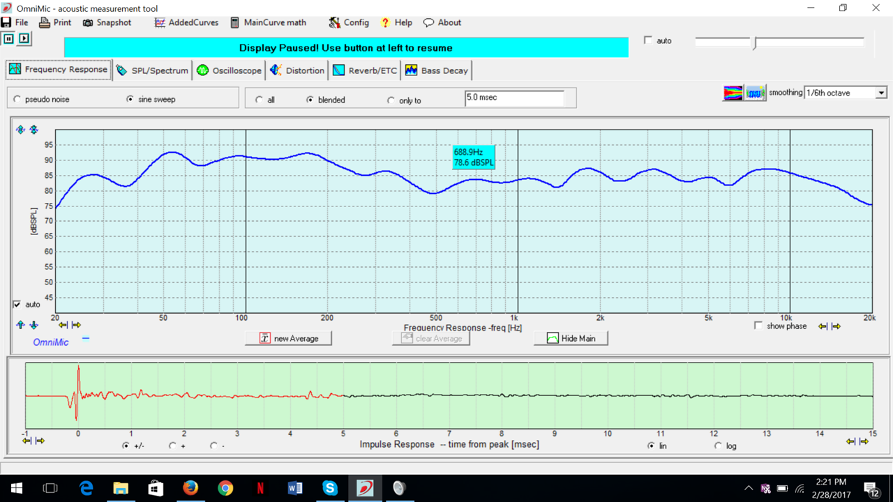

This is the FR in the rear center listening position both speakers operating
There are no special room treatments and no room Eq. There is nothing amiss above 35 Hz. There is a rise to 27 Hz from 40 Hz but this just gives a little reinforcement to the 32 ft stops! It does nothing unpleasant.
