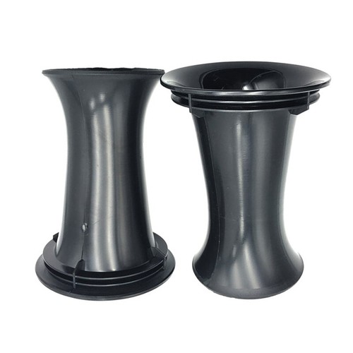

Hi TLS, I’m having trouble finding adequate vent pipe for the design you sent me. It’s meant to be flared on both ends with 2” internal diameter and the length 6.766”. I don’t know how accurate it has to be. I found similar on ebay but don’t know if it’s good enough. Seems like the narrowest section is close to 2” but the length is only 6.3”. Alternatively, I can have a crack at doing my own but I’d rather use something professionally made. Is there perhaps a site I could order one?

Homemade works nice if you add a secondary layer inside the cabinet to hold the PVC flush against the back and then do a round-over with the router. Can also flare the inside over a metal bowl by heating it with a heat gun if you need the other end flared.
List of port tubes on Parts-Express:
https://www.parts-express.com/search?keywords=port tube&order=relevance:desc
https://www.parts-express.com/Precision-Port-2-Flared-Port-Tube-Kit-268-348?quantity=1
Adjustable port kits can be cut to length and glued with ABS pipe cement. The plans should state whether the length is for a flared port or not (flared ports need to be longer).
It was a good thing that you raised this issue. For some reason the program had a glitch. That 2" port did not look right. I rechecked it and it should be 3.5" in diameter, and 21" long with two flared ends or 3.5" diameter 19 3/4" long with two flush ends

Thanks for letting me know before too late, at least while I have access inside the box. Ok, that pipe will have to be bent upwards. I see what I can find locally .
Might look around at parts-express.com

I found 3.5” pipe in the local plumbing shop. Just hope it won’t change things drastically since the extra volume of my box originally allowed for 2”x 6.7” vent pipe. 3.5x 21” is quite a difference.

That should be fine.
