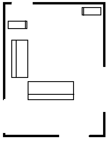

Thanks guys, clearing out some space for them, going to move some things around a bit, wife is being very flexible with me moving things around a bit. I plan to put both subs in the front of the room but have them 90 degrees from the listening position, because of a doorway I can't get one of them to face to the listening position so was going to have both facing each other on opposing sides of the front of the room. I want to have easy access to the ports so I can unplug them for movies. I figure I should be able to adjust phase if needed right?
The only real way of where to put the subs is by using REW and measuring the results. I have just recently dialed in a 3rd sub in my greatroom which is an acoustic nightmare in terms of even bass response. The locations would fool you.

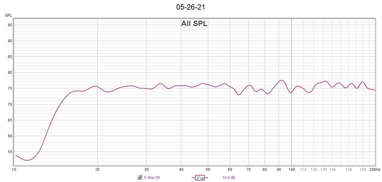

Just for example, I have 3 big ported subs in my room and there's zero bass bloat.
I'm +/- about 2 dB from 16 hz to 200 hz with 3 big ass ported subs, all wide open. I have a pair of HSU VTF-3 MK5s up front and a RBH SV-1212NR behind me.
