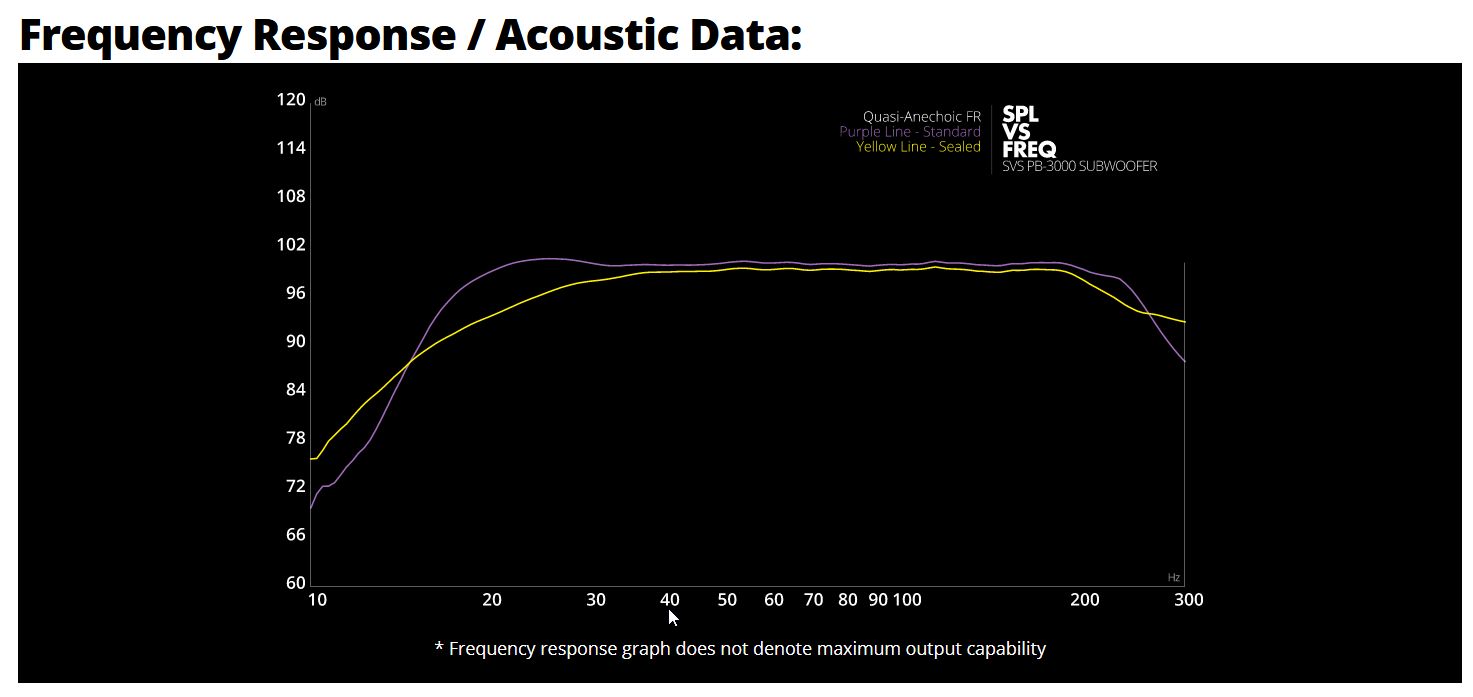

Below is the graph for the PB-3000 in sealed and ported mode. The SB-3000 (available in gloss) will have a graph similar to the yellow line. You can see that the ported version in purple has deeper bass extension. You could have gone with two sealed units, but there would have been a trade off. The ported version goes deeper, so they generally recommend those unless space requirements restrict you to something smaller.
Just to add to this. The PB in sealed mode will have slightly more extension, and output than the SB3000 due to the larger cabinet. It’s just more efficient and sensitive.

Just to add to this. The PB in sealed mode will have slightly more extension, and output due to the larger cabinet. It’s just more efficient and sensitive.
Yes, it will have slightly more LF extension, but less output as sealed as it's going to lose the advantage of the port at the same frequencies where both configurations operate.
However, if the sub is placed near a corner where there is too much LF room gain, by sealing the cabinet, there is a reduction of output at some frequencies that might help balancing the overall performance over the fully ported setting.
Well actually Ed is the one who told me that it will have more output also, so I kinda have to believe him. I think it would only be a couple DB.
No, that's impossible. I know how speakers operate and I've been building them for over 50 years. Your friend doesn't have the knowledge. Any woofer or sub in a ported enclosure will produce a higher output than in a sealed box at low frequencies down to the box tuned frequency, and even lower in accordance with the laws of physics, period.
I’m sorry. I think you misunderstood what I said.
I totally agree. Ported subs will always have more low output than a sealed one. My point was running a PB3000 in sealed mode would have more output and extension than an SB3000. Even if it’s only a couple db. And my friend is Ed. Ed Mullen. The chief technical adviser at SVS. The one who builds those subs.
