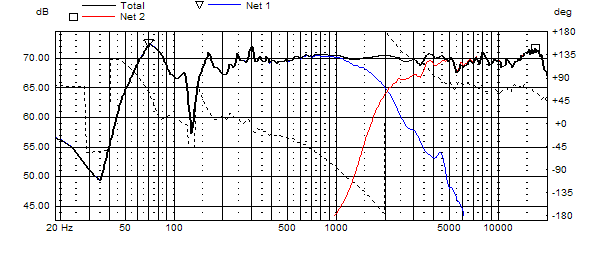

I think it comes down to total system Q. A reflex ported enclosure will have resonant reproduction to varying degrees.
Now an aperiodically damped line properly built can and does give broad system support without the reproduction being resonant as long as driver selection is optimal.
I have never built a mass loaded TL, but I have to say I'm suspicious of them. The impedance curves of the two approaches are quite different. The mass loaded TL has an impedance curve that looks like a ported reflex enclosure, so I suspect that they are resonant to a degree, but likely more damped than a standard reflex alignment.
I have to say that a traditional reverse tapered aperiodically damped TL, correctly aligned does not lack bass authority, far from it. The quality of the bass however is very different from ported designs. It is very different. It sounds sounds just like live.
Dennis Murphy
Well, I don't want to get off on another Is Too Is Not argument on the MLTL. I think all transmission lines harness the quarter wave for reinforcment, and to that degree are resonant systems. But I'm not sure what people heard at Denver was due to the difference between a TL (of any kind) and bass reflex. The SVS has its woofers mounted at the very bottom of the cabinet next to the floor. That placement avoids the ubiquitous floor bounce dip that you get with any woofer(s) mounted further up near the other drivers. When the woofer is in its standard position, its output around 150 Hz will bounce off of the floor and return out of phase, causing a dip in the output. Although it's controversial how audible this is, and its audibility depends on listening distance, the absence of any dip (because the distance to the floor is too short to cause a problematic out-of-phase cancellation) could account for the "richness" of the SVS. I don't usually like a bottom-mounted woofer because the crossover point to the mid is usually high enough to complicate integration if the drivers are that far apart, and the bass might also be too heavy. But the SVS is (somehow) crossed very low, and that mitigates the problem. I've attached a plot of a tower speaker with the typical floor bounce dip. SNAG-081.png
Well, I don't want to get off on another Is Too Is Not argument on the MLTL. I think all transmission lines harness the quarter wave for reinforcment, and to that degree are resonant systems. But I'm not sure what people heard at Denver was due to the difference between a TL (of any kind) and bass reflex. The SVS has its woofers mounted at the very bottom of the cabinet next to the floor. That placement avoids the ubiquitous floor bounce dip that you get with any woofer(s) mounted further up near the other drivers. When the woofer is in its standard position, its output around 150 Hz will bounce off of the floor and return out of phase, causing a dip in the output. Although it's controversial how audible this is, and its audibility depends on listening distance, the absence of any dip (because the distance to the floor is too short to cause a problematic out-of-phase cancellation) could account for the "richness" of the SVS. I don't usually like a bottom-mounted woofer because the crossover point to the mid is usually high enough to complicate integration if the drivers are that far apart, and the bass might also be too heavy. But the SVS is (somehow) crossed very low, and that mitigates the problem. I've attached a plot of a tower speaker with the typical floor bounce dip. View attachment 11516
Yes, the dreaded floor bounce. There are just a far too many ways to color a speaker.
I suspect the SVS is colored though. Too many listeners are just used to and possibly addicted to that type of bass coloration. I find visitors here have to adjust to its absence. To convince I play a piece where the cellos and double basses are bowed in unison repeatedly. It's really telling. The typms also help convince.
I place my woofers as low as I could and did not cross the mids at the lower end, I used acoustic roll of with the lines tuned a half octave apart, a trick of the late John Wright.
The upper woofer also has fed to its amp the signal for BSC and everything required for optimal integration. The two woofers have different amps. It works very well, probably not a commercial winner though.
The only mass loaded TL I got involved with was the JW Jupiter, which had the line loaded with a cavity tuned with an ABR. Not a great success I thought, as the range of reinforcement was narrow, so you had the kick in effect.
