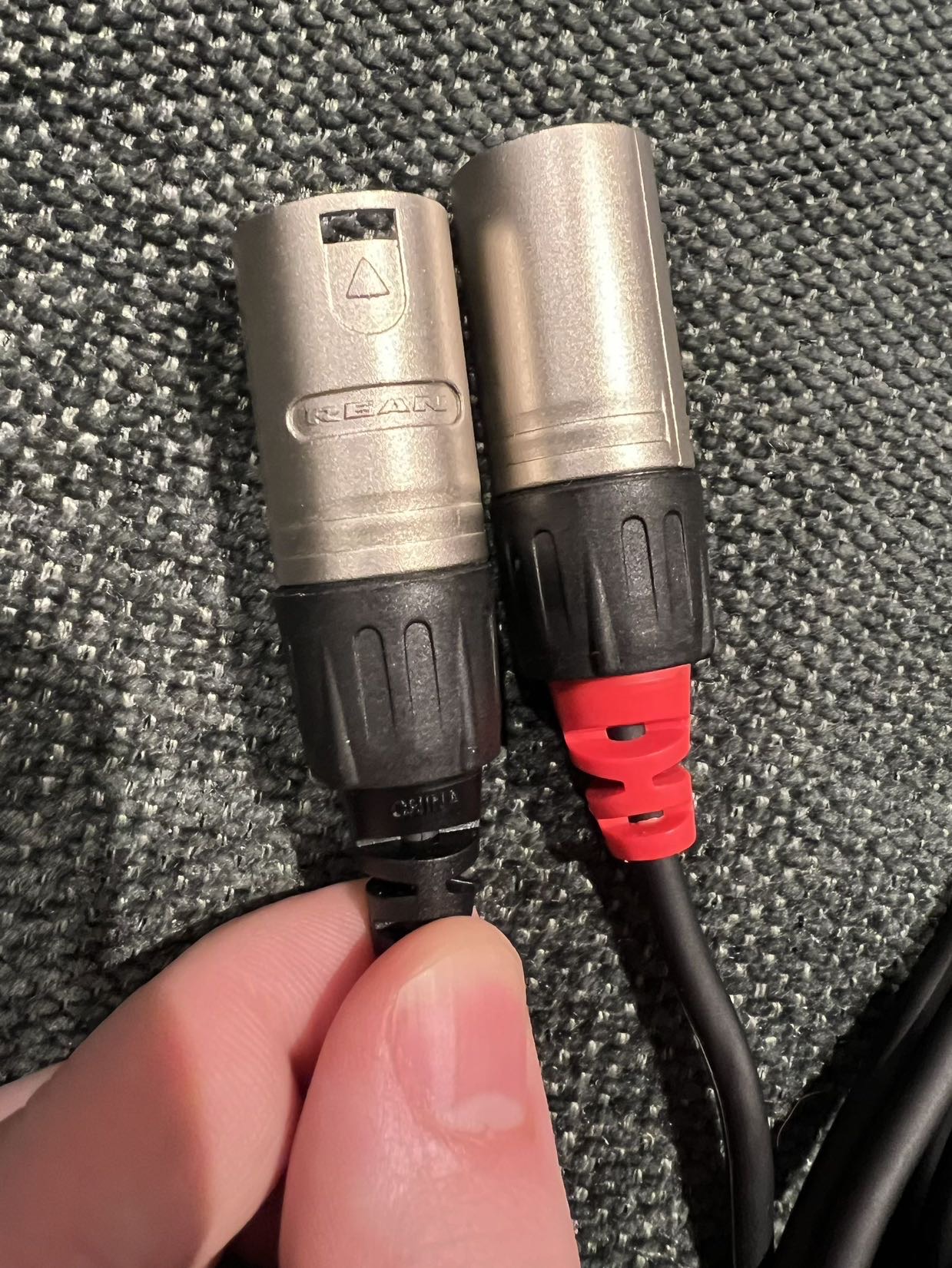

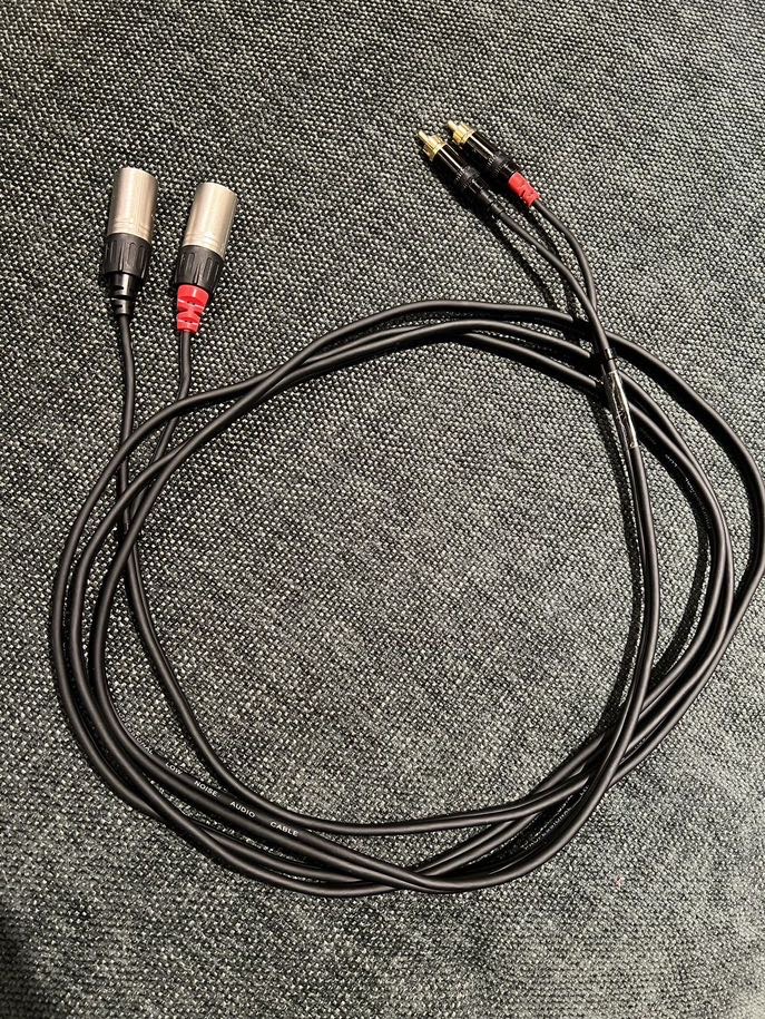

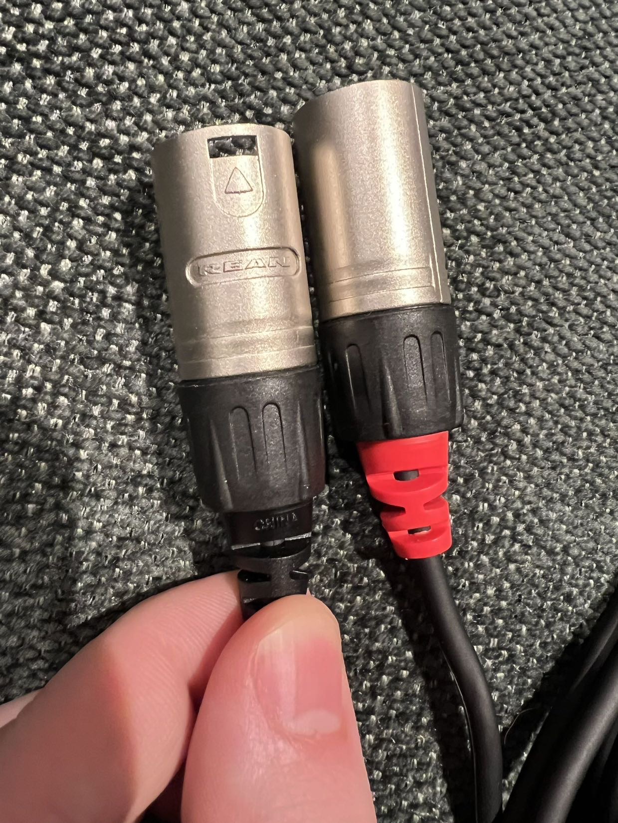

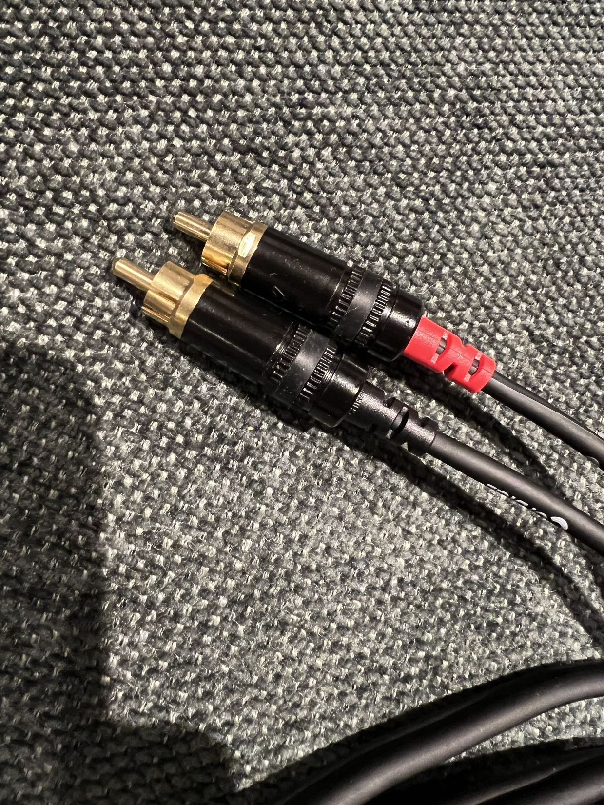

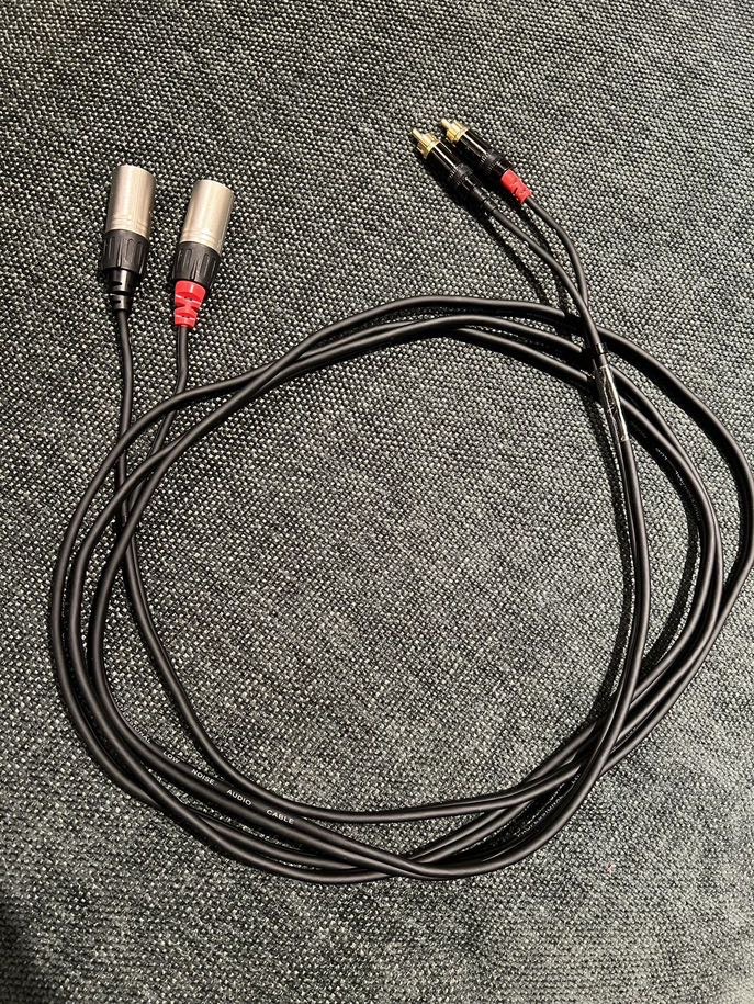

Hmm, I think the cables seem fine, obviously not at the same level of some of the more expensive brands you have listed (like Benchmark and March Audio):
View attachment 65110View attachment 65111View attachment 65112
There's nothing wrong with that brand of plug- they're a common brand, sold widely. Even no-name plugs can be about equal to the well known versions. I can see 'Professional Low Noise Audio Cable' in one of the photos, but no brand- do they show anything?
